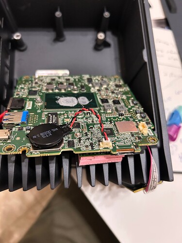

You may have to remove more parts (the disk maybe) to see more of the mainboard. It usually is a button battery but I don’t know the innards of a Nucleus.
Hi, I had to take apart a fair bit of kit because the battery is on the underside of the motherboard, but once i get there the battery is not a typical button battery c2032, but it’s encased in some sort of rubber and connected with wires. Any other thoughts?
Use Google to search for the text on the battery? It’s not magic after all (CR2032 battery two wires and a connector). Maybe another user or Roon Labs can point you straight at a suitable offering or a local shop can help you.
CR2023 is widely available, and top branded batteries of this type last much longer than cheap alternatives.
