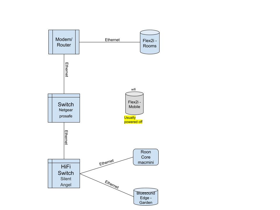

@conor Thanks for the details, pls see the attached image, this is my set up - its been like that for years, without any issue. All Blueshound devices just recieved an update (BlueOS 4.14.12) and the situation seemed a bit more stable, but I did experience a drop out today 25 march around 10:00 CET, and again around 11:10 CET maybe you can check the cause.
(in the second case the wifi bluesound was not even turned on)

So lets say the wifi device is causing the problem, I have turned it off, I still got drop outs, I would like you to check the reason for it, I had one around on March 26, somewhere between 9:30 CET to 11:30, there was a drop out when the wifi device was not on. Could you pls check the reason. in addition, I would like to mention that I have been using this set-up (only wired devices) for 5-6 years and it was flowless, so what has been changed? the answer might be in the drop out of the March 26, somewhere between 9:30 CET to 11:30. can we pls investigate that? thx
p.s. flex 2i ‘rooms’ is not connected to the silent angel switch, but directly to the router- see drawing
