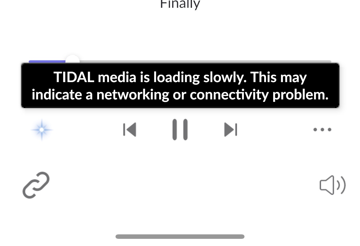

Diagnostics from the last few days show that the Pulse 2i listed under the Zone name [ Zone: FLEX 2i- Rooms ] continues to be the problematic endpoint. That particular IP address is logging packet loss when Roon attempts to stream high-resolution audio via RAAT, which is uncompressed.

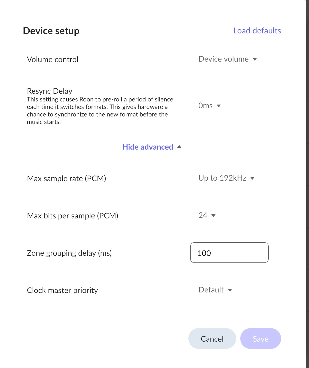

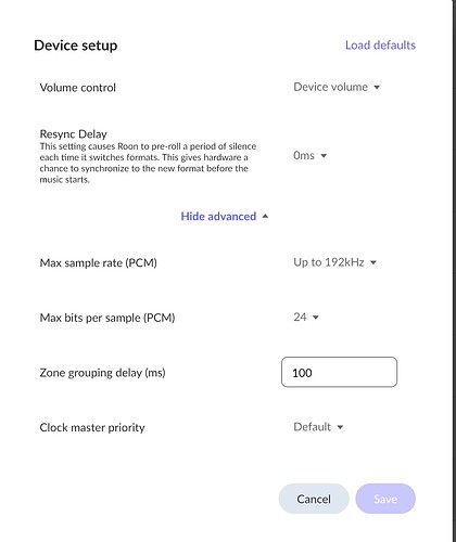

1. Disable Sample Rate Conversion first. Go to each zone’s device setup and check the DSP/Muse settings. Your logs show Roon upsampling all the audio to 24/192 before sending. When zones are grouped, that multiplies the data load on your network exponentially, which might be causing sufficient congestion to break the Bluesound Pulse’s buffer. Set Sample Rate Conversion to “Disabled” for all zones, then group them and test. When you create the Group, add the Bluesound Pulse 2i units last.
