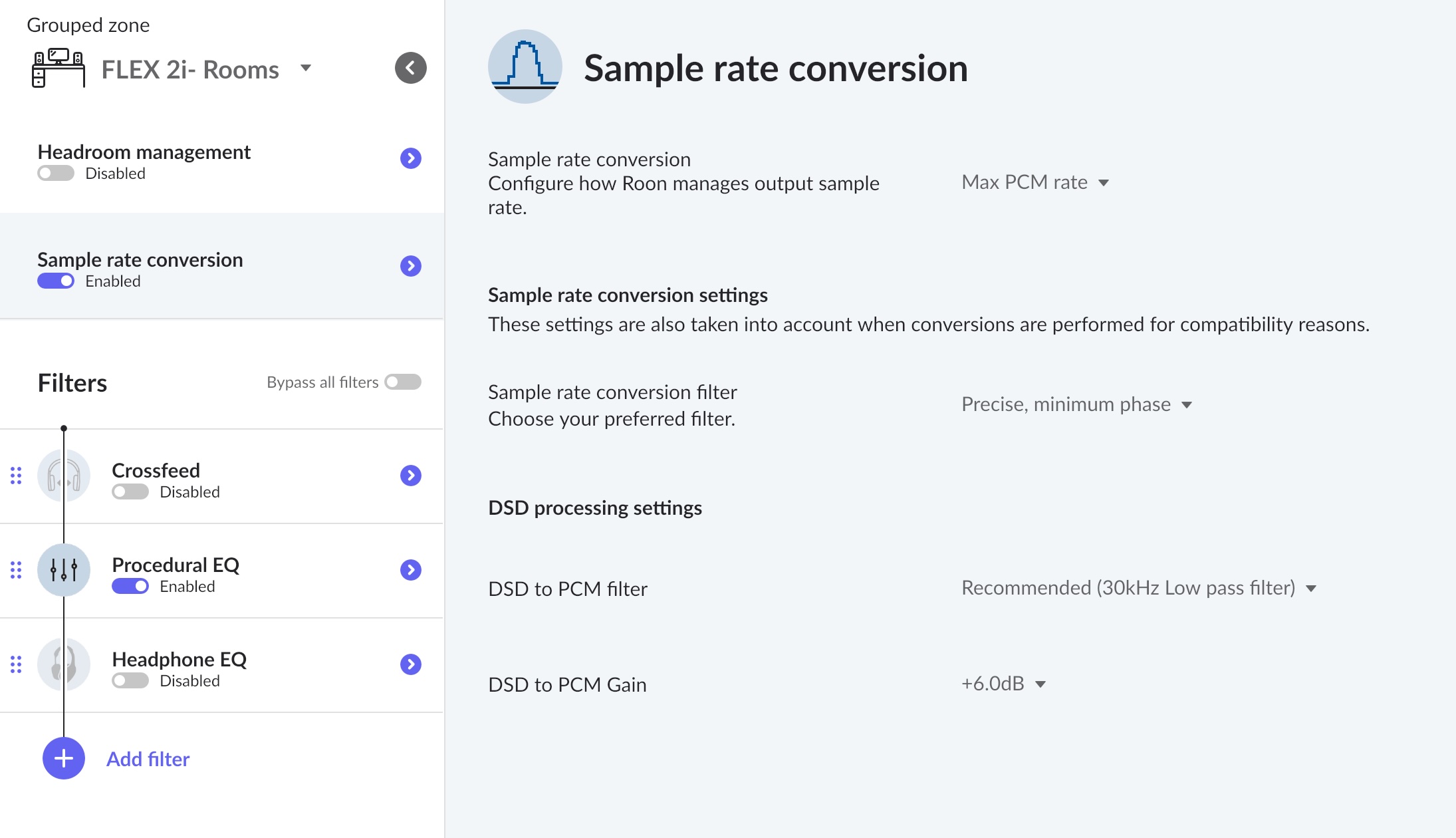

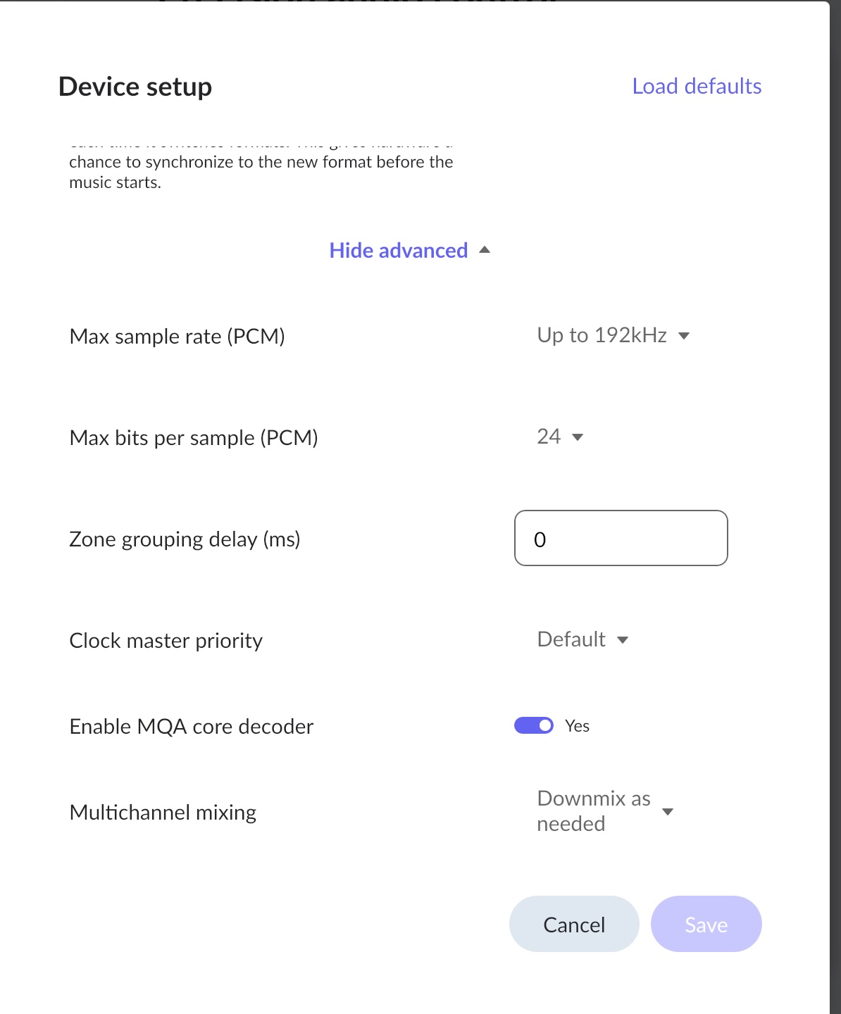

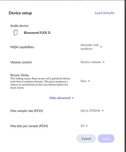

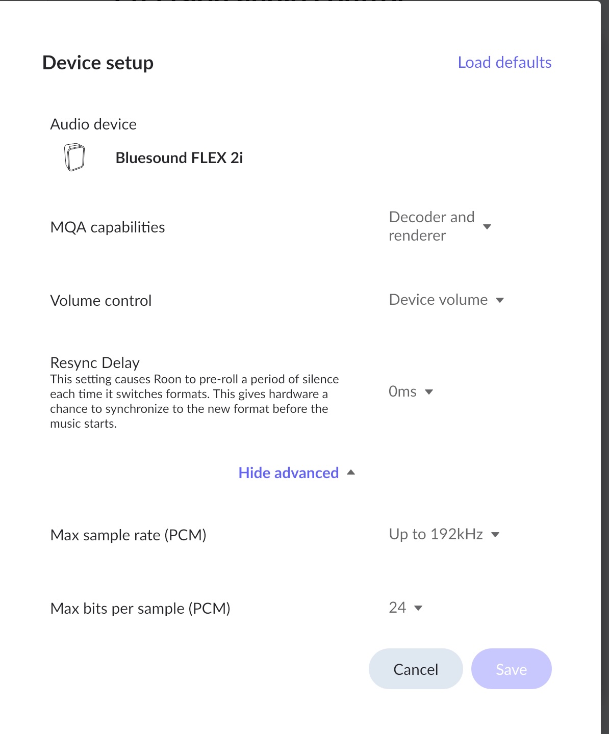

  1. Open Settings → Audio → FLEX 2i- Rooms → DSP and send me a screenshot. Also check Device Setup → Max Sample Rate and clear it if it’s set to 192 kHz. Same for Garden.

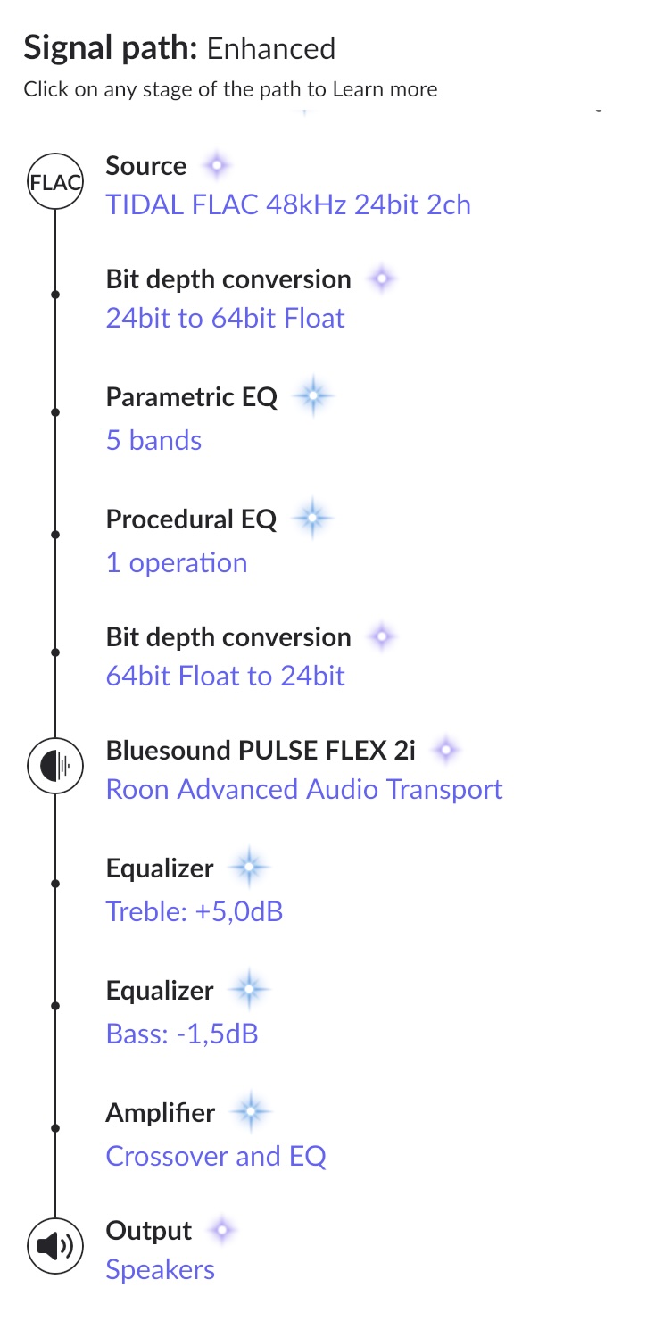

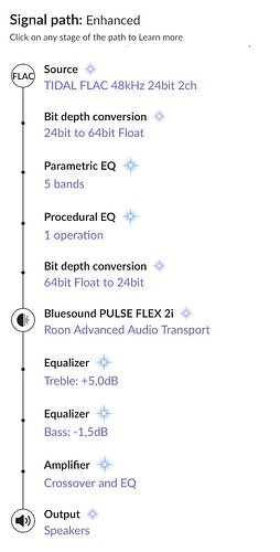

  2. Start a track and screenshot the signal path, it should read 16/44 straight through, with no conversion.

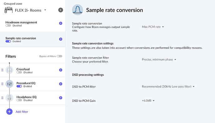

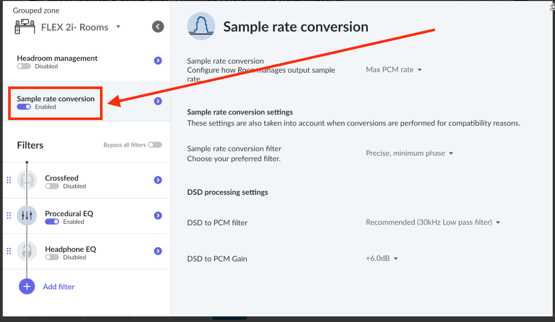

Hi @benjamin pls see the screen shots of the current flex2i setting, I am not sure what you want me to change so pls advise.
Hey @Tamir_Dotan,
Thanks for the screenshots! Simply disable / toggle the ‘Sample Rate Conversion’ DSP setting currently enabled:

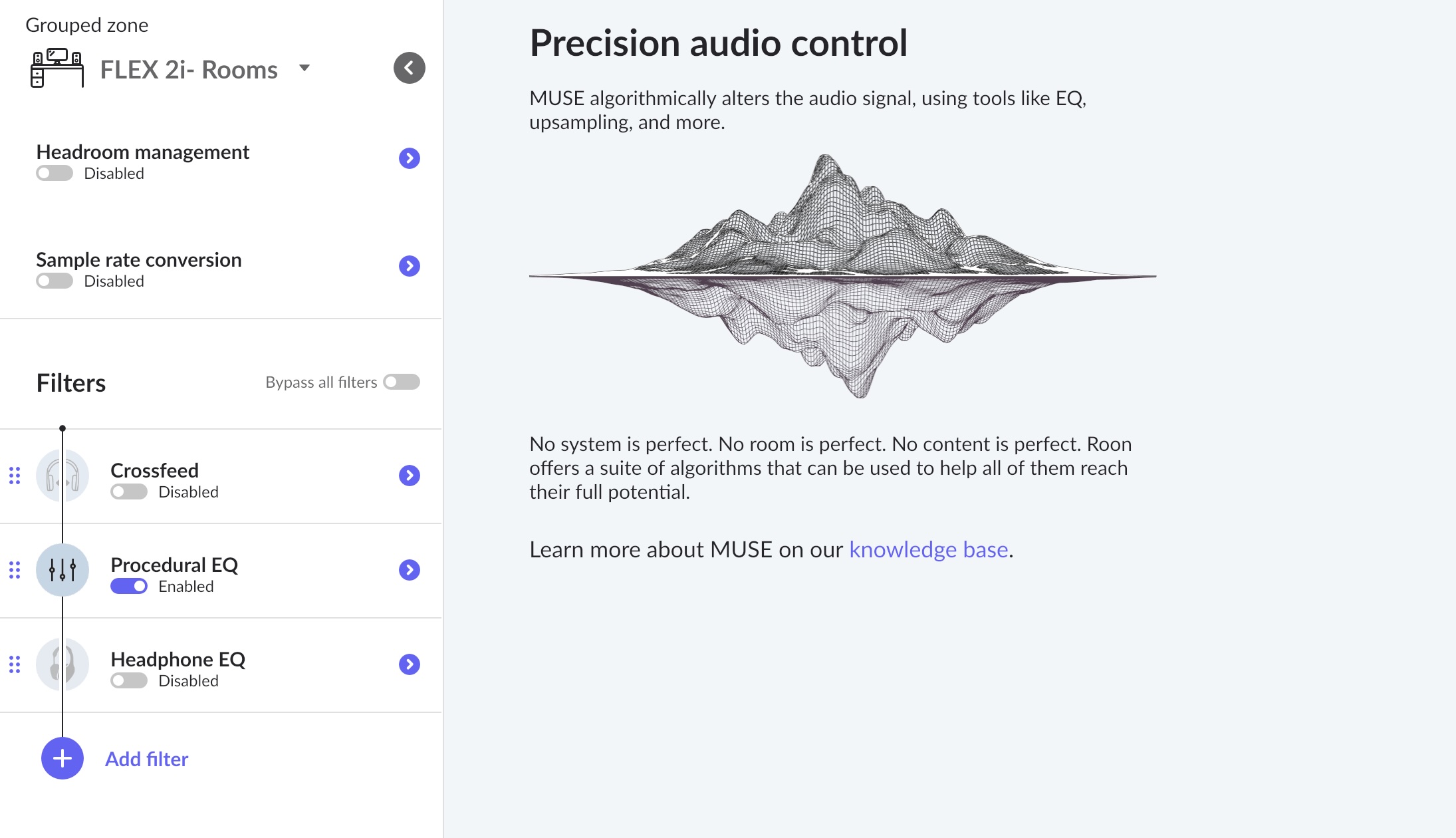

Hi @benjamin pls see attached requested screen shots
I am not sure if this is the results you wanted?
Hi @Tamir_Dotan,
Thanks for the screenshots, those are exactly what we needed, and the news is good: Sample Rate Conversion is off. Nice work! That was the change that mattered, and it’s now confirmed in place rather than just assumed.

One last thing worth checking: the DSP panel you sent is the grouped zone view, and it lists Crossfeed, Procedural EQ, and Headphone EQ. But your signal path also shows a 5-band Parametric EQ, which isn’t in that list, meaning it’s almost certainly set on the FLEX 2i-Rooms zone individually. That’s fine and you don’t need to change it, but it’s the same kind of hidden per-zone setting that caused the June Sample Rate Conversion test to look done when it wasn’t. Worth knowing it’s there.
