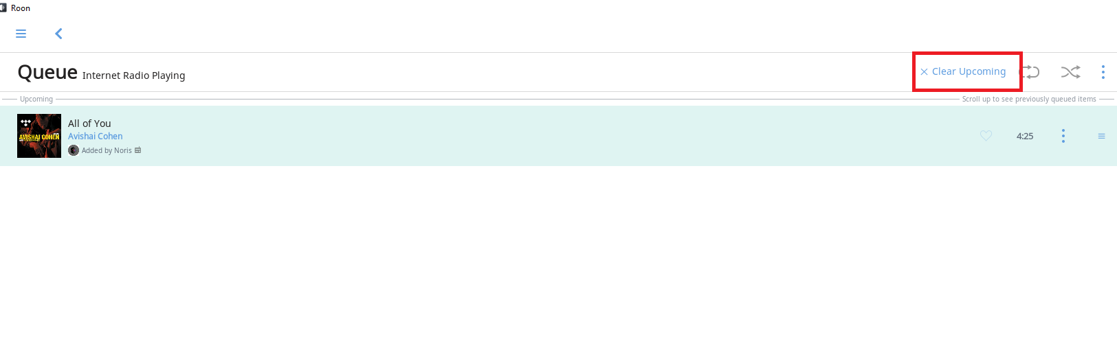

Hi @Ian_Drachman,
Thanks for letting me know those timestamps. Hmm, I am seeing an issue that indicates too many items have been added to the BDP play queue. Can you please try clearing out your play queue by pressing this button twice (Clear Upcoming -> Clear All) and let me know if that changes anything?

Since clearing the queue, the issue has not reoccurred. What happened and how/ what needs to be done to permanently fix?
