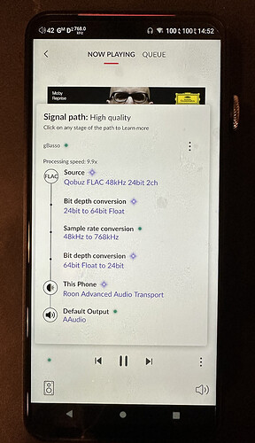

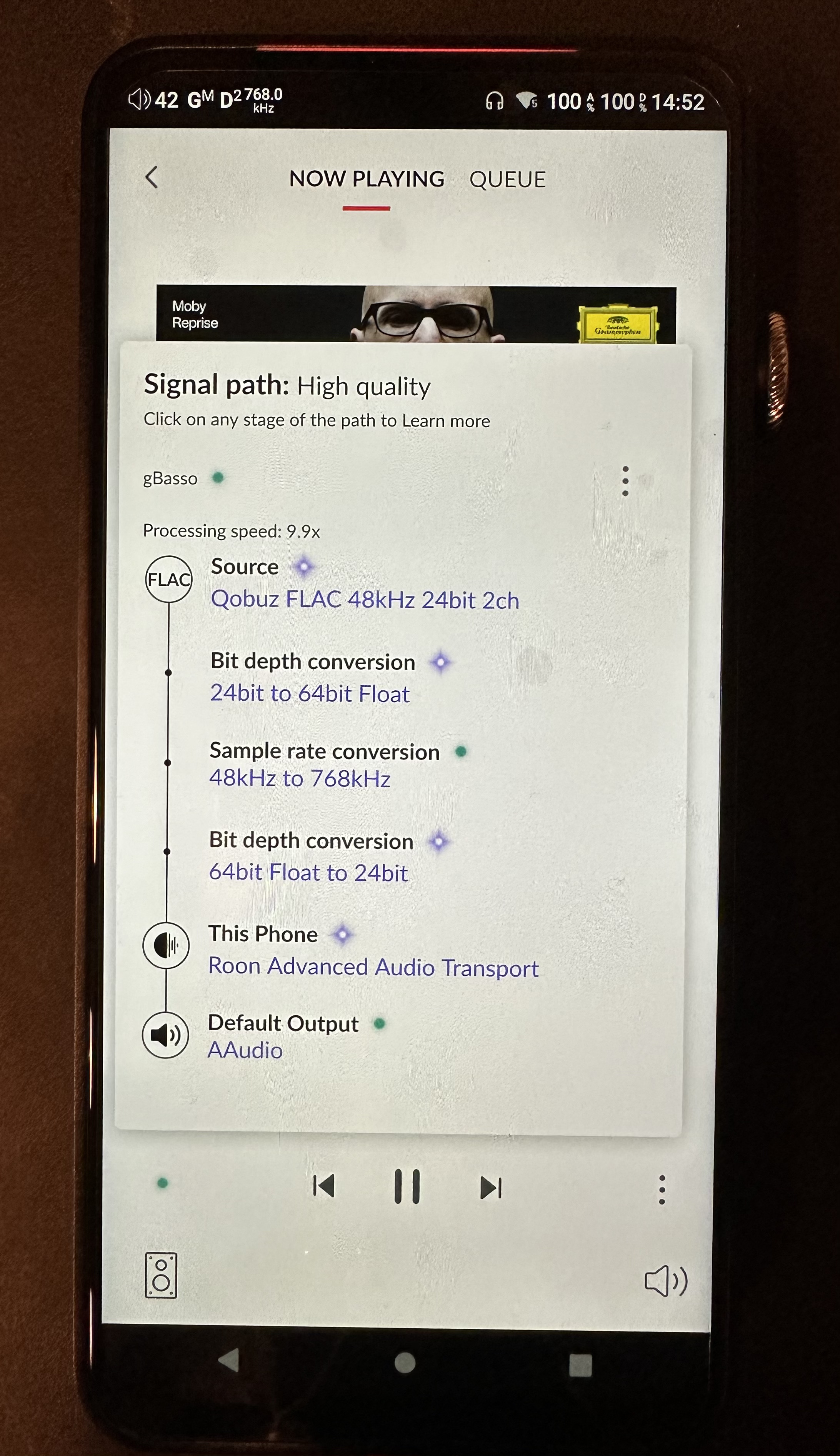

Can one of you with more experience with DAPs help me understand if the signal path shown below is what I should be seeing?
I had some initial funky behavior but firmware updates and a reboot seems to have led the device to stabilize at this sort of signal path in both Roon Remote and ARC.
Everything is upsampled to 768/24.
There are no DSP settings enabled.
Is this Roon upsampling to avoid allowing AAudio to do it?
This device has a bit of a learning curve - a chunk of that is me not having used Android for a few years. I’m trying to come to any conclusions until I have it dialed in.
You get a better sample rate than I do. But otherwise my path looks identical.
It is doing those conversions to play at a bit depth and sample rate your DAP/underlying OS can understand.
My hope is, Roon will eventually get their software to pass native rates to our systems. That will require a deep dive into how android passes everything in and out. Doable, but usually with a larger development team.
Thanks. There’s more going on here and I think there’s a bug. At least with the iBasso DAP I’m using.
Here’s what I see.
Test 1. Restart. Run Roon Remote. Play a 44/16 track. Track is converted to 768/24 by the core, sent via RAAT, pushed to AAudio in 768/24.
Test 2. Restart. Run Qobuz. Play a 44/16 track. Track plays in 44/16 as expected. Pause playback. Switch to Roon Remote. Play a 44/16 track. No conversion on the core. Track is sent at 44/16 via RAAT and sent to AAudio in 44/16.
Test 3. Restart. Run Qobuz. Play a 44/24 track. Track plays in 44/24 as expected. Pause playback. Switch to Roon Remote. Play a 44/16 track. Track plays in 44/16. Play a 44/24 track. Track plays in 44/24.
Test 4. Restart. Run Qobuz. Play a 44/16 track. Track plays in 44/16 as expected. Pause Playback. Switch to Roon Remote. Play a 96/24 track. Track is converted down to 44/24.
ARC obviously moves all conversion to the device but the behaviors are all effectively the same.
It looks to me that Roon Remote is not correctly determining the sample frequencies supported by the device. After a reboot, and if the only clients you use are Roon clients, everything is going to play at 768 in my case and possibly the highest supported frequency in your case. But if a better-behaving client, like Qobuz, plays something, that results in Roon thinking that the only(?) supported frequency is whatever the previous client played at. And Roon will up or down sample to that.
I hope they can fix this. I’ll report it as a bug but probably not today.
I believe what is happening (totally a guess) is that Roon is querying the DAC for its bit-depth. Using Qobuz, which understands how to change the bit-depth, changes the DAC to the appropriate bit-rate and Roon then sees that as what to use (sort of).
IMO, the biggest issue is Roon not telling the DAC what to use based on the track, but instead upsampling/downsampling to whatever the DAC is currently reporting.
I think that’s pretty much what I said :slight_smile:
Do you see the same behavior on your DX300? I’m curious if the behavior is specific to the ROHM DAC I the DX320.
Standard for some DAPs but it’s dependant on how they tweak the Android OS to get the bypass from system resampling. The DAC is being left in a certain state by other apps. As Roon currently doesn’t change the freq for Android it will get what the last freq was from the os and assumes this is the fixed rate it works at and will resample to this. It will vary according to whatever rate it gets back from Android which in itself seems to vary on certain DAPs dependant on what app was used prior and what rate it’s been left in. Other daps like my hiby are always 44.1 regardless, some Fiios seem to vary all the time. Same will occur on ARC until they sort this out for inbuilt DACS. Don’t expect Roon app to ever work as they don’t seem to be focused on getting Android Audio working but perfect on anything other than ARC.
Thanks for the explanation. I gather this means that I’m, as they say, pounding sand if I post a bug report but that’s probably not going to slow me down.
I prefer using Roon Remote to ARQ on my local network. I like features like DSP and direct access to Tidal and Qobuz. The issue I’m hitting is that when the core samples up to 768 and then tries to stream via RAAT, it’s never stable. I don’t need this explained - the nature of RAAT and the increased size of the bitstream isn’t reliable.
So what I’m finding myself doing is flipping to Qobuz, using some track there to get the DAC at some other frequency like 44 or 96 and then flipping back to Roon.
I think I’m just going to make a few short tracks at various frequencies and then throw them directly onto the DAP. Then I can just pop into iBasso’s player (Mango) and use them to manually set the freq. It’s not perfect but at least it’s a workaround.
Thanks again for the clarification. It’s clear that Roon folks can fix this if they want - hopefully they can look at it when the dust settles on some of the near-term higher priority stuff.
I made a collection of 1-second flac files at frequencies ranging from 44.1kHz to 384kHz. I threw them onto my DAP. This all works as expected now - I can play them in the DAP’s native player (Mango Player in the case of iBasso) and anything subsequently played in Roon Remote or Roon ARC plays at that frequency.
If anyone wants to play with these, I can DM you a link to grab them from a Google Drive.
