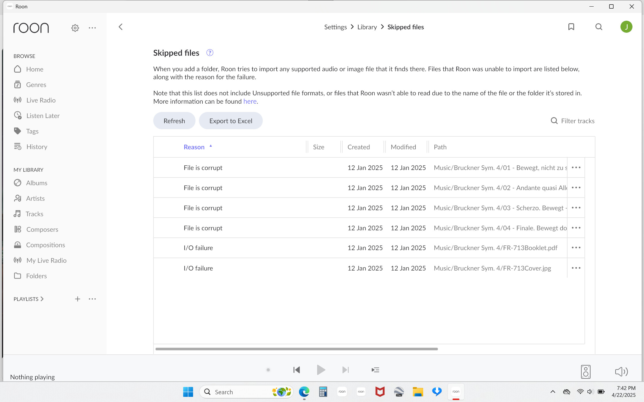

I tried to delete my skipped files. Some of them disappeared but I still have these left.

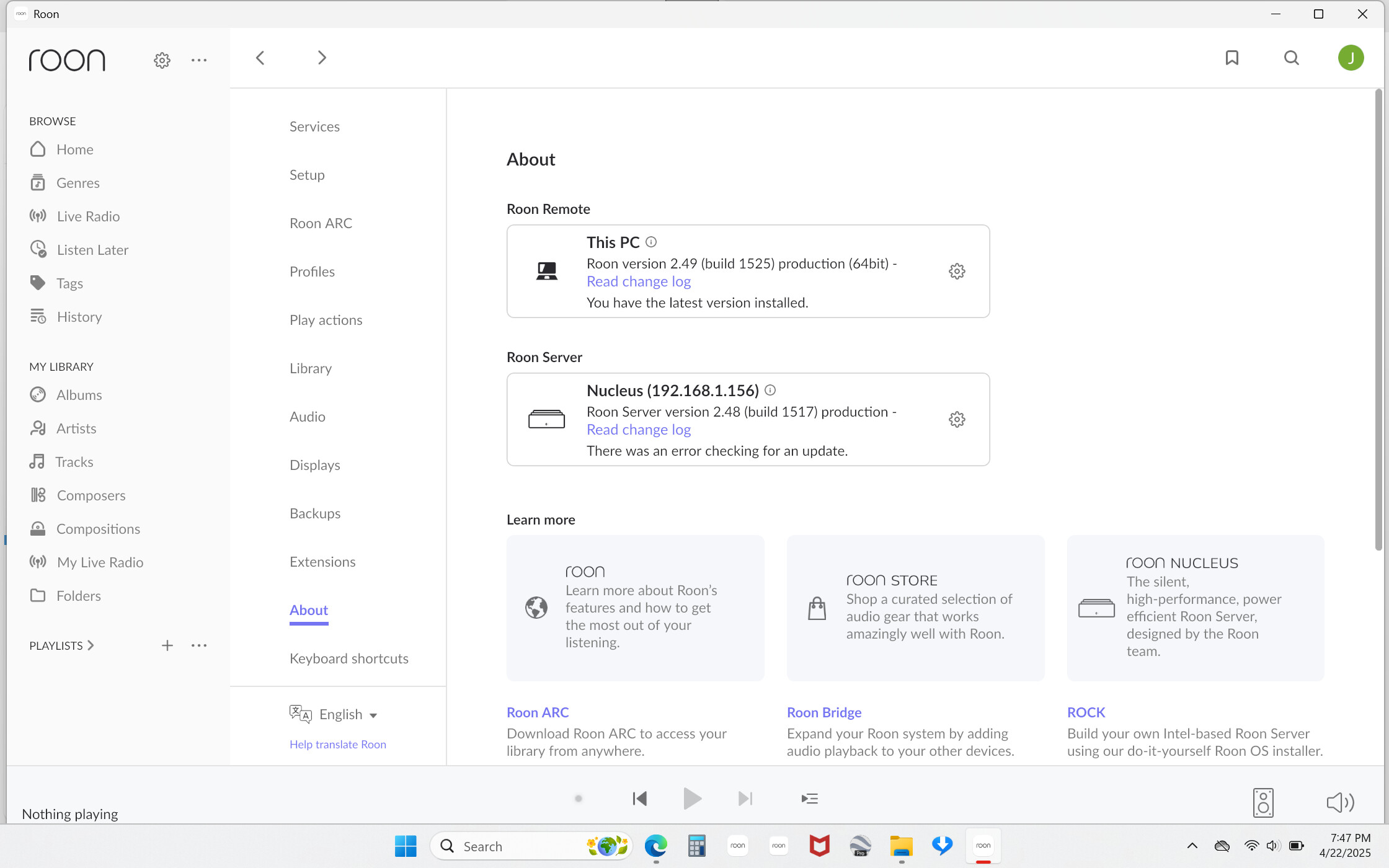

I am also still getting this error when I click about.

Hi @John_Pluta,
If you’re having issues updating your Nucleus - you can access the webUI of the Nucleus via a web browser and perform an OS reinstall that will install the latest version. Here’s more info on how to access the webUI:

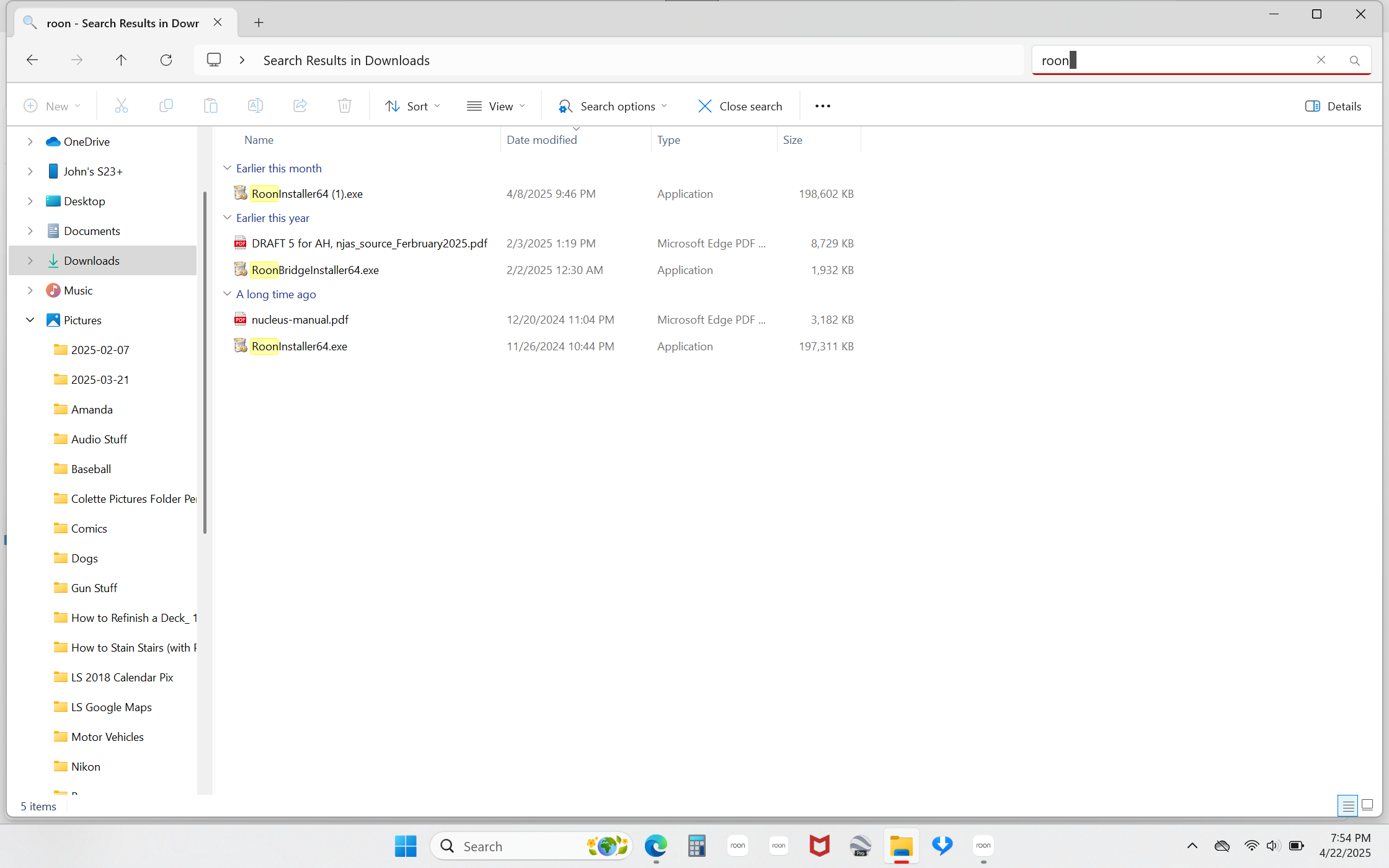

I downloaded to Nucleus and the PC and Nucleus are up to date. The skipped files still show 6 tracks from the Bruckner 4th.

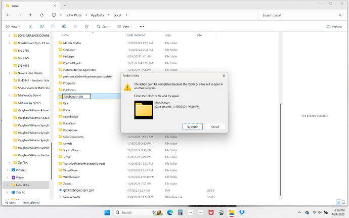

I wasn’t in Roon or in the Internal Storage folder. When I tried to change the name of the RAAT Server folder this is the screen I got. It would not let me change it.
Hi @John_Pluta,
You can always confirm Roon isn’t running via your windows Task Manager:
  • Press Ctrl + Shift + Esc to open Task Manager.
  • Look for Roon.exe and RAATServer.exe under the Processes tab.
  • If either is still running, right-click and select End Task.
See if this helps :slightly_smiling_face:

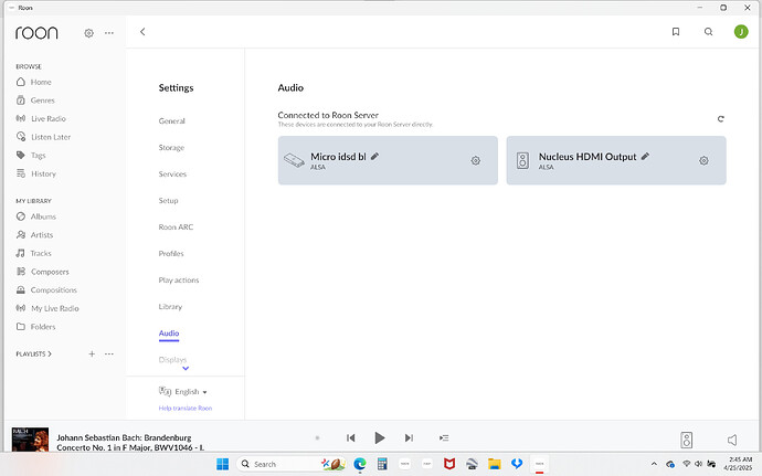

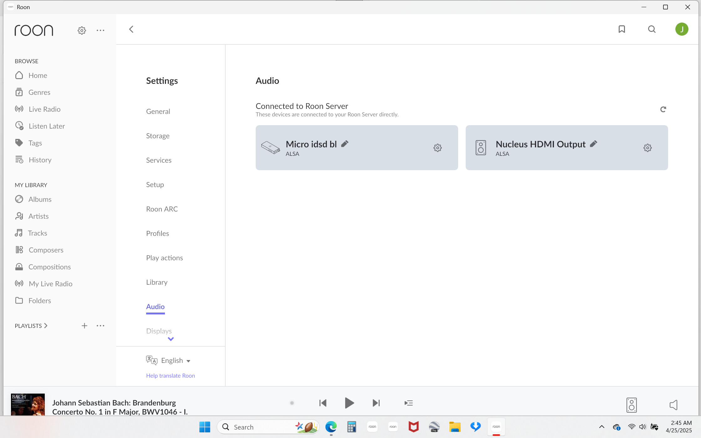

Things are ramping up now for the worst. First every time I try to right click on RAAT Server or use Task Manager to end the command it just pops up again showing that it is running! \Now the audio is screwed up, here is the screen.
Hardly surprising - if you have Roon running, that will start RaatServer as well. So close Roon and end Raatserver in Task Manager, if it is still running after Roon is closed.

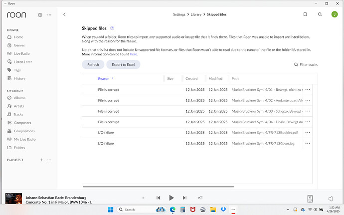

We might be getting somewhere, Carl. I moved the files enquestioned. I had to look up how to cut, pick a folder then paste it. Still have a question. They are no longer in my internal storage folder. So I open Roon and go to Settings, next the library and the skipped files line, there are the same 31 or so files still there. So I clicked the 3 dots all the way to the right. A message came up with something about the same folder. So I clicked on that message and about 24 files disappeared but these 7 are still there. Here is the screenshot.

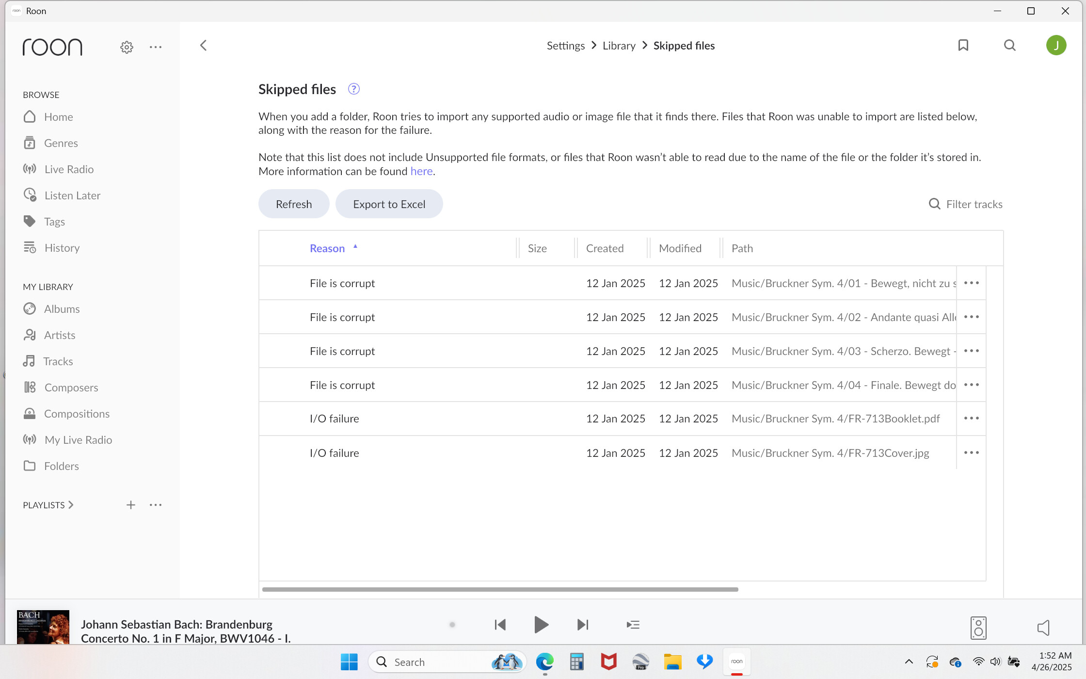

I followed up with Carl’s directions and the files that I moved yesterday no longer show up in my internal storage file. Before typing this I checked my Library skipped files on Roon and yup there are about 30 some listed files there still. Now about that music I moved, could I ever add it back to my Nucleus again? So I guess I won’t be able to play that Tchaikovsky 4 cut on Nucleus ever again? Do I have to go back in ancient history and delete everything on my laptop? Because when I type in Roon on my laptop in Windows Explorer with doubled files I have about 224 listings. So I still need some help. See you next week after this weekend 04/26.

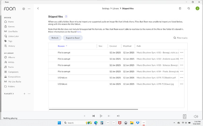

I don’t know how to show them all because of the numbers but here is a screen shot.
Also what is my watched folder? is that the same as my internal storage? I do appreciate everyone’s help, too bad I’m such a poor student. BTW, I just did an update on my nucleus UI. When I then went to the cleanup library for the 1st time instead of bringing up the box with 3 lines of file information. All 3 almost always 0 in each one. Today for the 1st time it showed 58 files and I hit yes to continue cleaning. But when I went back into the skipped files choice in the library they were all there again. Also all the skipped files show the same date 12 Jan 2025, is there something we could do by date?

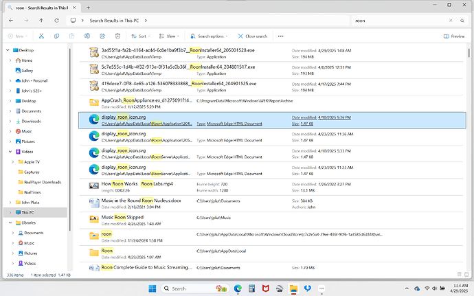

Well something interesting just happened. I noticed in my Internal storage there was a file labeled Music with all the selections that were in my internal storage too. I took a shot and deleted that folder labeled music. Then I went back into Roon, then to the library and clicked on the skipped files…they were all gone!
