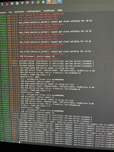

A bit of mystery, when it looks like playing, but no sound, does ā€œsudo dmesgā€ show anyting that could be related? Like USB errors?
Thank you Jussi! Lots of information here! This is
only the last page! What do you say?
Oh yes, looks like you have a USB problem. Perhaps try with another USB cable?
It is Holo Audio DAC? If yes, it has the blue USB 3 connector, please use USB SuperSpeed certified cable connected to USB3 port on the computer. If it something else and has only black USB 2 connector, please use USB HiSpeed certified cable.

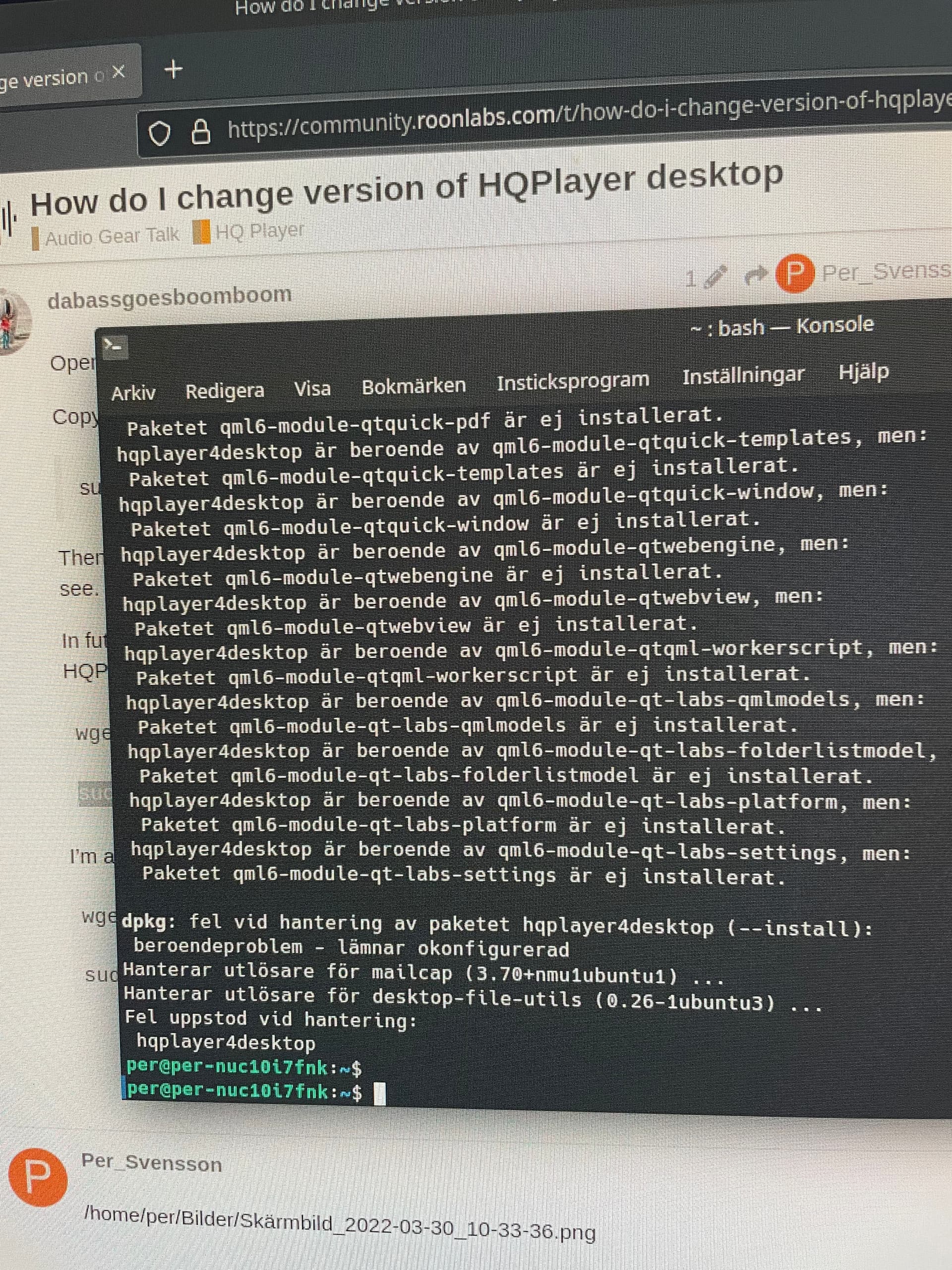

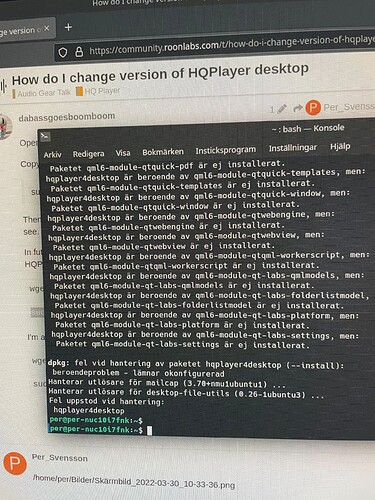

So I decided to reinstall Ubuntu Studio!
But now I cannot install HQplayer!
