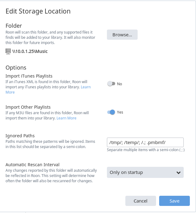

Can you share a screenshot of Settings > Storage in Roon? Additionally, can you select the storage location(s) here and choose Edit and then take a screenshot of the Edit Storage Location screen(s) as well?

Dylan,
Here are the shots you requested, basically the same as I posted yesterday.
