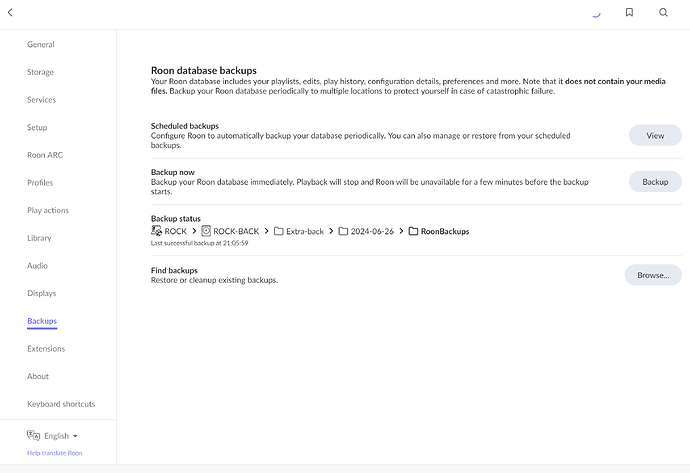

But – at the risk of repeating myself – backing up your Roon database using the Roon app is absolutely essential. If you don’t do it, you may never be able to re-create your Roon environment again should something happen.
Strongly suggest reading up on the specific Roon backup routines. Good luck.

Hi, some people edit their libraries extensively and in those cases it’s important to back up, if you are like I was and just let the music import then queued up albums and pressed play, you have nothing to back up, just reimport everything should you need to do so.
I think that the point of backing up the Roon database is that it changes - so after a while it is no longer as it was when you installed it. All the adjustments and corrections you made to your music collection, and all your playlists, queues, statistics, etc., are of course also updated.
All of that will be lost if the database is lost. A backup takes a few seconds or perhaps a few minutes and can be made fully automatically, or you can manually make one from time to time. Both approaches are supported by the Roon software itself, so it couldn’t be easier to arrange.

And backup needs in any case to be done while not playing music. Often it makes sense to just plug in a USB-drive and schedule a backup each night, then it will work completely automatically (and simply skip the backup on nights where you do hear music at the scheduled time).
