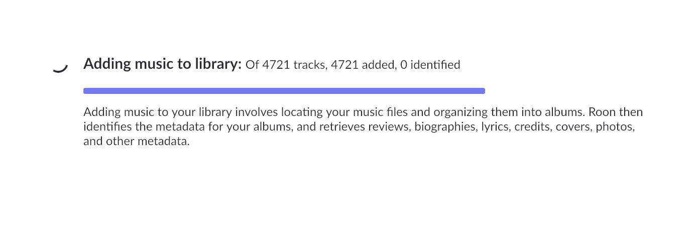

Roon server intermittently spins with stalled file scan every 30 seconds (ref#GPCKMY)
Waiting for your roon server spins every 30 second and file scan stalls
Running roon and playing directly on macbook via external hd
This has been going on for 48 straight hours. Restarted reconnected reinstalled, reduce to 1 core, turned of background analysis.

Backup made and logs uploaded.
Followed instructions, reinstalled, restored back up - same issues happening.
Adding music to library spins continually and doesn’t ever stop.

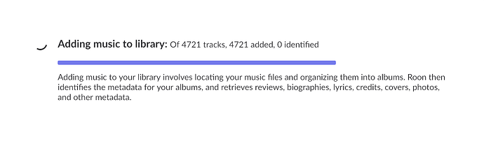

Thanks for giving the reinstall a try. Just to confirm here, if you restart your Roon Server, the same amount of tracks remain in the Adding Music to Library list, or does the amount change? I wonder if this issue could be related to reaching our identification servers?
We have seen users have a better experience in the past if they change their Router’s DNS servers from the ISP provided ones to Cloudflare DNS, Quad9 or Google DNS. Can you please give this a try and let us know if it helps?
The number of tracks does not change - it stays the same every time I launch Roon and it spins the entire time the core is open.

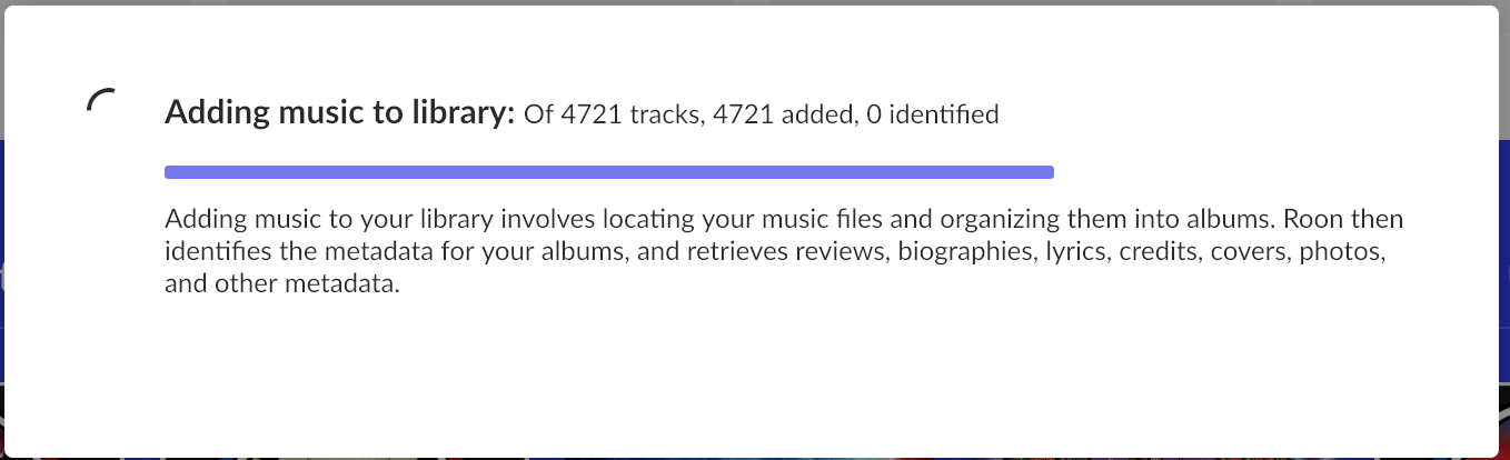

Trying to play some songs and use the search/filter function at the same time - spinning ball of death and Roon unresponsive - have to force quit.

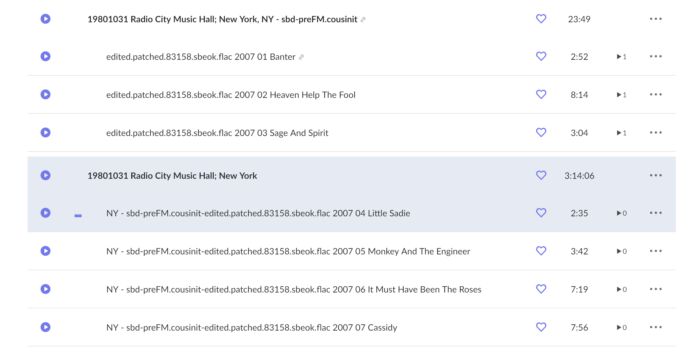

I had a previous ticket that was unresolved/closed about how Roon is breaking up songs from the same album.

Trace: [Broker:Media] [identification] <3076655> Identifying album [Grateful Dead - Grateful Dead Complete - Eddy] with 13943 tracks
It looks like you’ve grouped almost 14k tracks into a single album, which could absolutely confuse Roon and cause some issues.
If you remove this album temporarily (move it to a different location outside of your watched folder in Roon, then perform a library clean up to fully remove it from Roon) do you still run into issues with scanning?

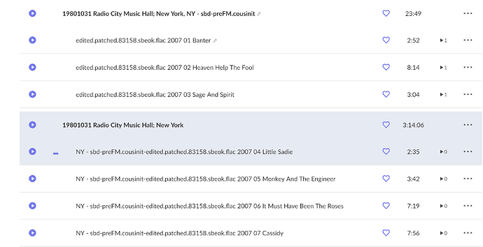

If you see my previous tickets, that is the nature of my library - huge collections of an entire artist’s work in a chronological collection.
I never had this issue with any other platform because the track titles all contain dates and numerical sequences. The tracks should order themselves 1-9 and a-z
