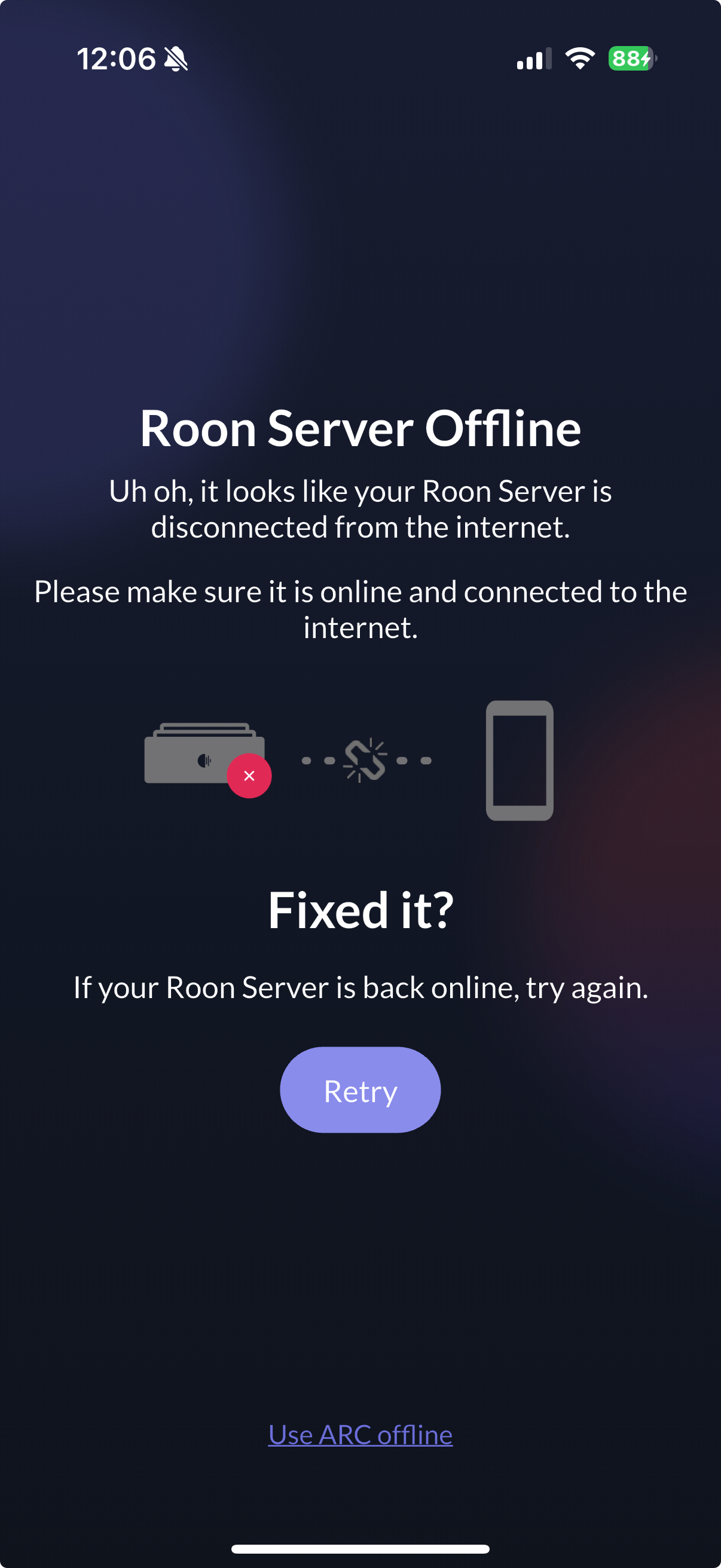

Roon Server offline or poor connection issue (ref#GFNXDN)
· I'm having trouble with my Nucleus hardware
Roon Server offline or has poor connection

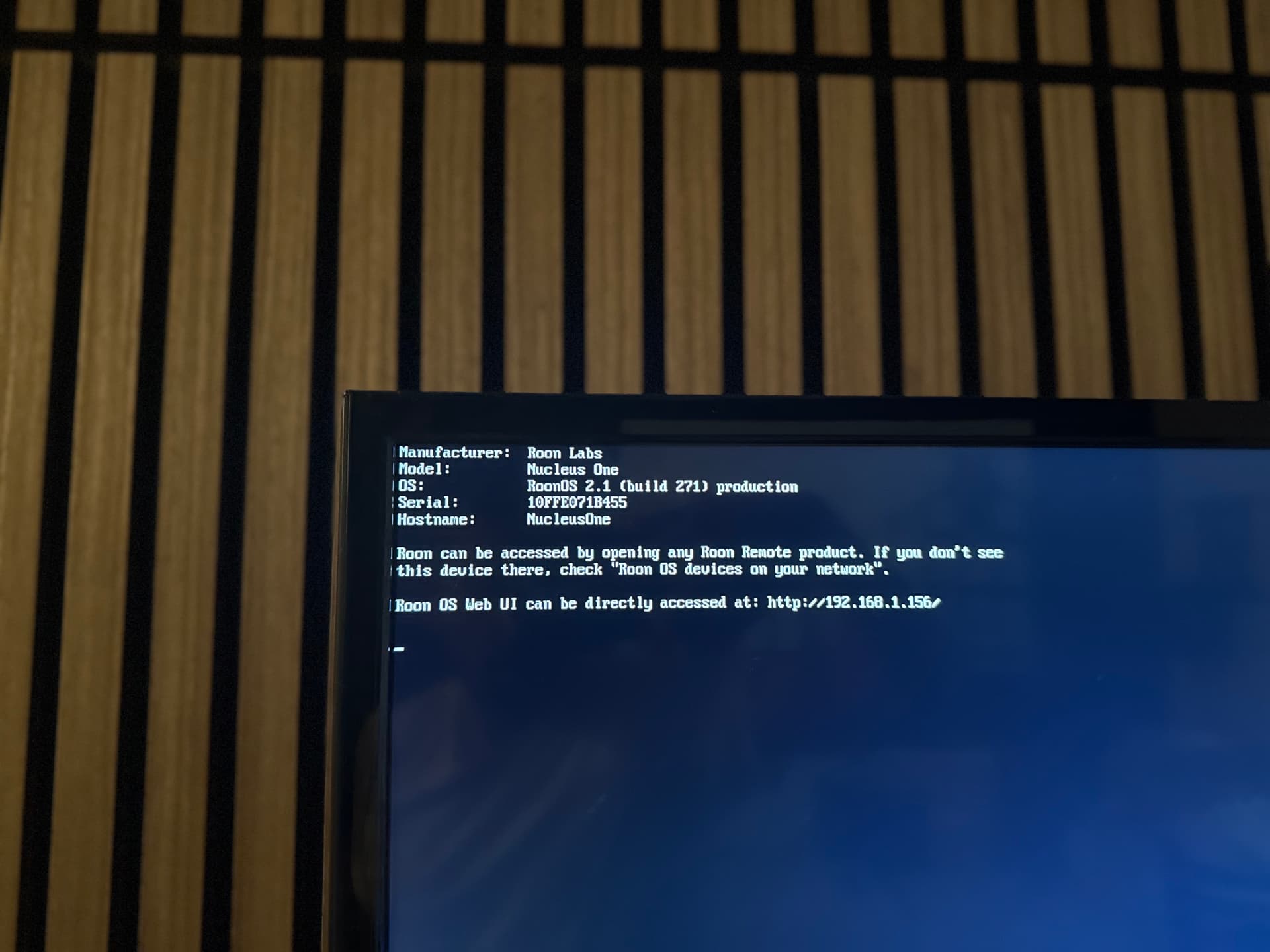

Thanks for reaching out to us to ask about this issue. Our system isn’t able to see your Nucleus which means it hasn’t been in contact for quite a while. This may indicate a hardware issue. Can you please connect your Nucleus to a computer monitor with an HDMI cord and share a picture of what shows up on screen here?
Here is a picture of my roon connected to a monitor via hdmi
Hi @arturoperrone,
Thanks for getting back to us with that screenshot — it’s a good sign. It shows that your Nucleus is receiving an IP address from your router, which means it’s connected to the network. However, it looks like your Nucleus is on a different subnet than your remote devices, and that’s likely what’s causing the issue.
