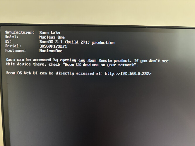

Here is what appears on the monitor if i connect it to the nucleus. I copied all the logs file to the folder you gave me. I tested the disk and it can be written to.

Thank you for the screenshot, it tells us where we are.
Your operating system reports OK, your database reports OK with plenty of space, and your internal music storage reports OK with 946 GB free. Your music and your library are intact.
Here is what has been happening. Since 7 August your Nucleus has downloaded the Roon update and begun installing it at least eight times, and each attempt has failed silently. It never reported an error to you and it never completed, so you stayed on the older version each time. One of those attempts has now left the Roon Server application unable to start at all, which is the error you are seeing.
