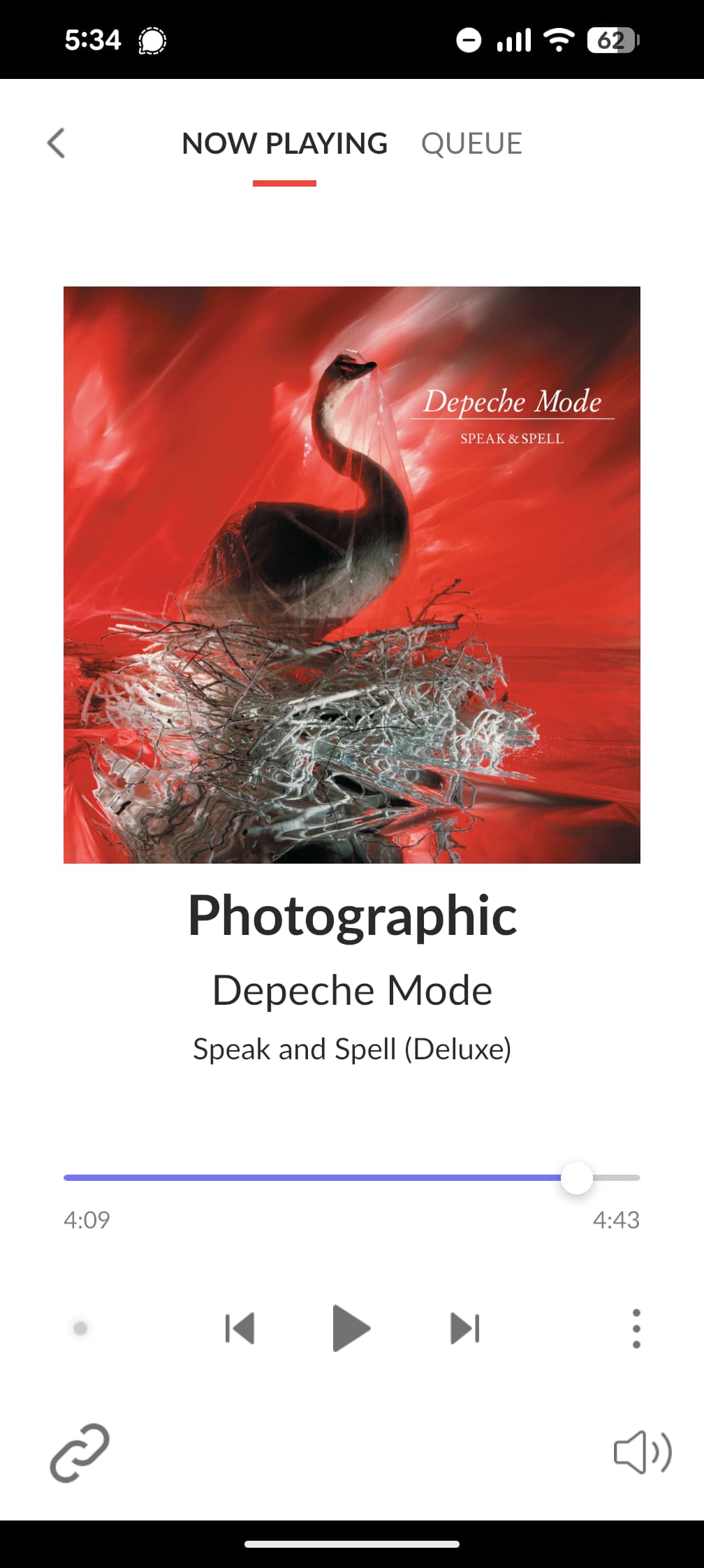

Here you go. This track was playing and roon randomly cut out at 5:33pm Pacific Time. Please tell me what you find.

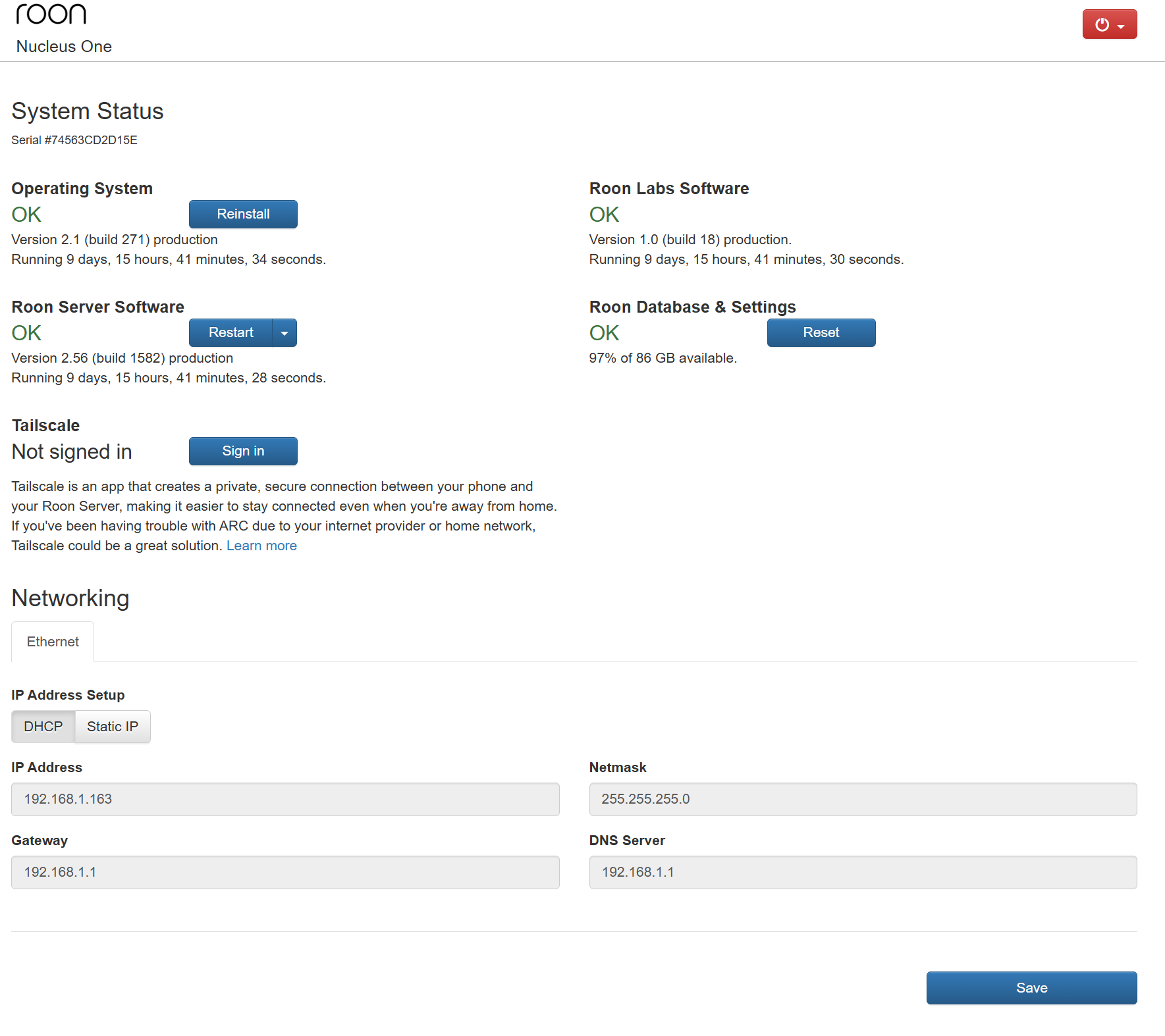

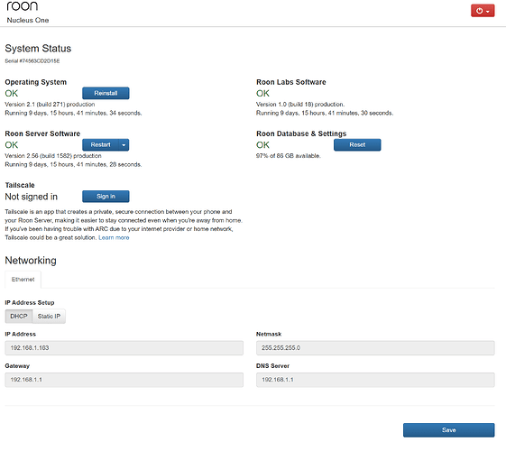

Here is additional information. This is a snapshot of what I see when I navigate to the IP address of my Nucleus One.
