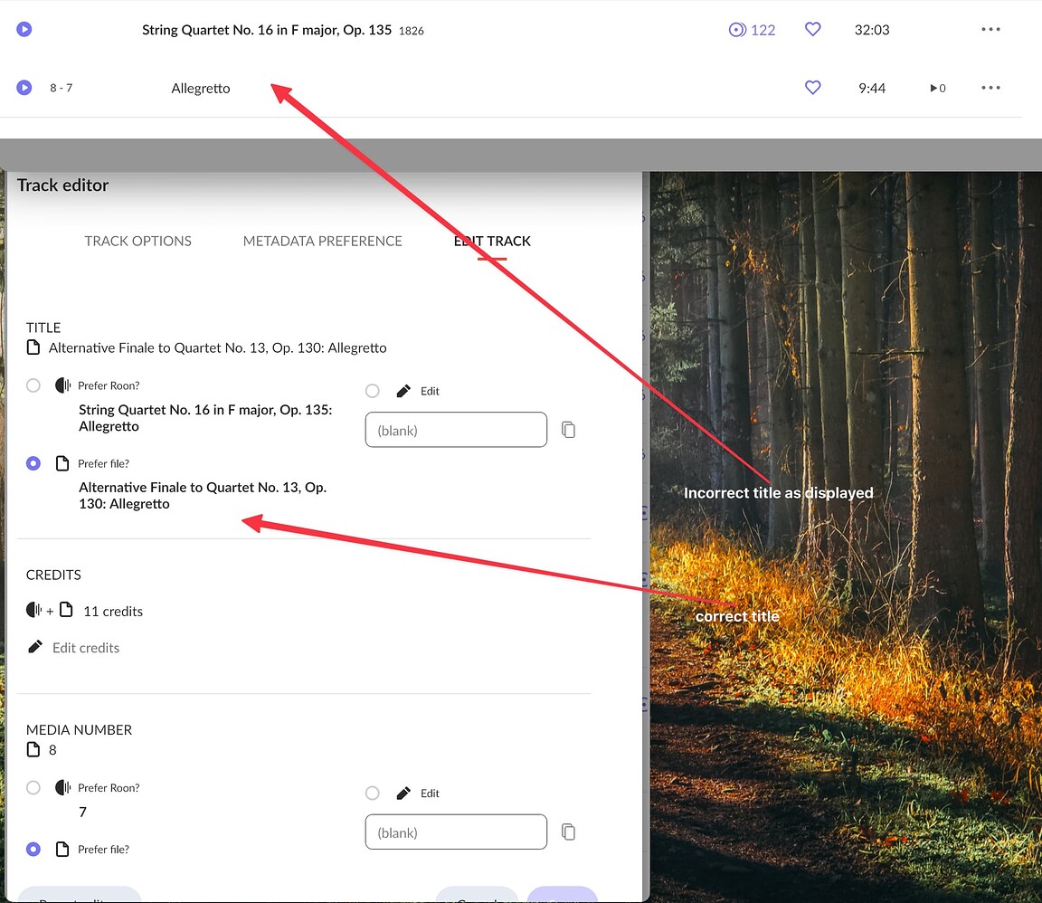

So I want to use my own title - especially for one particular track (CD 8, track 7), which is displaying incorrectly in Roon 2.48 build 1517 on macOS 15.4, as you can see from screenshots like this: https://community.roonlabs.com/t/grouping-error-again/296523/34?u=mark_sealey
But there appears to be a bug which prevents me from 'Preferring' my file's title as tagged (in Yate).

Your advice about WORK and PART is spot on, of course. I’m sorry that no screenshot I posted here made it clear that I have every last comma, quote, dash and full stop meticulously tagged with WORK and PART in Yate.

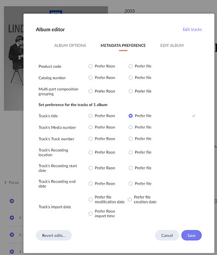

I also have - for that track - ‘Prefer file’:
Still get the mis-titling :frowning: .

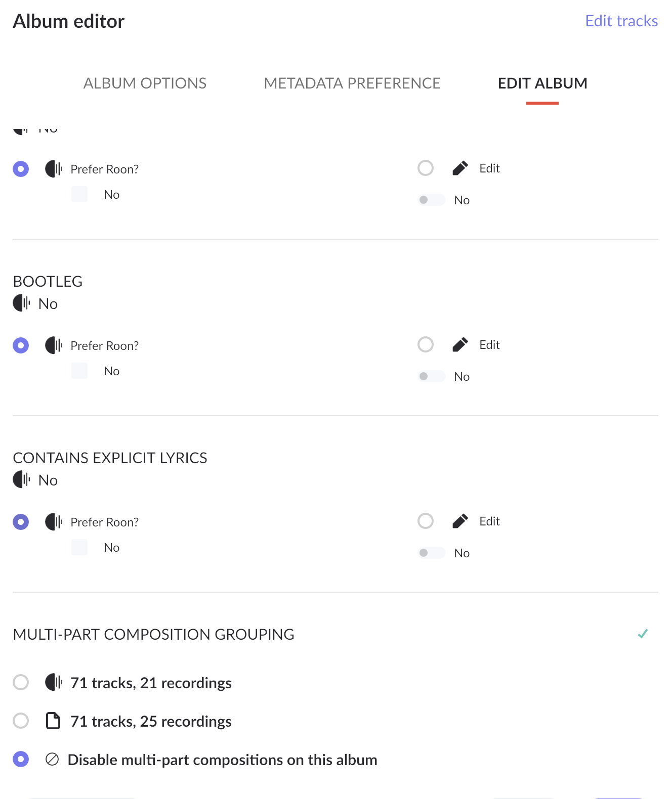

Because you have to disable the multi-part composition grouping for track titles to be used (as I already wrote).
If you have the tags, why do you want to insist on using track titles instead?

Again: If you have the correct WORK and PART tags already, just instruct Roon to use them (and give up on showing screenshots pointing at track titles). Please post screenshots of your settings related to multi-part composition grouping instead and how Roon is not adhering to those settings.
Again, I appreciate that it must be difficult to jump in (thank you!) without being familiar with the original thread.
From which, for instance, I re-post a screenshot of my settings relating to multi-part composition grouping:
In that case, with that setting - as I say in the discussion thread - everything displays perfectly; every single track including the Alternative finale of Opus 130.
And, as I say, when I prefer either ‘Roon’ or ‘File’ by selecting either of the first two options, not all the tracks - including this one one - appear correctly: with the correct Movement titles and as part of the correct Compositions. I take this to mean that Roon has not been able to identify the Box Set. I have tried forcing it to do so by supplying UPC and bar code.
There is a rogue movement, which only appears correctly, as you kindly point out that it might be expected to appear, when I Disable multi-part - as you suggest. Thanks again for the advice. I wish some of it were behaving - in this specific instance (!) - as it’s supposed to do :slight_smile: And as it has always done for me with Roon… until this one Box Set.

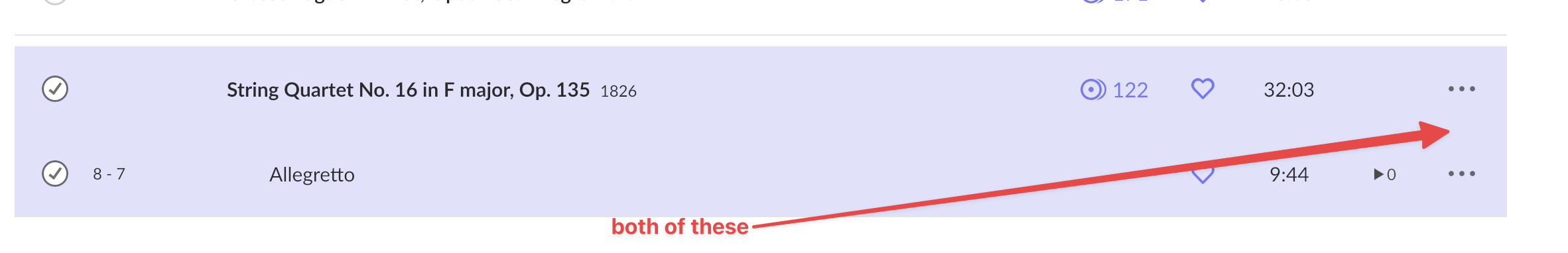

@BlackJack - @Mark_Sealey has every reason to expect that he should be able to enable multi-part compositions for his de-identified album and that Roon should use the WORK and PART tags he has populated. What is baffling is that it appears that some information from the album when it was previously identified (before he de-identified it) seems “stuck” and overrides his WORK and PART tags when the album is de-identified. That is what he is showing in the below. There is no good reason Roon should be showing Op. 135 for track 8-7, except for possibly oddly cached data from when the album was identified with bad data to begin with.
@Mark_Sealey I might suggest that what you are asking Roon to look into more specifically is this:
Is there a way that you can clear out the information that seems to remain from the original album identification process — esp. now that the album has been de-identified – that led to this track being “stuck” as Op. 135 even when using all of your own metadata?

  6. in the Album Editor > Metadata Preferences > for 1 album > Set preference to ‘Prefer File’; and toggled it on and off to try and make it stick
  7. in the Album Editor > Metadata Preferences > for the tracks of 1 album > Set preference to ‘Prefer File’; and toggled it on and off to try and make it stick

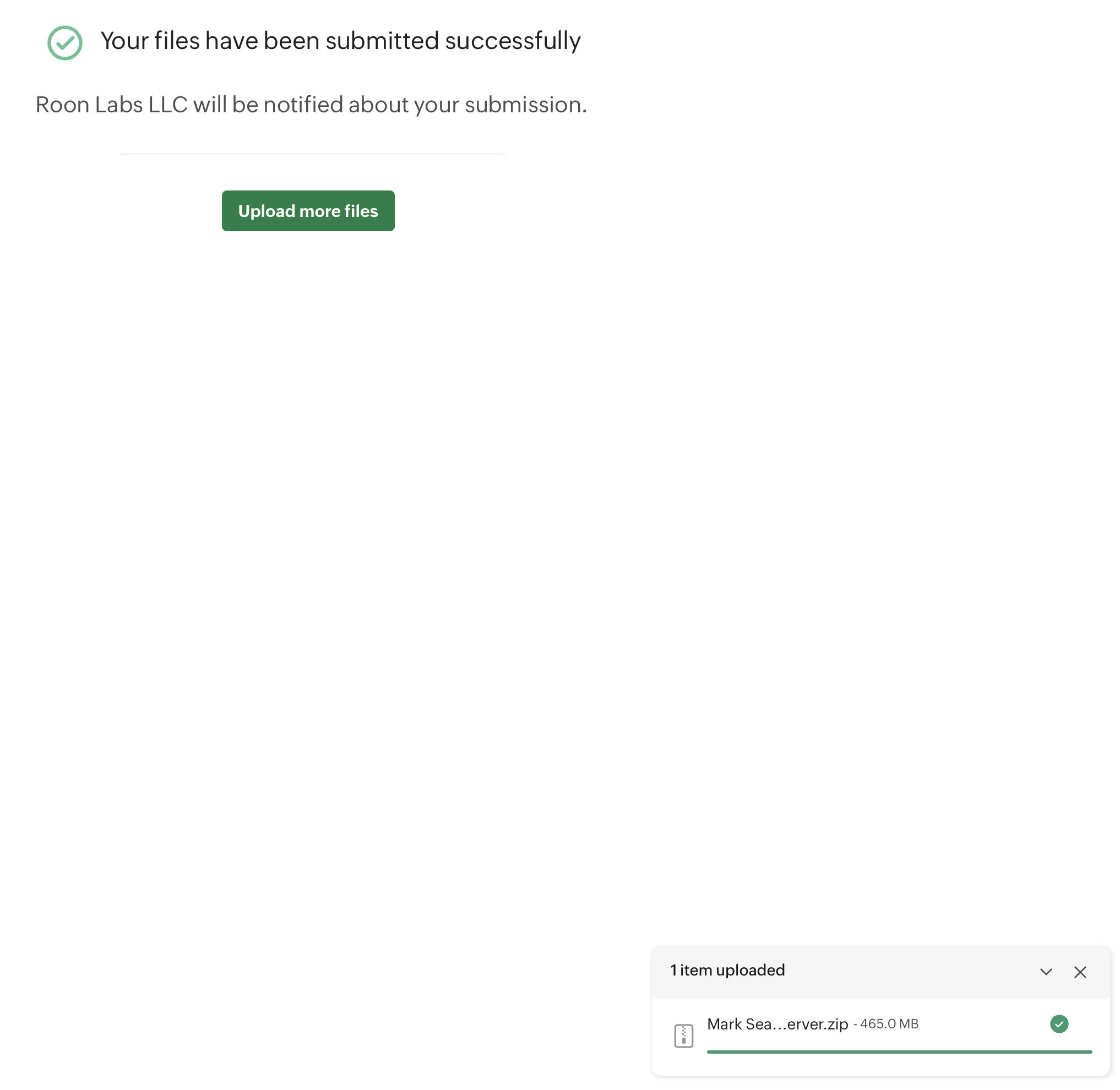

We’re likely going to need a copy of your database to reproduce this internally, as performance/composition munging is performed locally and not in the cloud.
At your convenience, please navigate to your RoonServer’s Database Location, compress (.zip) the entire “RoonServer” folder, and upload it here to our secure database uploader: DB uploader. Thank you!
Of course, @connor: server stopped, entire directory zipped and uploaded as requested. Thanks again!
Hi @Mark_Sealey,
Thank you for your help! We’re going to take a deeper look at the treatment of custom track title vs. metadata work field under these conditions, among other variables. Once we’ve clarified the expected behavior we’ll respond with next steps.
