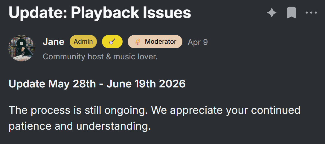

The latest on Qobuz, I gave up two months ago:
“Update May 28th – June 19th”
That’s a three‑week window compressed into a single non‑update.
When companies do this, it usually means:
they have no meaningful progress to report.
“The process is still ongoing.”
This is corporate‑speak for:
we don’t know when this will be fixed.
No technical detail, no root cause, no ETA.
For a service that markets itself as audiophile‑grade and editorially premium, this level of communication is embarrassing.

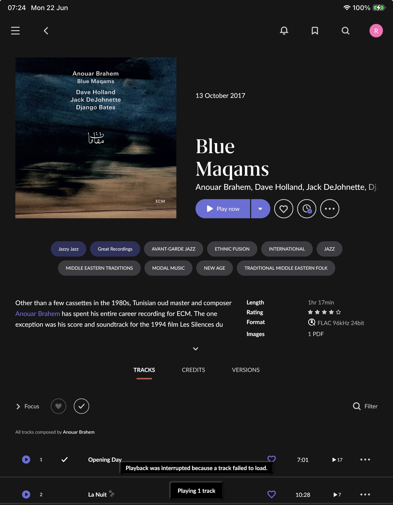

Another one, track can’t load. Track 1, Opening Day, Blue Maquams, Anour Brahem. 16/44 plays ok. UK.

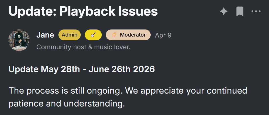

:waving_hand:t2: Hi everyone,
Another thank you for your continued patience on this sorely felt issue. We didn’t want to stay silent, no matter how scarce the update.
We are continuing to work with Qobuz on a resolution, but we don’t have new information to share at this time. If you’d like an update directly from Qobuz on their end, we encourage you to reach out to their support team.
In the meantime, we’ve made a small change on our side that should improve the experience when a track fails to load. This will be included in our next release.
We’ll update this thread as soon as there’s more to share.
