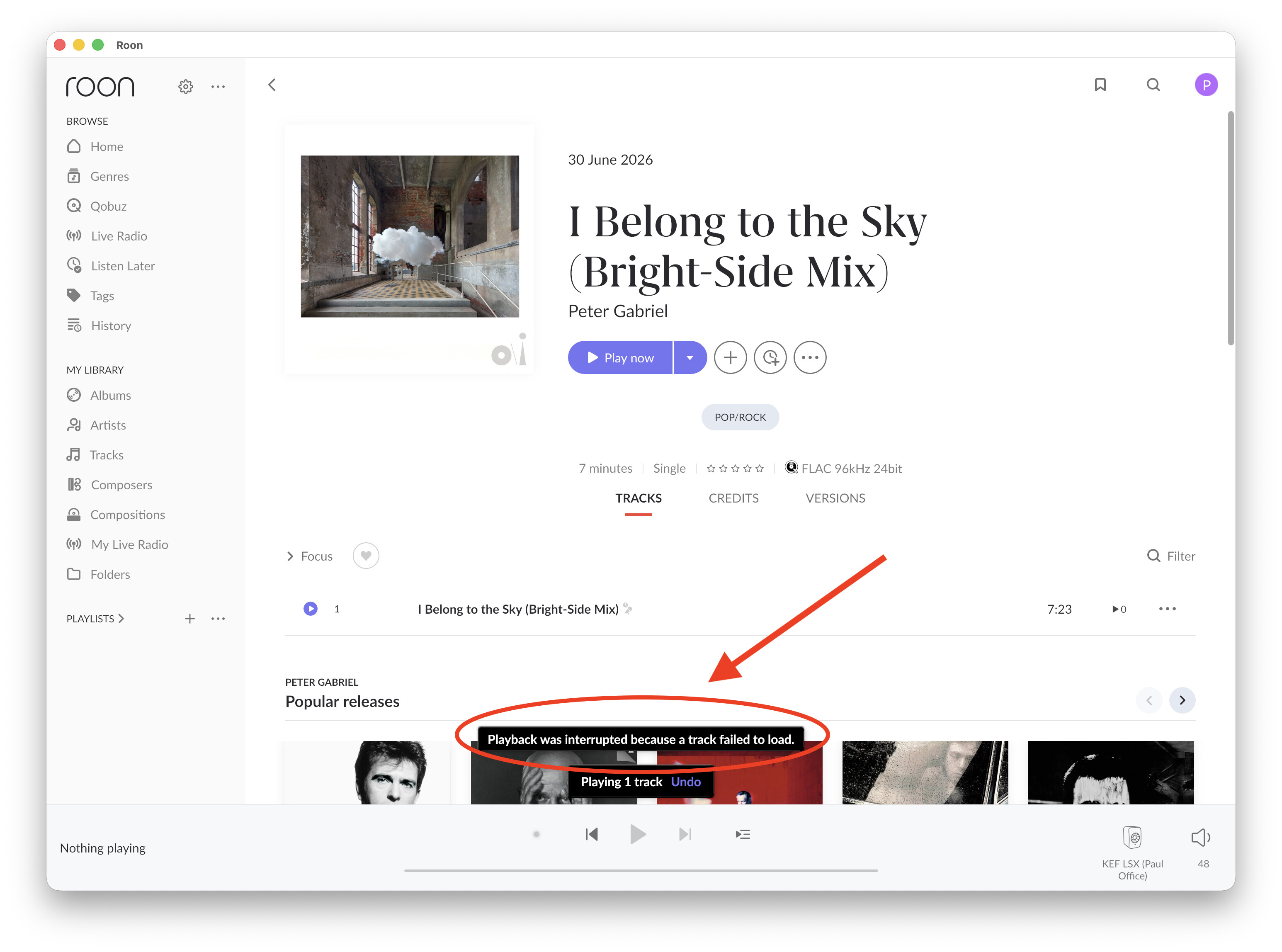

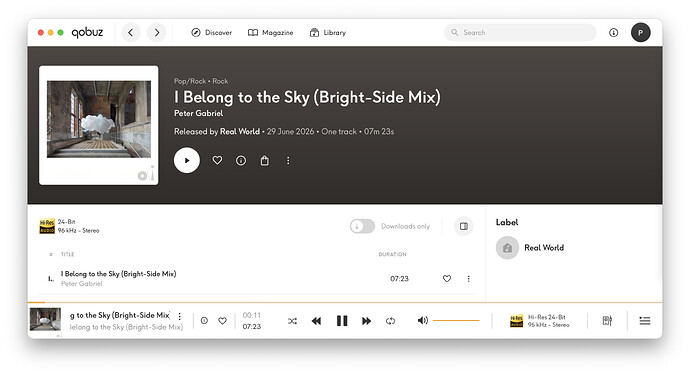

Peter Gabriel
I Belong to the Sky (Bright-Side Mix)
It seems Roon does not test whether new tracks will play correctly upon registration, so unless you specifically point out the issue to them, it likely won’t play properly.
On the other hand, since Qobuz experiences no issues with its own playback software, they probably won’t take proactive steps to fix it.
Doesn’t that leave the end user with no other option but to report the problem to Roon?

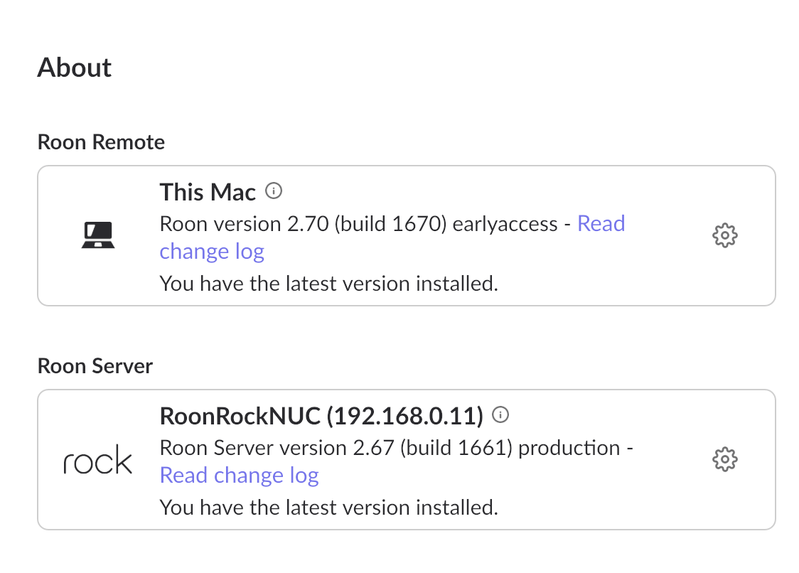

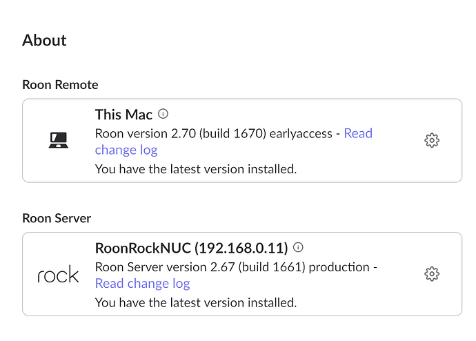

on my system with Roon 2.7 (build 1670) earlyaccess the song you mentioned is playing at 96 kHz using qobuz.
Which version of Roon do you use ?

You are running a mix of Early Access and Production. This is a Really Bad Idea and it WILL lead to problems sooner or later.
Huh had t noticed but thanks will put Mac client back to prod
