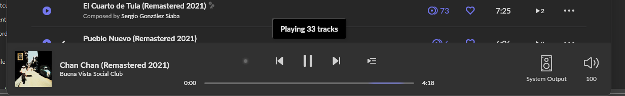

To add more detail, certain songs like the one pictured simply do not load.] It just spins for a minute then gives up, the very next song in the album works fine. Up to date, restarted everything, etc.
Exactly the same problem over here, but I saw some quickly disappearing messages like “Too many errors …” and “Track could not be loaded”
