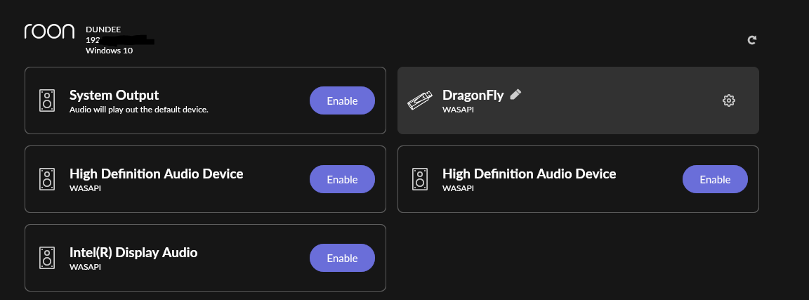

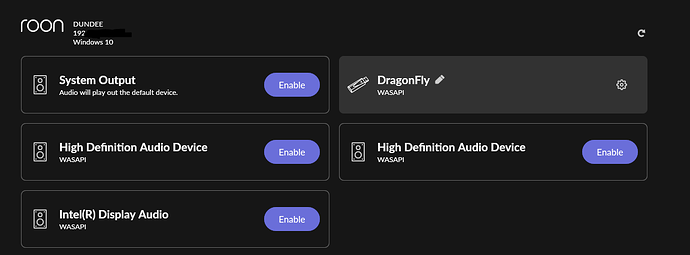

The Computer Running RoonBridge will appear in the Audio section, here is what a computer running RoonBridge looks like in the Audio section

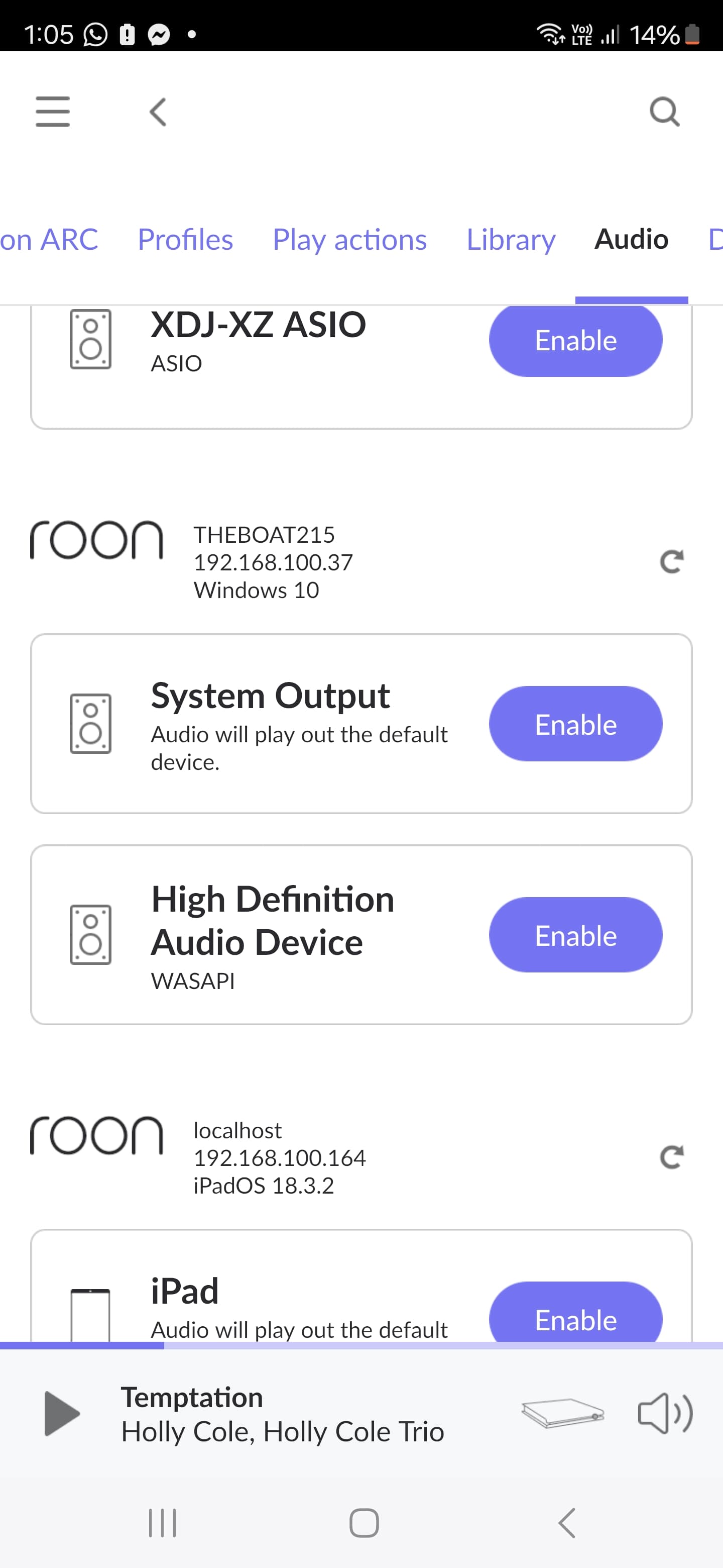

This is how mine looks like. What is supposed to happen next? How do I get my Mark Levinson No. 5101 UPnP renderer to stream via Roon? If at all possible? :cowboy_hat_face:
