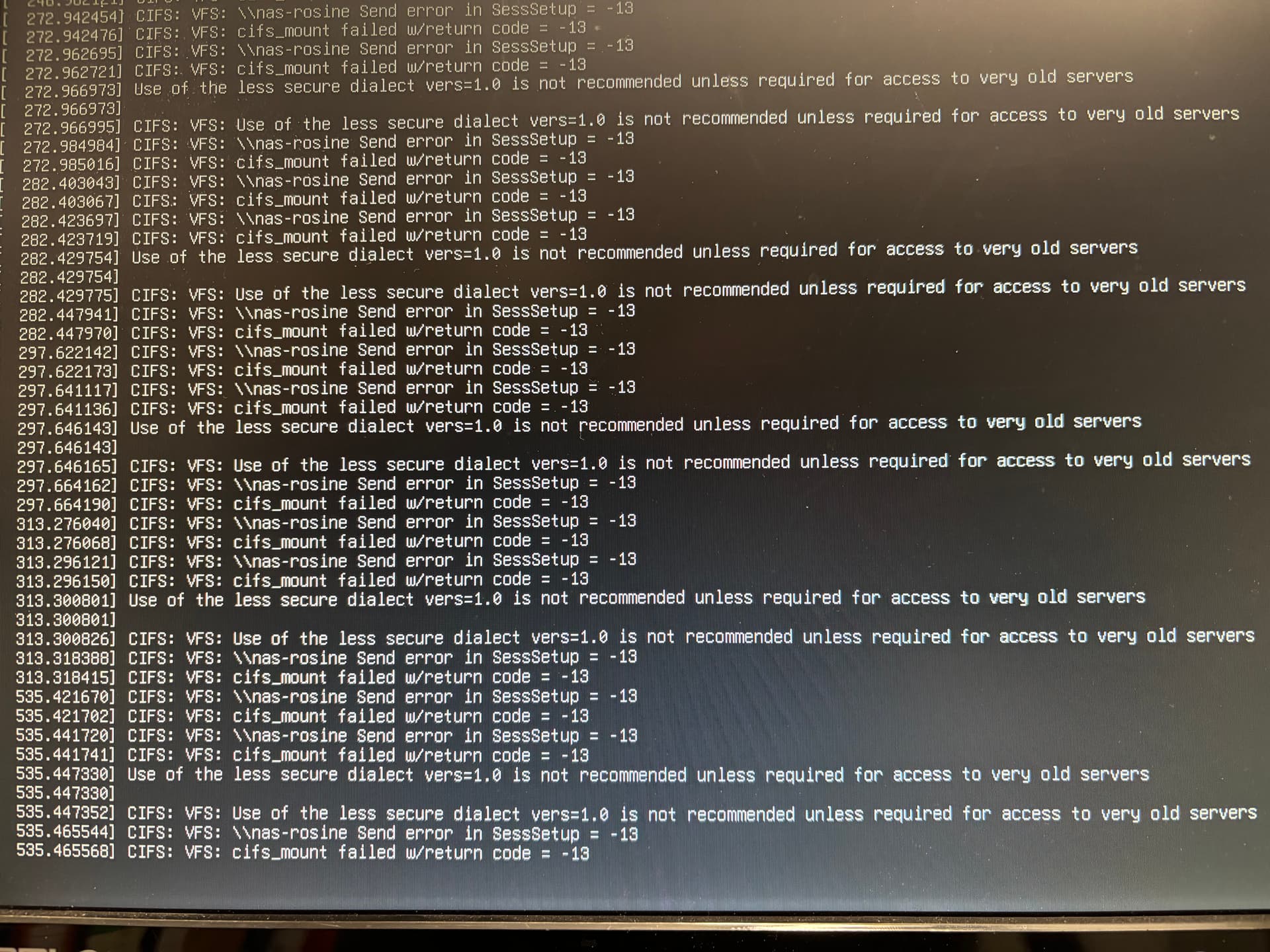

I enabled SMB v1 and NTLMv1 for testing purposes (lowest possible security …).
Still no luck making connections to the SMB server via the Roon GUI “add network share” function.
The only difference is that with SMB v1 enabled, you still get the Warning about SMB v1 on the console, but not the error code -95
You still get error code -13 on the console though.
Error Message in Roon GUI changes to “unauthorized”.
And yes, the correct user/password were entered.
Again, no entries in RoonServer log about this.
This is how the console output looks with SMB v1 enabled on the server side:
To my interpretation, this confirms that the roon app is trying to make a SMB v1 connection through cifs utils (hence the “insecure dialect” warning), which fails completely if the server refuses a SMB v1 connection (error -95) but also fails during user authorisation (error -13) if the server should accept the connection for some reason.
So I think this is a clear indicator that the issue lies with how the roonserver app sets up smb connections through cifs utils. Usage of SMB v1 should be avoided as well.
Again, manually mounting the share using the mount command or dietpi-drive_manager works just fine and can be used as a workaround as pointed out already by @mookr.
Or it is some governing process (like AppArmor or the likes) that blocks access for an unknown (to him) application. Maybe something is being logged in syslog or or other system logs?

And here the same in case SMB v1 is allowed on the server as well:
Dec 28 21:26:53 DietPi kernel: CIFS: Attempting to mount //nas-rosine/RoonBackup
Dec 28 21:26:53 DietPi kernel: CIFS: Status code returned 0xc000006d STATUS_LOGON_FAILURE
Dec 28 21:26:53 DietPi kernel: CIFS: VFS: \\nas-rosine Send error in SessSetup = -13
Dec 28 21:26:53 DietPi kernel: CIFS: VFS: cifs_mount failed w/return code = -13
Dec 28 21:26:53 DietPi kernel: Use of the less secure dialect vers=1.0 is not recommended unless required for access to very old servers
Dec 28 21:26:53 DietPi kernel: CIFS: VFS: Use of the less secure dialect vers=1.0 is not recommended unless required for access to very old servers
Dec 28 21:26:53 DietPi kernel: CIFS: Status code returned 0xc000006d NT_STATUS_LOGON_FAILURE
So it’s the same as already seen on the console. dmesg shows the same.

[2026/01/12 17:55:24.346572, auth 2, pid=14641] auth_check_ntlm_password
check_ntlm_password: authentication for user [roonbkp] → [roonbkp] → [roonbkp] succeeded

I can confirm this ‘problem’ with debian trixie, went down the same route the past two weeks, just stumbled on this post today.
Roon also has the same problem with mounted shares with music files. It sometimes works till the moment you add some new music a week later and ask yourself when they will be available in the interface. Sometimes going to the storage tab and hit rescan works, sometime a restart of the roon server is the only option to play the newly added music.
I’ve been suffering from this since i switched from ubuntu to trixie for various reasons.
Kind regards, edwin
Roon version 2.58 has the same issue, just to inform everyone.
Mounting smb via fstab or commandline works as expected, somehow roon ‘loses’ these connections doing it’s scanning etc. during the day. The weird thing is I’m still able to play my music files, so roon knows about its existence but adding music via smb to the share does trigger nothing in roon.
I physicallyt transferred the ssd’s with my music to my roonserver, mounted them locally using uuid’s, unfortunately with the same result! Roon loses them during a day or so. This has worked for the past two years with ubuntu 2024.
Also tried it with the latest arch and the locally mounted disks - indeed same issue, someone also tested ubuntu 2025.x with the same outcome.
Time for roon to chime in and solve this? ((Adding tickets to a dev que doesn’t solve it, putting it at the top of the que might help also))
It seems to me, as you’re describing another issue here apart from the original SMB-mounting problem using the “add network share” function in Roon.
If I understand you correctly, real time monitoring of music folders doesn’t work anymore with latest linux kernels (debian trixie, ubuntu 2025) even for locally mounted drives, correct? Does scheduled scanning (like daily) still work or does it fail as well?
I would recommend starting a separate support thread on this issue to make sure it gets recognized by Roon and eventually adressed.
Hi,
This seems to fix the scanning issue, Upgraded Roonserver from Debian Bookworm to Trixie, some caveats . You have to install the icu-devtools package. It has probabely something to do with localization and file/date orders, that’s my best explanation. So another ‘dependency’ for roon to work properly. I installed it on my debian box and since then the scanning for new music is still working.
The SMB mount option is still broken, can’t mount anything via the roon-interface.For now I mount everything via fstab and uuid’s
