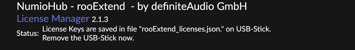

I’m unable to get the Numio Hub to mount a USB stick to save the license code.
Can someone who used MacOS Disk Utility to format a USB stick for this purpose please confirm the exact format (MS DOS FAT or exFAT), the partitioning scheme and the min/max size allowed?
I tried both a 256MB and a 32GB stick with a number of combinations of format and partitioning scheme, but nothing seems to work. I did see “Remove USB drive” (or something similar a few times, but it immediately flashes to “insert USB” then “unable to mount” etc.
Msdos partition scheme and FAT32 did the trick here.
Thank you. I finally got it to this point, but I can’t see the .json file when I look at this USB stick on my Mac. The drive is empty.
I’ve not looked on the drive truth be told but have used it to restore a license from one pi to another. The extension thinks it has done it’s job. Could it be a file permission issue on the Mac?

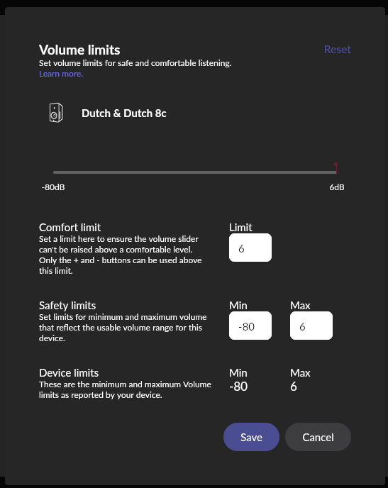

But i have an issue with the db/volume levels? i only get to use it at -20db and above so is way to loud and too short a control? anything in setting?
You can set the sensitivity limit of setup in the advanced settings.
I have mine set to low sensitivity, as it was changing the volume to quickly
Its not the sensitive, I can’t turn the volume down below -20db! so its very loud and can only turn it up louder!!
That suggests to me that you have volume limits set on your device.
All my devices work fully between 0 and 100 besides that some of them I have set volume limits on and it should work within the volume limits you have set up. So my paired Sonos 3’s in my study are set to between 8 and 48 as I hear nothing below 7 and its too loud above 48
This is how i have it setup - which are default roon setting for the D&D 8c’s?
But you do realize that common sense is the least common of all senses nowadays :innocent:
That’s strange one, though I do not know how this works with negative volume levels.
I only have them set as positives on mine.
I can see if I can test my Matrix Audio as that works in a similar way to the D&D’s but I have never had volume limits set until now
