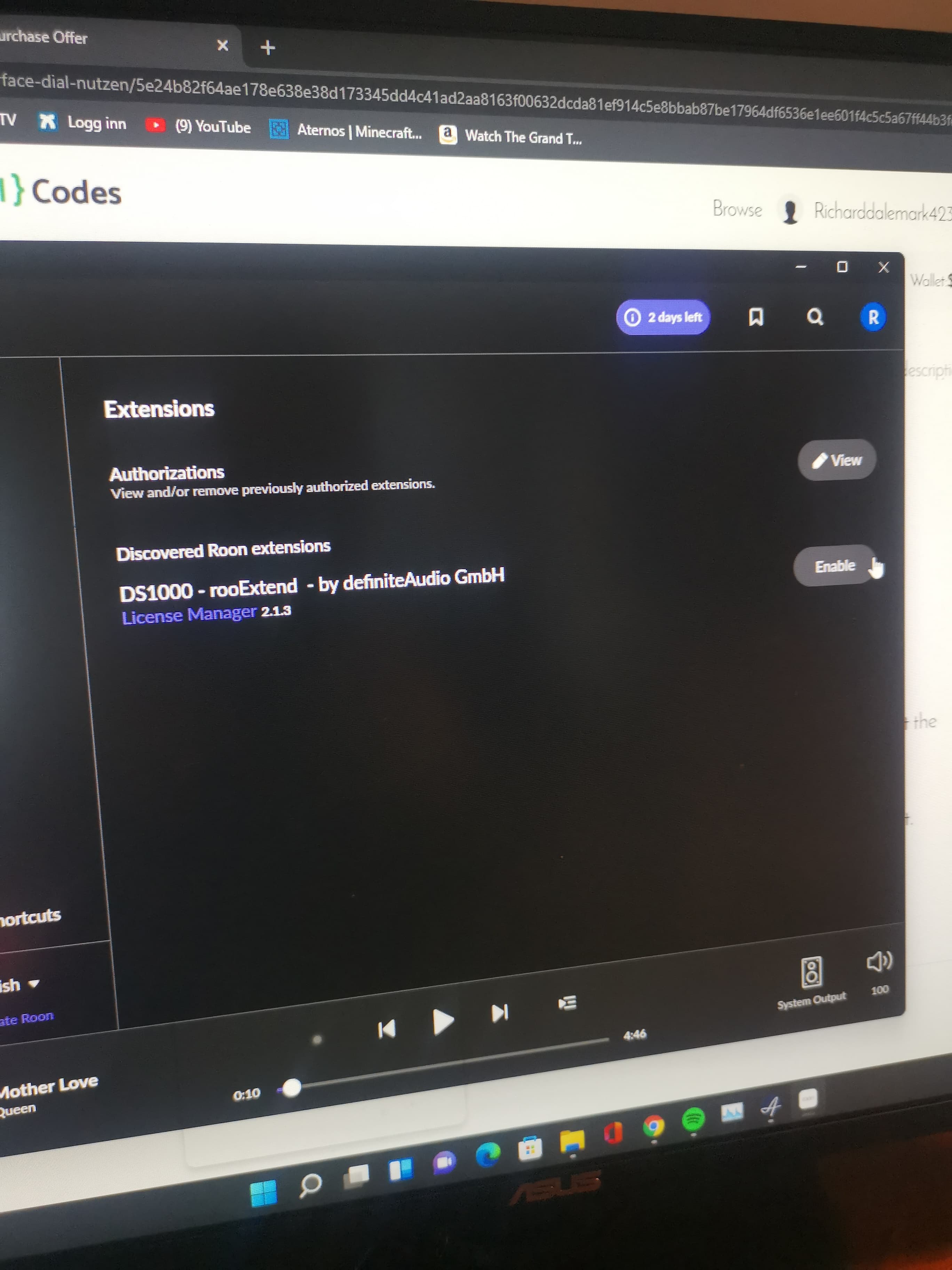

rooUpnp not visible under extensions. I have only visible License Manager 2.1.3 under Extensions.
I also paid for rooUpnp license, so I have the license key.
Richard I use RooExtend for other parts but not RooUPNP.

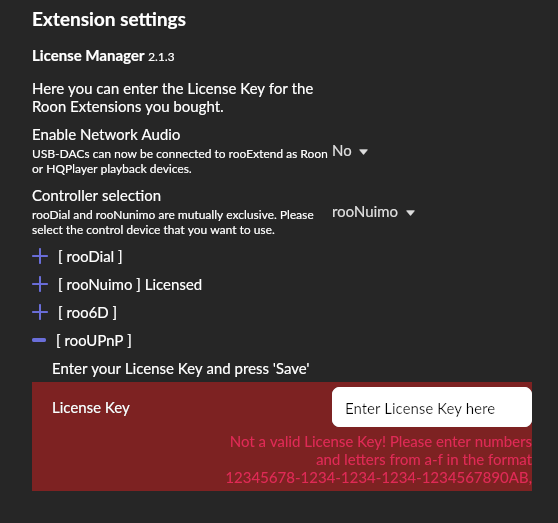

You have to go into license manager and paste your license code for RooUPNP for it to run (at least you have to with RooNuimo)
Do I have to paste the key under extensions? I can not find rooUpnp under extensions, only rooExtend and roo6D.
Hi Richard I just jumped on mine here and this is what I see with the latest 2.1.3 install of RooExtend.
Just paste your key in here and the software will start the extension

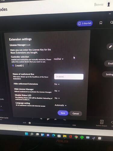

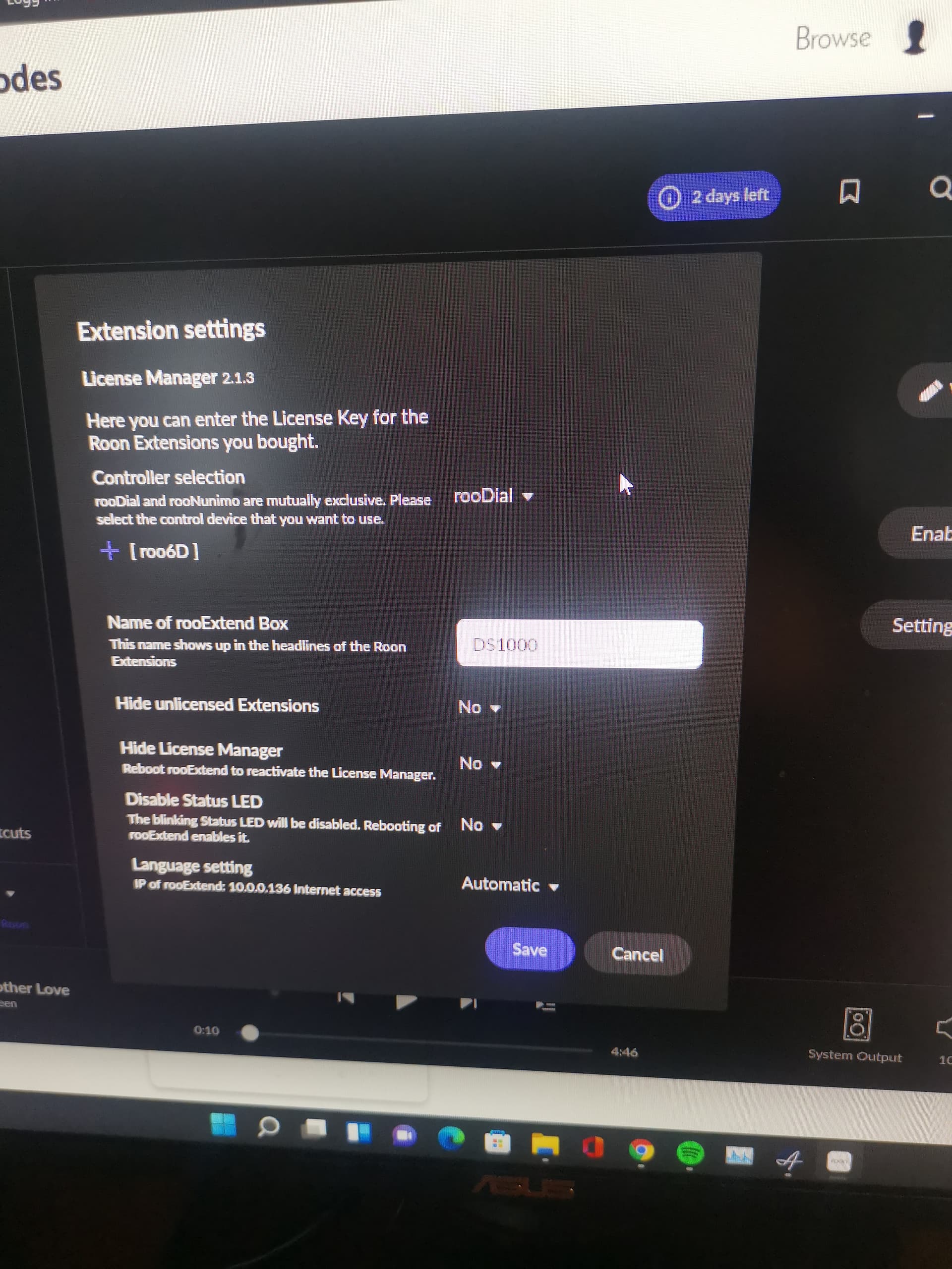

Still not finding rooUpnp
Something wrong there, it should look like mine if you have the full RooExtend installed.
Maye try to download and burn a new image on a new card if you can.
I only installed my second device yesterday and all perfect, though I have been running my original for several months and seen nothing like this problem.

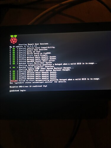

I have installed image on a 64gb SD card so it should be ok. I’m starting to suspect that my raspberry pi 3 B + has too little memory. It has 512kb. Could the fault be there?
Now I have only tried it on a PI4 with 4GB, though I know it works on other devices.
Though I remember the Doctor saying about RooUPNP needing more power than older devices had.
But you are missing RooNuimo etc as well so I will let the Doctor pick that up
As for micro SD cards I think it only needs 4GB to work
Do you have another Pi you can run it on to test it?
