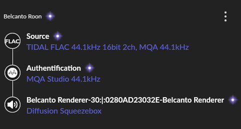

Hello [DrCWO] I have two streamers using your application a Marantz M-CR511
that works flawless at any frequence and flac 24
But the Belcanto Refstream accepts only MP3 à 48K.
Normally the streamer can handle easily any wav, flac or other high res files
Any idea what it means?
Am I reading on Mp3? Any possible evolution?
Maybe an update?
Capture d’écran 2022-01-07 à 22.44.59
UPnP implementations between manufacturers differ a lot.
In case of rooUPnP there is an other speciality. Via rooUPnP Roon sends a continuous data stream instead of length limites data files for each track. This is like streaming internet radio.
Not all player accept FLAC radio streams. In normal life this is no problem as radio ist mostly transmitted via mp3. But for rooUPnP it is essential. If there is no update for the BelCanto I am not able to help. I thought about implementing a scheme that sends single FLAC files for each track. I did not because it will be a huge effort and too less customers.
UPnP is an old and not well defined standard. So rooUPnP was thought to help people with elder devices to use Roon before they switch to a Roon Ready device.
If you are lucky and BelCanto offers a new firmware that will work.
Best DrCWO

Hello.
How can you from this screenshot see Roon broadcast in MP3?
@ [DrCWO]
Thank you for your answer.
Does this means that roon streams as an MP3? Event if the source is a quality flac?
What does it means the setup mp3 in rooUPnP?
