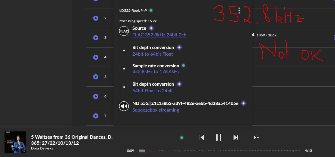

Unfortunately, it doesn’t support 24/384kHz (or 352,8 kHz) streaming, it is limited to 176.4kHz/192kHz.
Are you planning to implement the 384kHz capability?

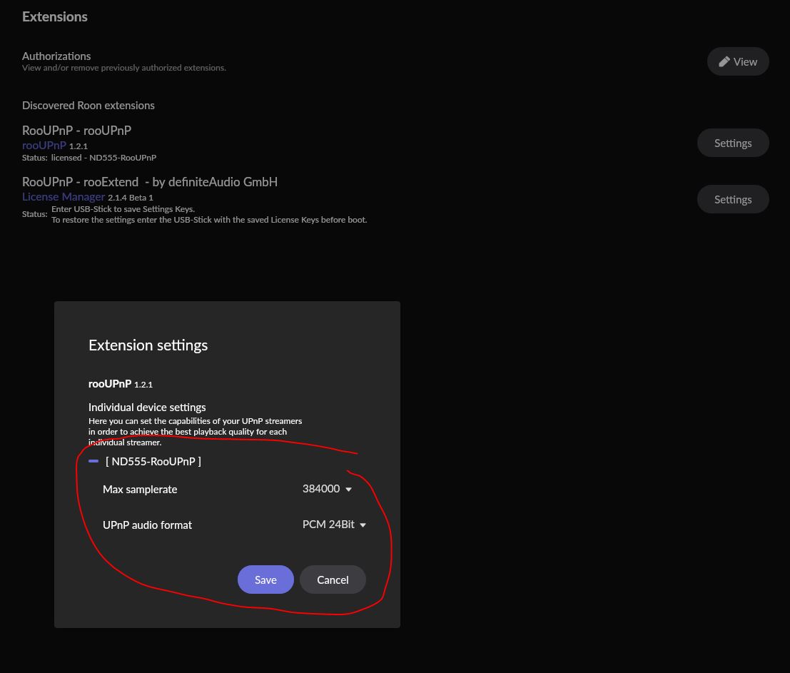

@Thomas_Serra, I uploaded a beta here. rooExtend-Beta - Google Drive. Please try if this works with the higher rates. I wonder if the Pi 4 is able to handle this speed.
Please let me know.
Best DrCWO

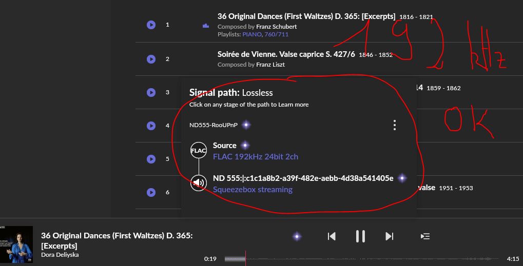

@DrCWO The Pi 4 has a Gigabit Ethernet adapter
Should be ok. I’ll try this evening!

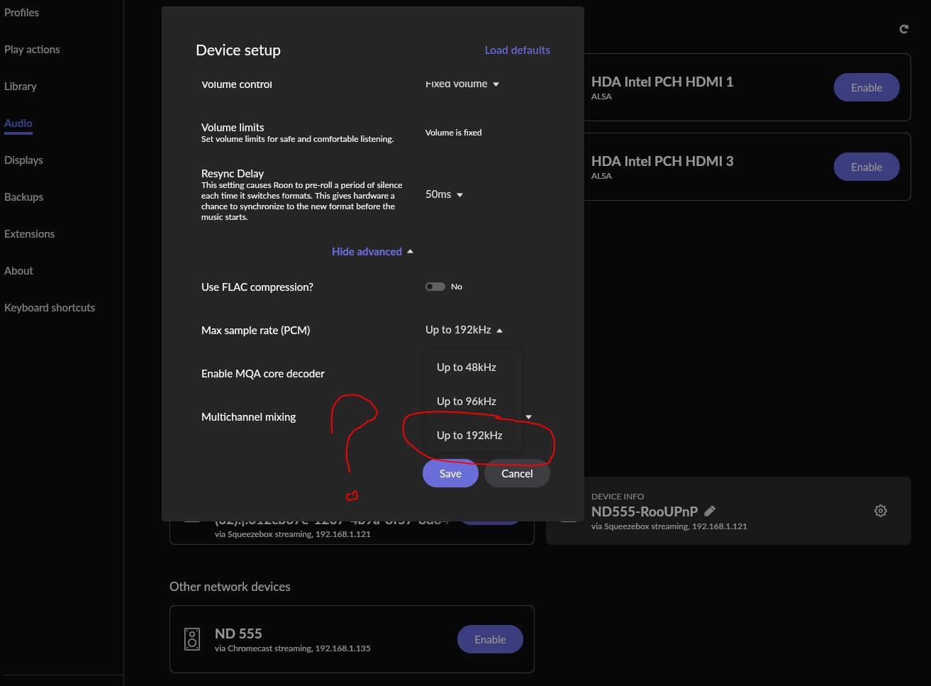

@DrCWO Max sample rate seems limited to 192 kHz in the device setup.

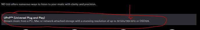

My streamer/DAC is a Naim ND555.
It should be able to handle streams up to 32bits/384kHz
Hi Thomas,
very bad :face_vomiting:
As far as I can see now, this limitation seems to be part of the Squezze API implementation by Roon. I extended rooUPnP to 384 and checked if the underlaying code has limitations. It has not.
I think this is the end of the story. If the Squeeze API is limited I have no chance.
