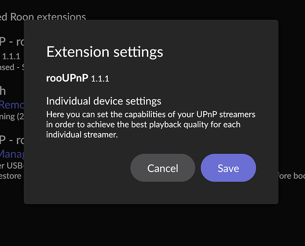

Have you enables Squeezebox-Support in Roon Settingsâ>Setup?
If yes: Have you Enabled your device in Roon Settingsâ>Audio?
If it shows up there you also can see it in the Roon Extensionsâ>Settings rooUPnP
