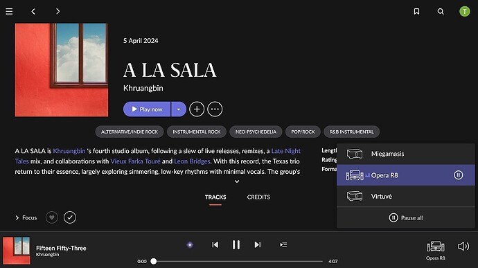

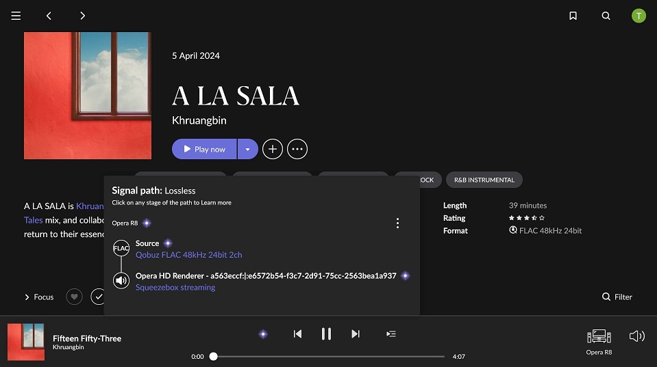

Hello.
I installed and ran rooUPnP. Roon sees my streamer Opera R8, but no sound. rooUPnP setting changes do not help.
Maybe the problem is that there is no Audio interface (the last photo is defined in red)

I want to use Opera R8 as a streamer that can be controlled with Roon.
Internet radio on Opera R8 works without any add-ons.
The situation was similar when using BubbleUPnP on android mobile. Opera R8 was visible as a renderer but did not play music. After enabling in Opera R8 renderer settings “Proxy Qobuz tracks” everything became OK.

Not with rooUPnP does not play. Play with BubbleUPnP, after enabling the setting of this program, “Proxy Qobuz tracks” .
