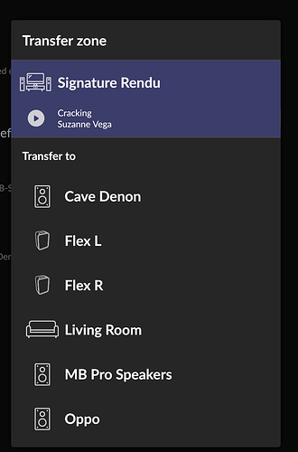

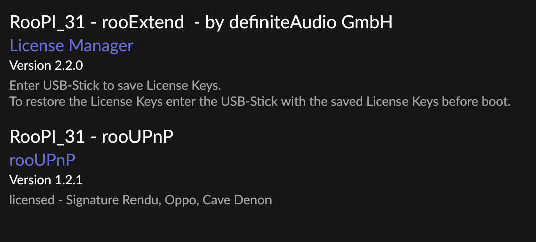

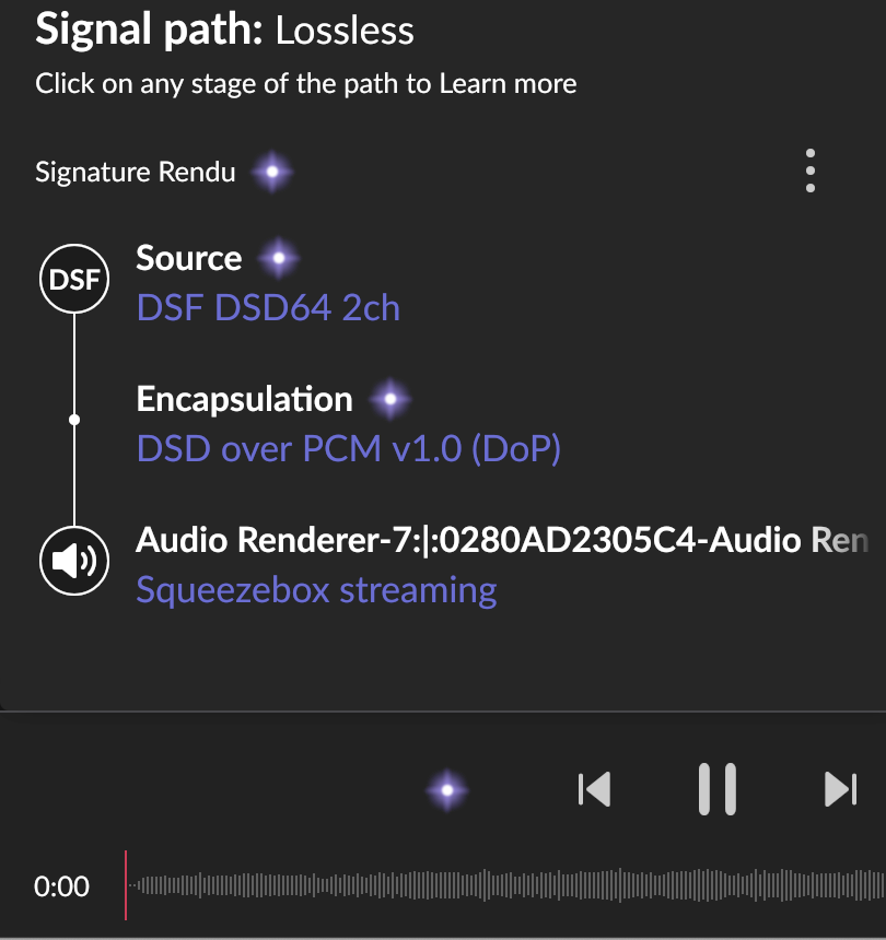

@DrCWO I have a few questions, I have never been able to use RooUpNP but now I am closer than ever. I am using a Sonore Signature Rendu to send data to a PS Audio Sr DAC. Everything is hardwired. I am running your code on a Pi4 with 8mb of memory.
Everything looks fine until I go to play a file. I send a file to the Rendu, Roon looks like it’s playing but no files are actually being sent to the DAC. The animation next the song is moving but the progress bar at the bottom of the screen does not move.
When I transfer the music the DAC is engaged, but the Signature Rendu does not appear in the signal path.
Hi, How are you connecting the PS Audio DirectStream DAC to the Sonore Signature Rendu?
Surely by USB
If so, then the Sonore Signature Rendu with the Roon Ready app installed will present as a Roon Endpoint, and will see the PS Audio DAC attached.
Why the need for UPnP stream?
And if you to send a UPnP stream to the PS Audio DAC on its network input run the SonoreUPnP Bridge on the Rendu.
I am connecting via HDMI cable to the I2S input. The signature Rendu was an early product and does not have the Roon Ready app. Thanks for your suggestion though.
