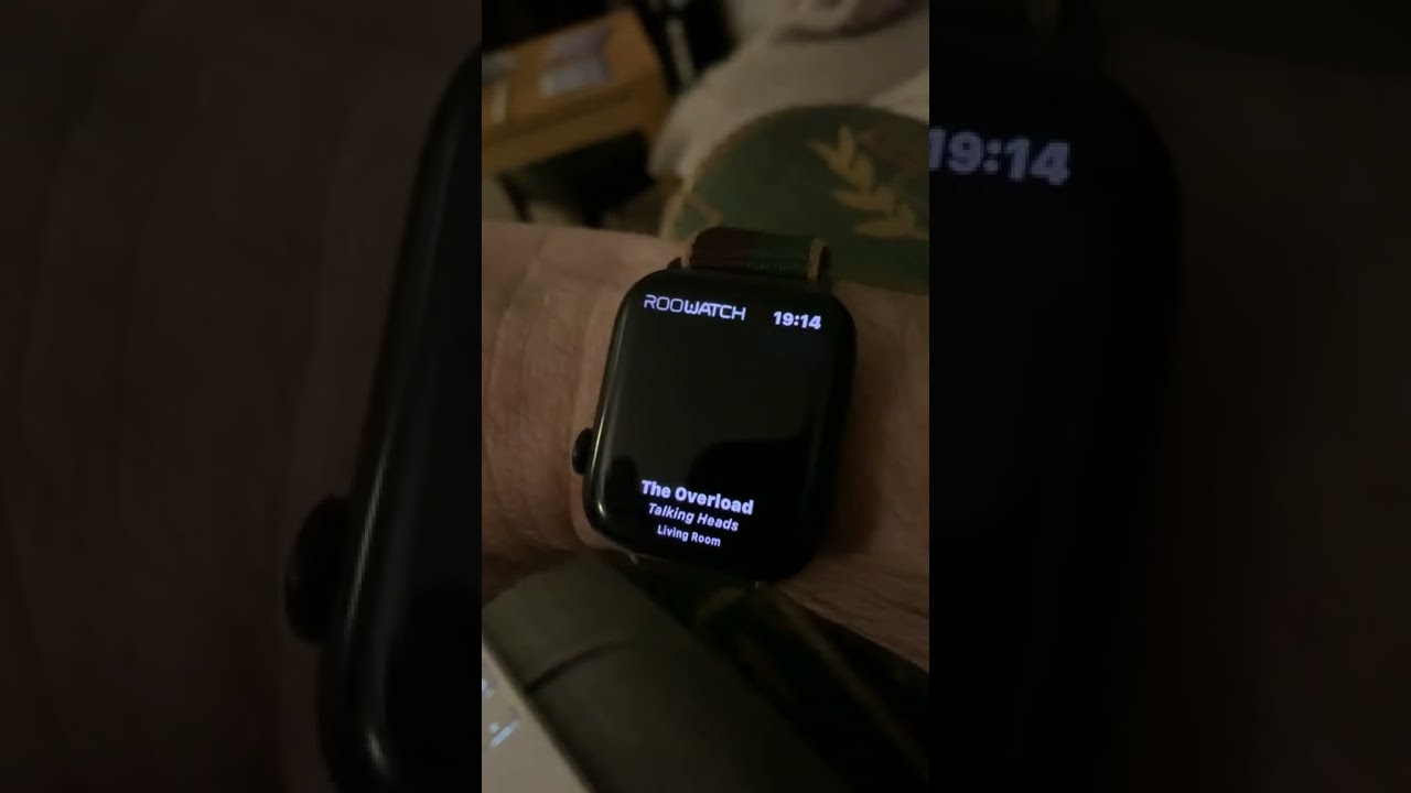

I think this is since I upgraded to watch os 9 but whatever the cause the song title and artist are disappearing (I think after a set of time) and pressing the ROOWATCH logo doesn’t bring it up again but it will re-appear as the next track is played.
