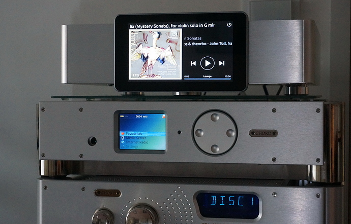

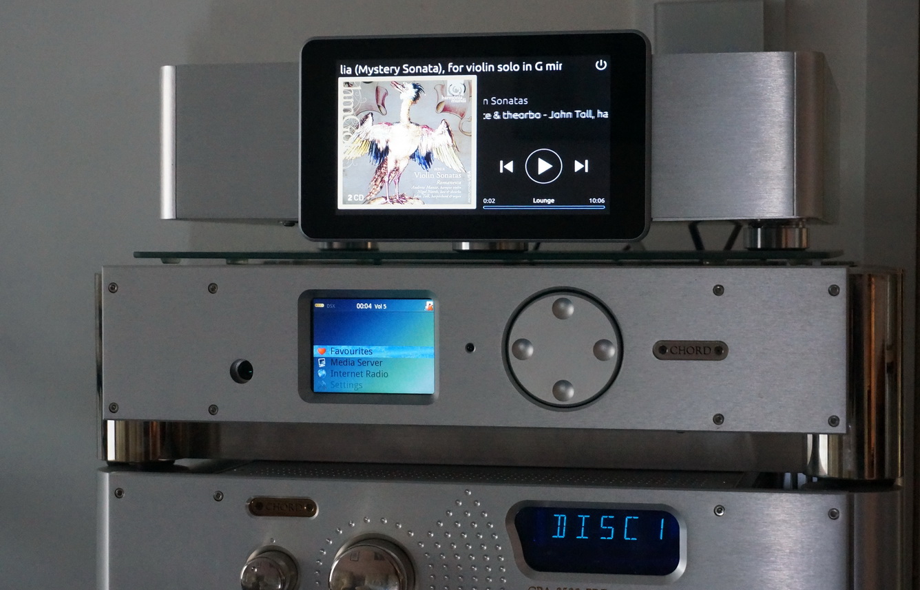

Hi John, you wanted updates…!!! Streamer in Silver with screen central to chassis this time. This is the too much money version where the added SQ for $$$ $pend was too small to matter, so this prototype is the ‘stop spending’ version and is a now a permanent fixture in the lounge HiFi.

Nice! Looking forward to more reports regarding the affordable version. The large screen is very nice from the standpoint of visibility and function (and probably cost as well - is it the standard 7" RPi touchscreen?). It would be doubly nice if it could be somehow integrated into the chassis – but that would require a taller custom case and bring the $$$ way up, not down. Keep on with it!
Hi John,
Thanks for the reply. Yes, it is 7” showing RoPieee and a remote control; I did have it in a full height chassis which makes the unit big + agreed with family and friend that felt it looked bloated at 130mm high (have some ideas to compensate a little on this). I milled out for a 5” which fits the chassis front plate, it looked good yet similar to other products. Now understand the software coding needed/cost to write a Linux bolt-on screen app to combine multi-apps for a screen i$ complex and high.
I home auditioned the Auralic G1 which has a 4” screen … nice as it is yet too small when you are away from the unit for my use, from my sofa the data/art looked too small. BTW my ‘stop spending’ prototype IMHO (biased) sounded better (A/B switching, same pressure levels, blind button presses. Etc).
I feel a screen + roon is key and to loose RoPieee screen visibility would be a real shame. 5” is a compromise to consider and worthy of a market survey …. SO, if anyone wishes to voice an opinion please reply and I can open a new thread etc.
