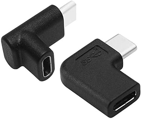

This case requires the Raspberry Pi’s display to be mounted upside down, which doesn’t match the display’s ideal viewing angle. So, I jerry rigged it to stand upside down! Also note the use of right angle adapters to neatly route the cables.
These are the right angle adapters:
https://www.amazon.com/gp/product/B07S6B5X76/ref=ppx_yo_dt_b_asin_title_o07_s00?ie=UTF8&psc=1
