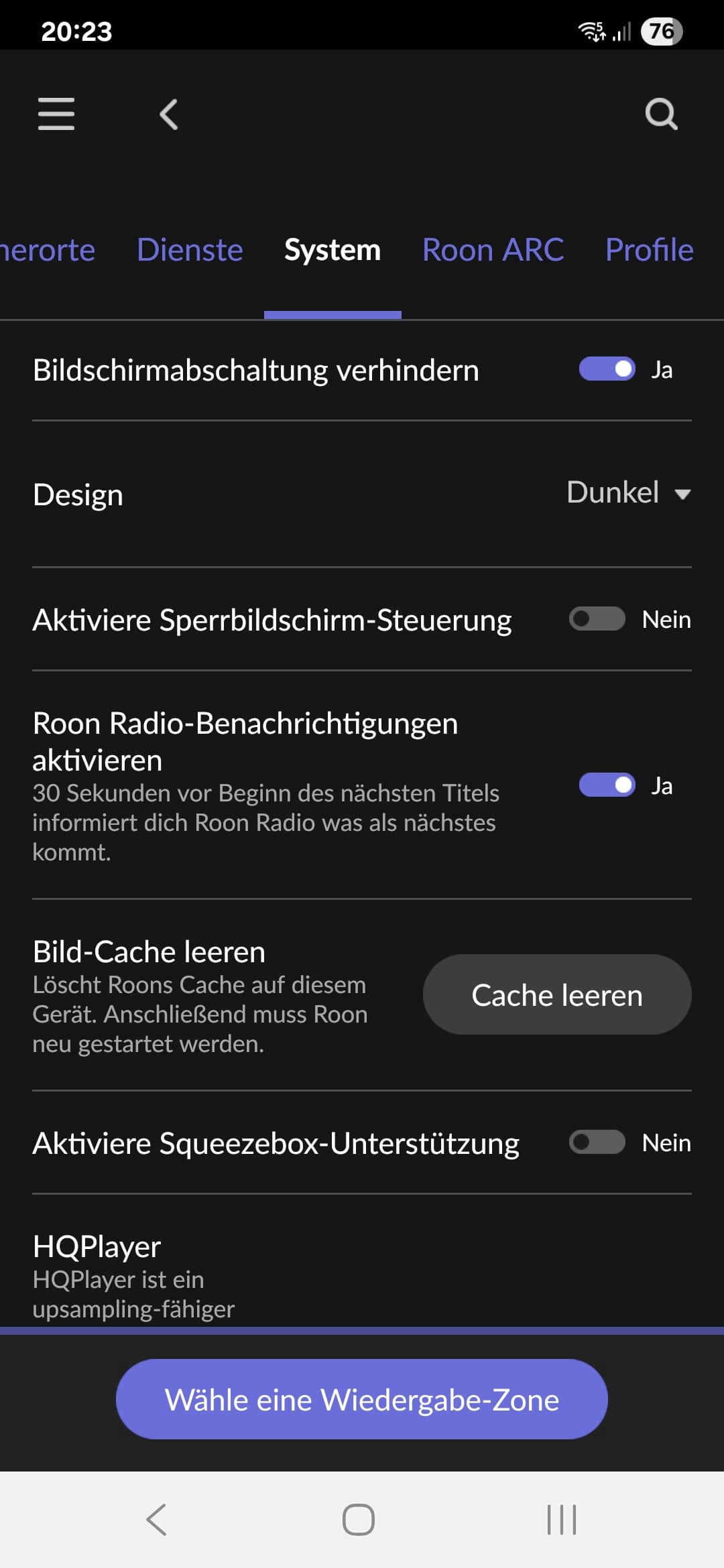

I resolved the issue by disabling the “Enable Lock Screen controls” option in the settings. With that option enabled, the phone’s UI would constantly freeze.

I’m seeing the same or a very similar issue on a regular S25, OneUI 7.
If “Enable lock screen controls” is enabled then as soon as the screen is turned off or locks, Roon seems to cause SystemUI to head into a crash loop that requires a hard reboot. Turning the option off fixes this.
