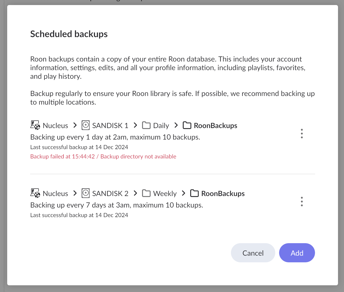

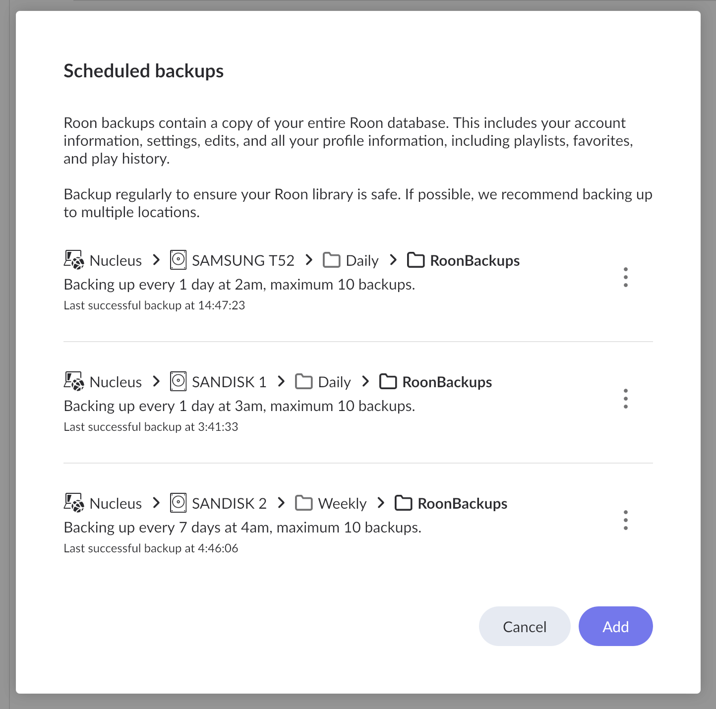

I had an SSD connected to my Nucleus which contained my backups folder. I noticed that after years of backups completing at the scheduled time without any problems, fairly recently backups were not completing, forcing me to do a manual backup later in the day.
I was concerned that there might be an issue with the SSD, and as I also wanted to store my backups in more than one location, I invested in a dongle and two 128GB memory sticks and scheduled new backups for each of these disks.
In the first screenshot below, from yesterday, you can see that the initial ‘weekly’ backup completed, but the initial ‘daily’ one did not.
I noticed that the daily backup hadn’t completed again this morning, as I’d been up pretty late listening to music, and there was a notification that the backup hadn’t completed for this reason - I was using Roon at the time. When I tried to complete a manual backup to the daily folder this afternoon I got the message blow:

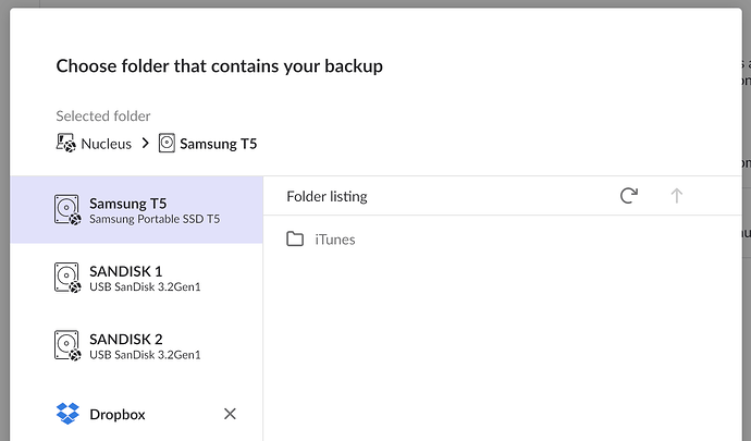

I then went to Backups > Find Backups > Browse, and the two new memory sticks were not listed, but I powered down the Nucleus and the router and started them up again, and they were listed after I did this, as shown below:
I am understandably perplexed, because I have gone from a situation where scheduled backups were completing without issue, to a situation where backups - on two separate external storage devices - are failing to complete.
Does anyone have any advice? I’m scratching my head here, and would like to know why this communications problem has arisen.

Hi @Alan_Meldrum , Sorry to hear about your backup issues. I’ve experienced this as well, but do not recall what tweak I made to correct it.
Till someone from the Roon team responds, you might access your log files on your Nucleus and look for anything with the keyword “backup.” If you see any error messages related to it, post an image of it here and maybe a fellow Roon member can assist. The Roon team will be interested in seeing your logs as well.

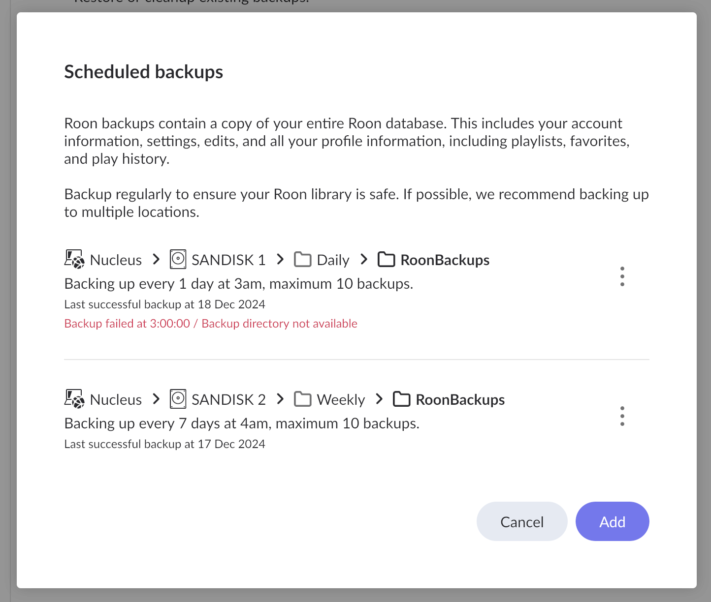

Thank you for this. As you can see from the screenshot below, another day, another failed daily backup
I copied the logs as you suggested, link to the zip file is below. Opened up a few files, but didn’t see at first glance ‘backup’ noted anywhere, but it’s all pretty dense. I’ll wait and see to see if someone from Roon has an opinion, or maybe someone from the community. Thanks for your input, much appreciated.

Hi @Alan_Meldrum ,
It would appear that you have a failed/failing USB port on the Nucleus. My guess is that the two disappearing than reappearing again thumb drives are on your failed port.
You can verify this by performing several attempted backups per port. Often unplugging a USB device from the port and than back again without the drives appearing indicate the drive hasn’t been mounted.
Roon support maybe able to help you with diagnosing this issue and if there are any repair options.
I ofcourse can’t say positively that’s the issue but it’s a strong contender.

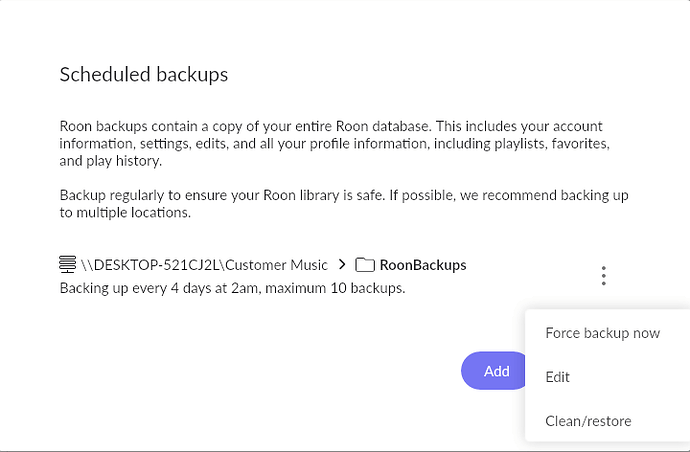

Hi @Alan_Meldrum , You can test @Singleton 's theory now by choosing the “Force backup now” option to the drive you’re concerned about…
Some have even found doing a Forced backup solved their scheduled backup issues going forward. Good luck!

Hi @Alan_Meldrum,
According to the most recent diagnostics, this Nucleus is beyond its hardware performance capabilities and reporting out-of-memory. Unusually high database validation times - triggered by track corruption that is detected in the iTunes library - are causing this Nucleus to overconsume resources. This is likely a downstream result of the large number of albums and playlists in this library - although you’re below the 100k track limit recommended for a Nucleus of this RAM, the object and metadata volume is on the order of magnitude of a much more massive library.
What is the specific number of playlists you have saved in Roon (before they began to disappear recently, per your other thread)?
In the long term, you’ll inevitably need to upgrade the RAM of your RoonServer machine as this library - and your curation thereof - expands.

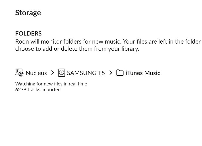

Having made a back up of my iTunes library to an external drive, I went though my library in iTunes and deleted number of tracks which i felt were not essential to the collection, and reduced the number of tracks in the library from 27,000+ to 18,000+. I then copied this reduced iTunes library from my computer to an SSD and connected it back to the Nucleus. I was aiming to give the Nucleus a smaller library to work with in the hope that it would not ‘overconsume resources’ as you had previously highlighted.
The SSD/music folder scanned fine, but the importing of new files is going incredibly slowly - it’s been going for about an hour and a half, and 170 tracks added so far. Should it be this slow? Is there anything I am not doing correctly? If you, or anyone else could advise, I’d really appreciate it. SSD was formatted to EX-FAT, and at this rate I reckon it might not be finished before Christmas.

Below is a screen shot of what seems to be happening - two hours in. I just don’t remember it taking this long when I did this the first time, and am a bit anxious.

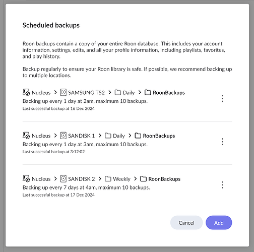

As for the backups, I attach screenshots showing the last three mornings’ backup info:
Tuesday 17th
Wednesday 18th
Thursday 19th
As you can see after Wednesday I disconnected the Samsung SSD, as it didn’t seem to be receiving any info. Today’s info I kind of expected there to be no daily backup, as the import was happening, but when I browsed the backup folders - seen in the pic below - the dongle holding the two SanDisk memory stick is not showing up. Perhaps this was because I was plugging and un-plugging on the Nucleus yesterday, but still a cause for concern.
