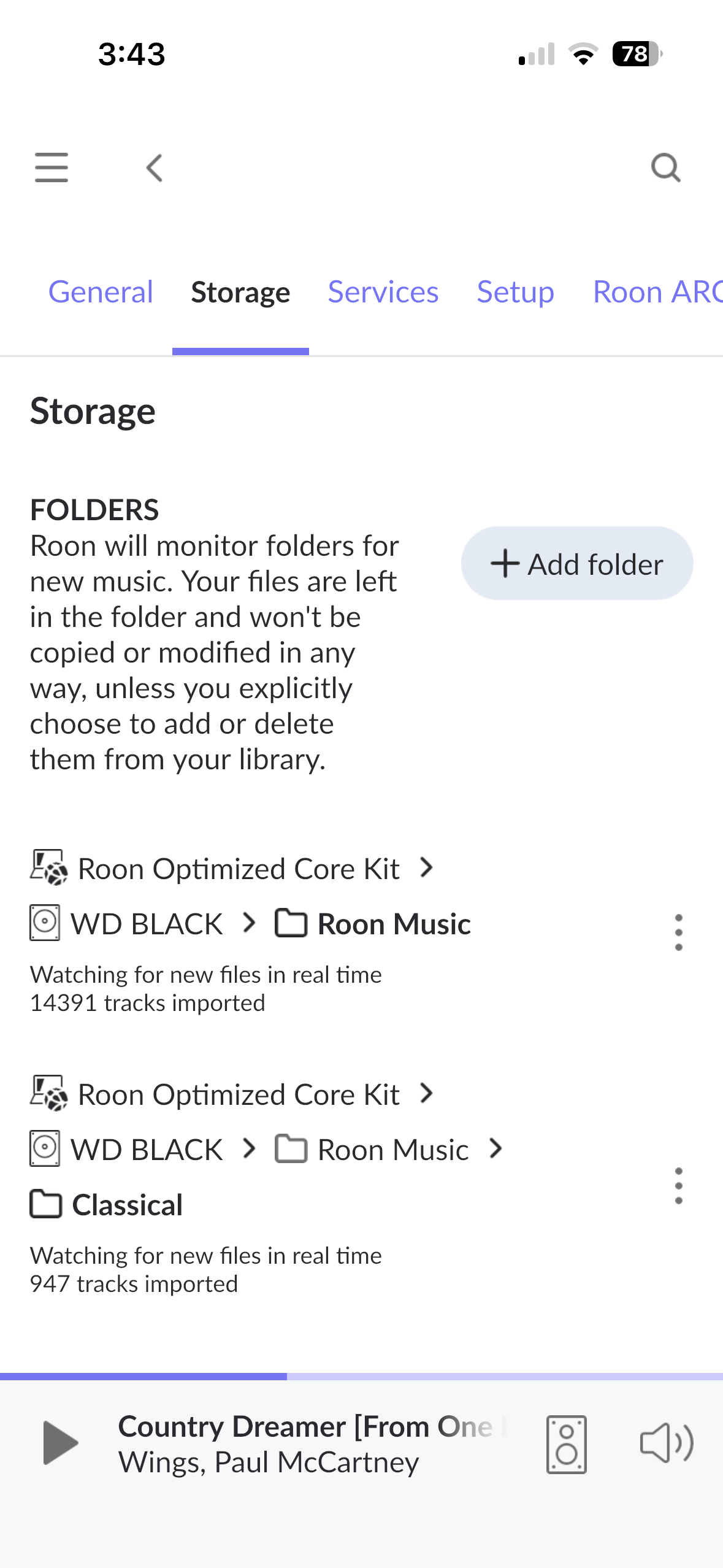

I have a Seagate external hard drive. My NUC was reading it along with a WD Black drive. It suddenly stopped recognizing it.

I bought a new external hard drive and formatted it as exFAT. The Roon server is reading it!
