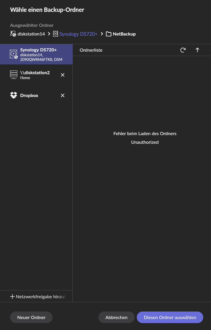

Hi, That’s right, that there is a “Roon Backup” Folder, too. But I have no clue how he gets there.
If I try to select the folder in Roon, I get an error message like this:
But I had no chance to select any user or enter credentials to proof my authorization.

Maybe @crieke or another Synology user is able to help youn with setting the correct permissions.
