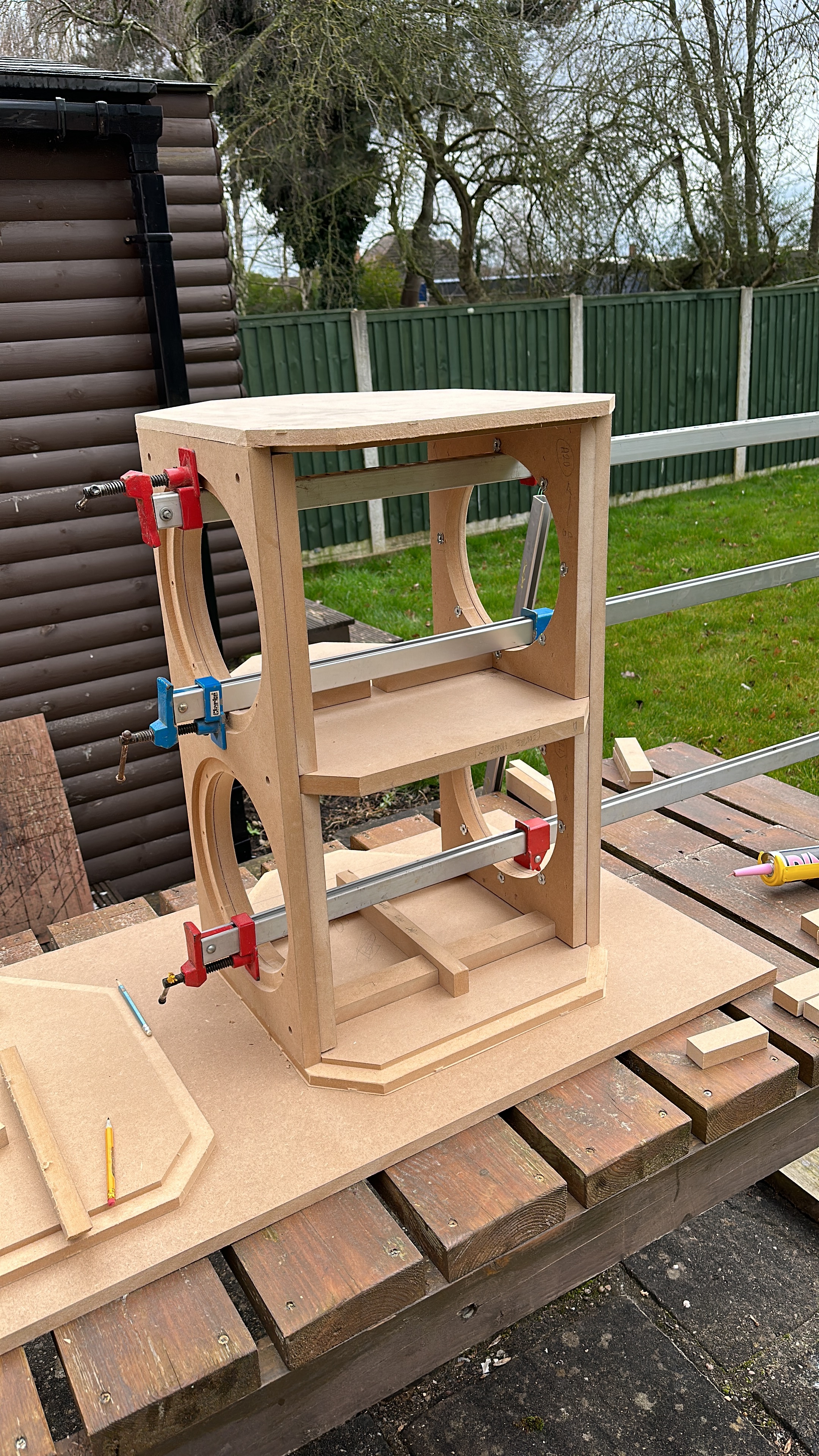

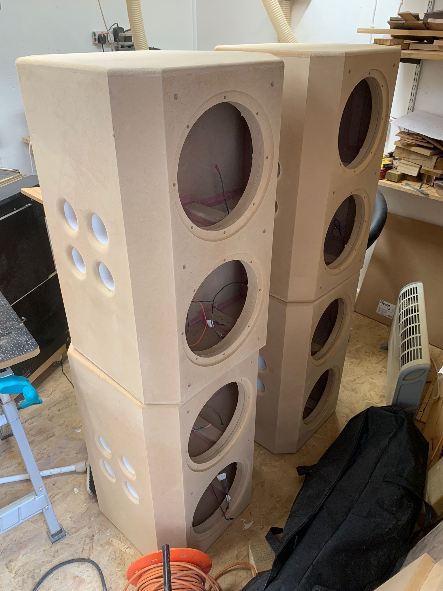

I’m building some new bass speakers
4x 10” drivers in each cabinet

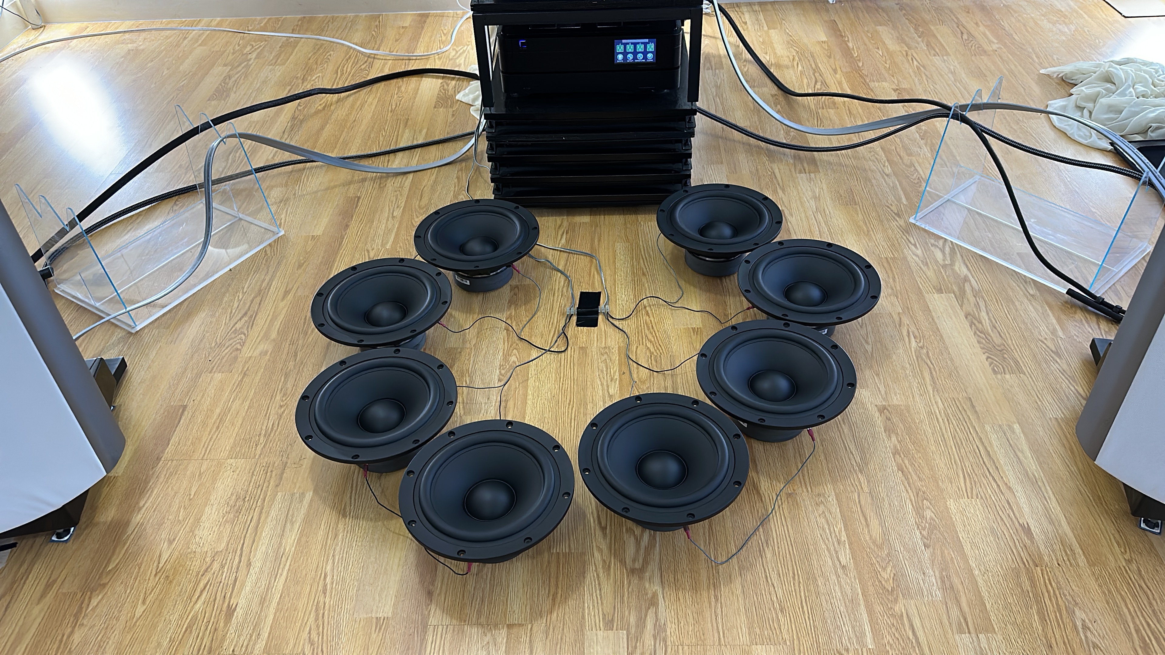

:point_up_2: I ran the drivers in for 7x24 hours like that, out of phase and running a 20-100hz sweep alternating with a 5 min pink noise tone
I could run them at what would have been VERY LOUD MAN!! :grinning: levels without upsetting my other tent dwellers

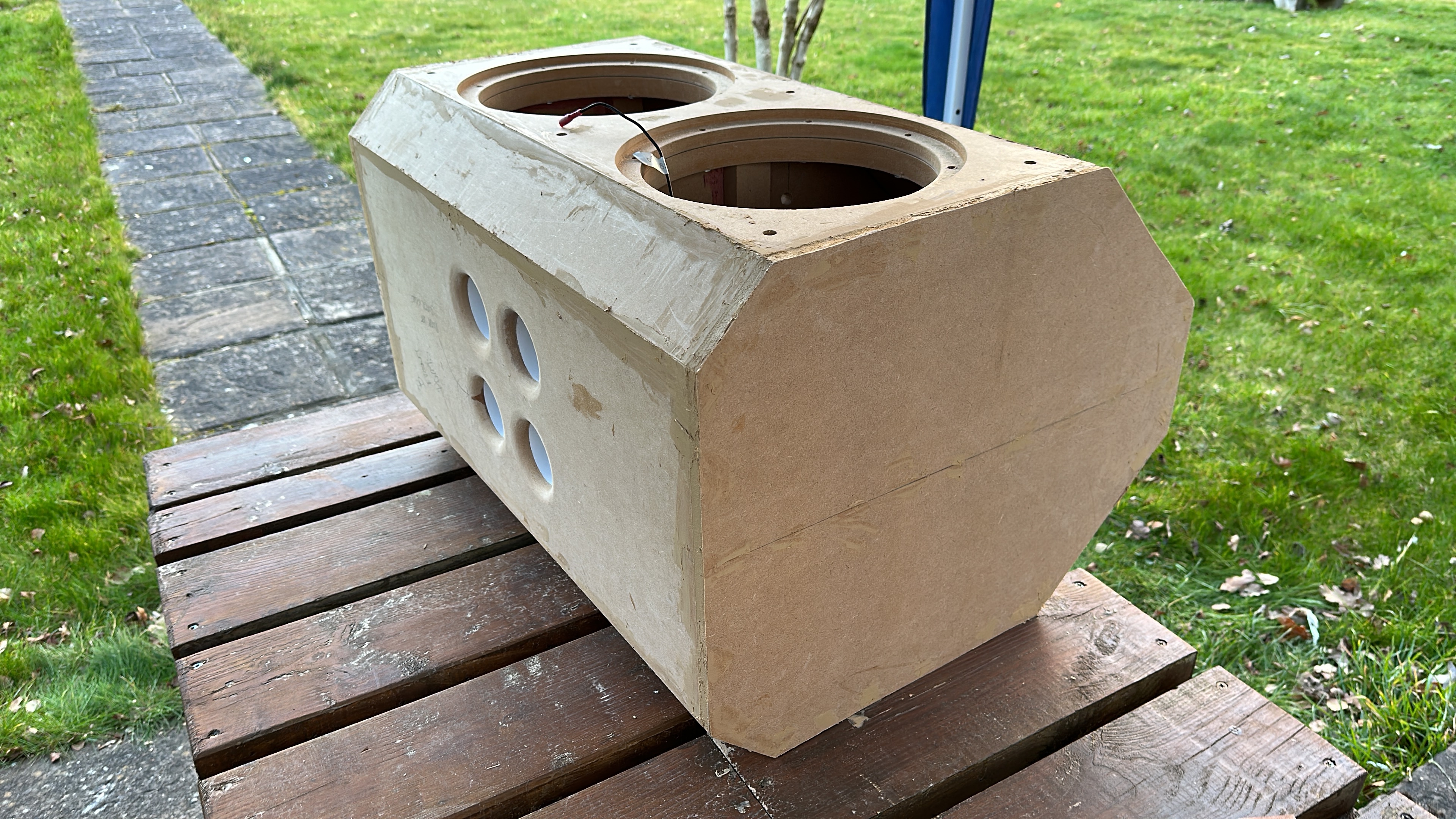

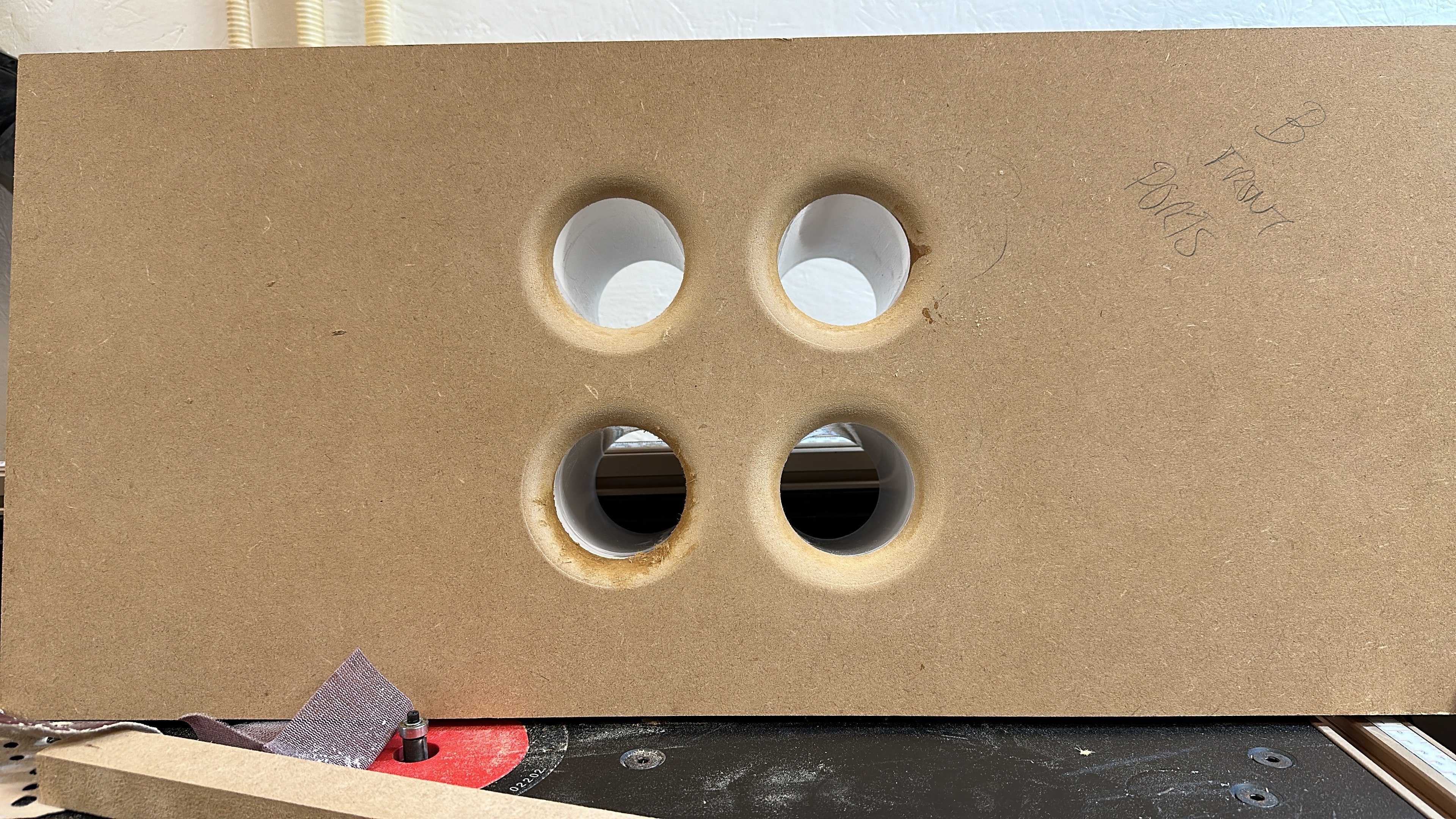

These are the original TacT/Lyngdorf W210 bass speakers - sat on top of each other to emulate the W410s - which are something if a unicorn product. I’ve been looking for photos etc for ages, but no luck
I’ve had the W210s for 12 or more years - they’re excellent, but I always fancied those W410s… :thinking:

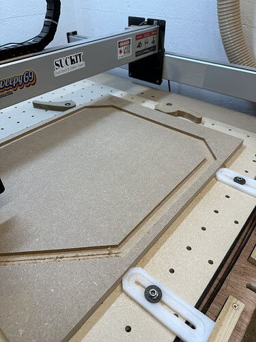

My friend has an excellent workshop with loads of tools including a CNC router. He also runs a Lyngdorf 2.2 system and has been looking for some W210s for years
Finally, in January, we committed to build some W410s for me and some W210s for him
I have W210 plans - but they’re slightly different to the actual items. The Vifa drivers are no longer available, but we settled on some SB acoustics drivers. Since this was a ‘fantasy’ project, we improved on the original cabinet design by doubling the baffles to 44mm, adding damping compound between sheets, adding extra bracing, extra joint sealant etc etc
We chose Audioquest Rocket 22 for internal wiring with WBT silver solder and Wilson Audio SST contact enhancer
The W210 idea was quickly dropped- he also wanted W410s :sunglasses::+1:
Like kids at Xmas we couldn’t wait to load and fire up the cabinets before they were painted…
The result…
‘Kin Ace!!
Bass, naturally, but the heft and slam that can only come from physics

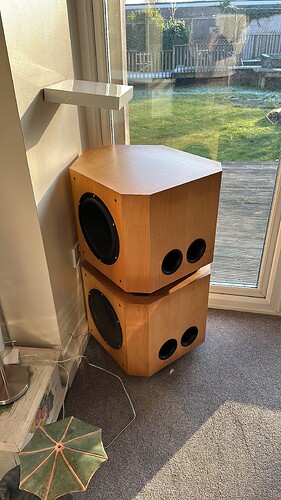

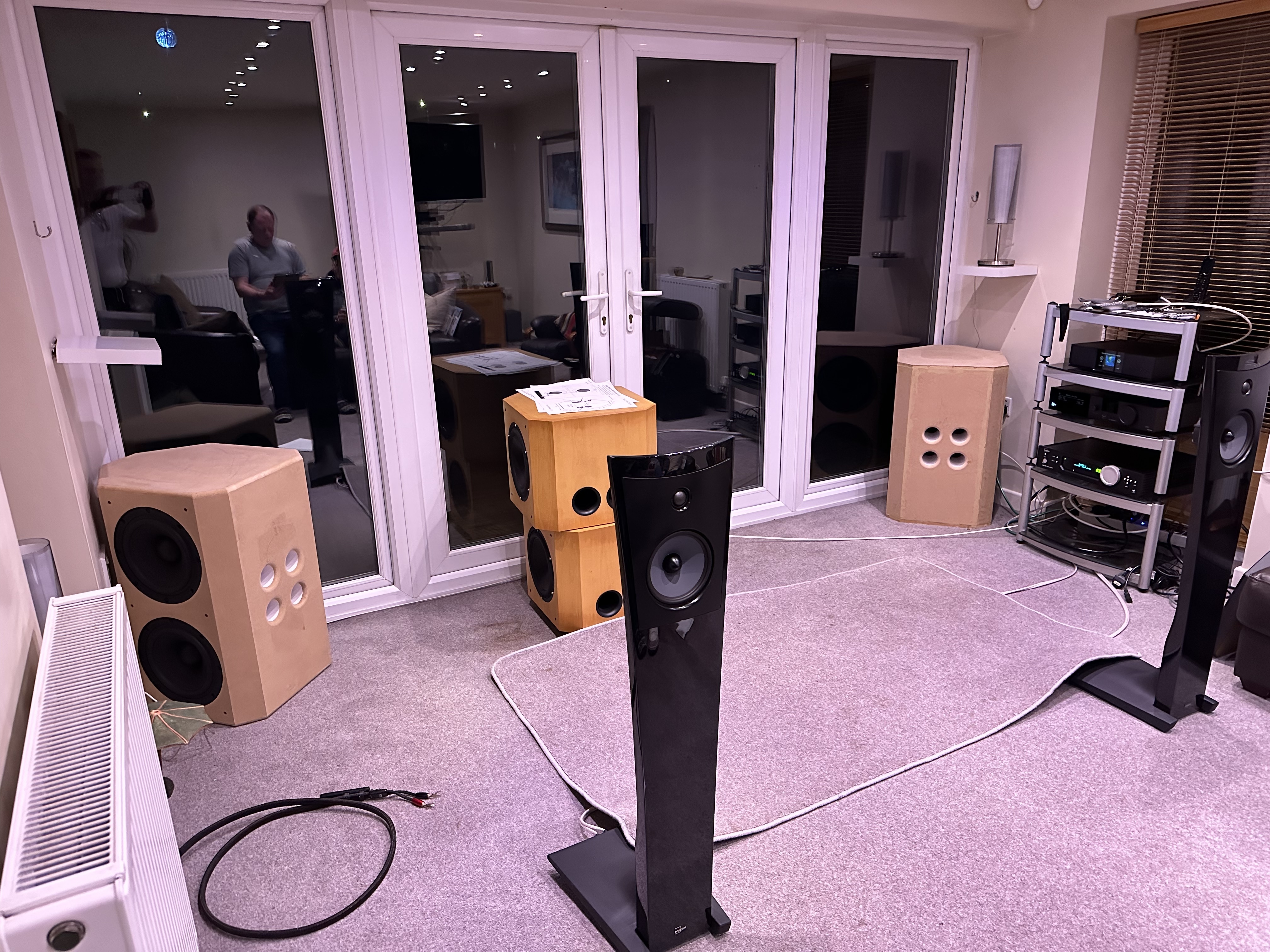

Following RoomPerfect; the integration is superb, the dynamics - eye popping, the slam - chest thumping and the extension - trouser flapping

They’re due to be painted on Monday, a friend of mine has a car repair garage and he will finish them in satin white
As all four W410s, plus my W210s will be on hand, of course (kids at Xmas…) we’ll be rigging up W810s…
… and we’d be daft not to try W1010s :nerd_face::+1:
