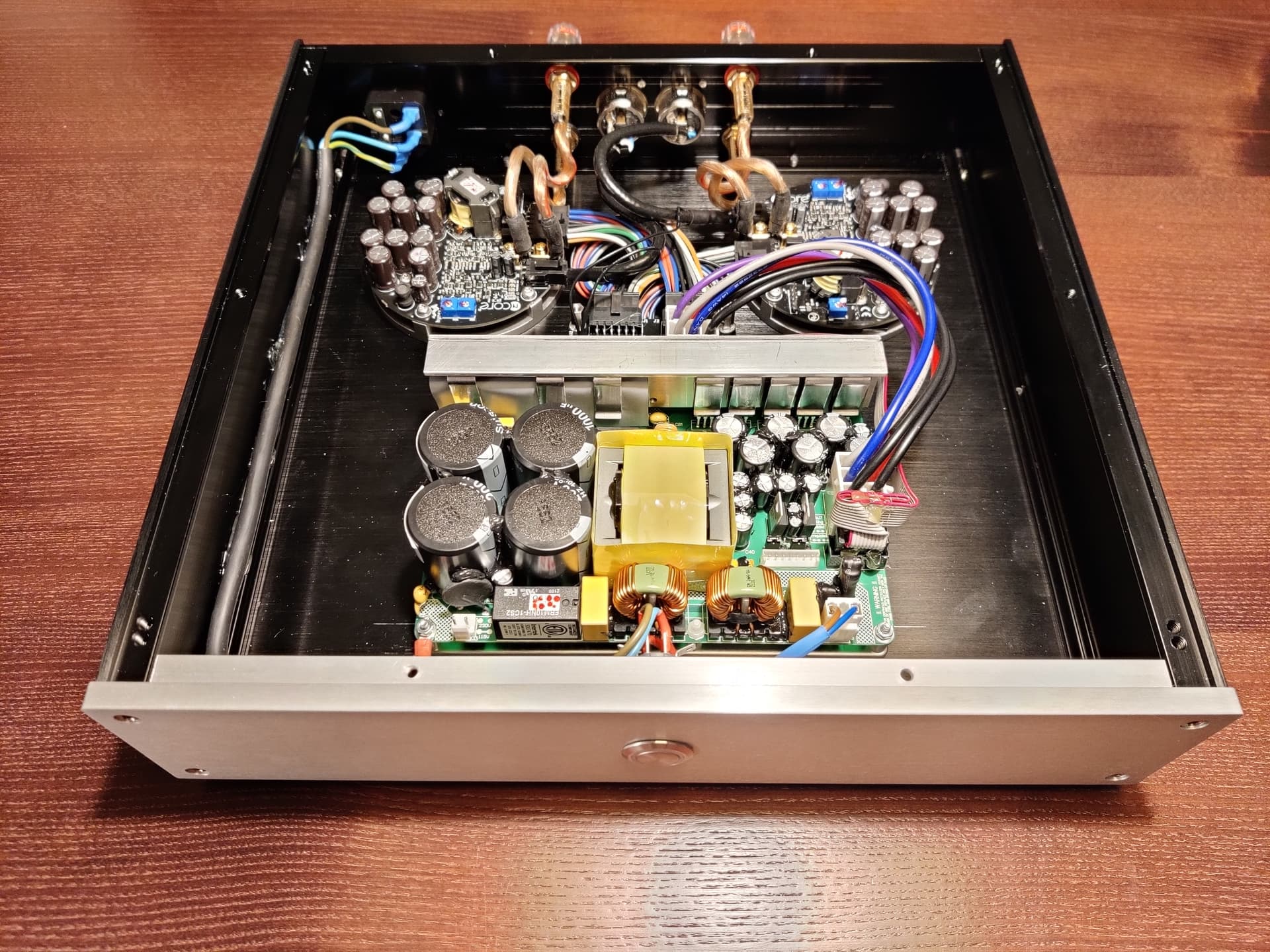

Finally wrapped in new clothes and running nicely - awesome grip in the lower registers with liquid mids and pristine highs, no matter at what level.

That’s a very neat and tidy layout.
I was surprised by what appears to be a smallish gauge cable from the IEC to power supply. It may just the photo. Do you know the size of the conductors?

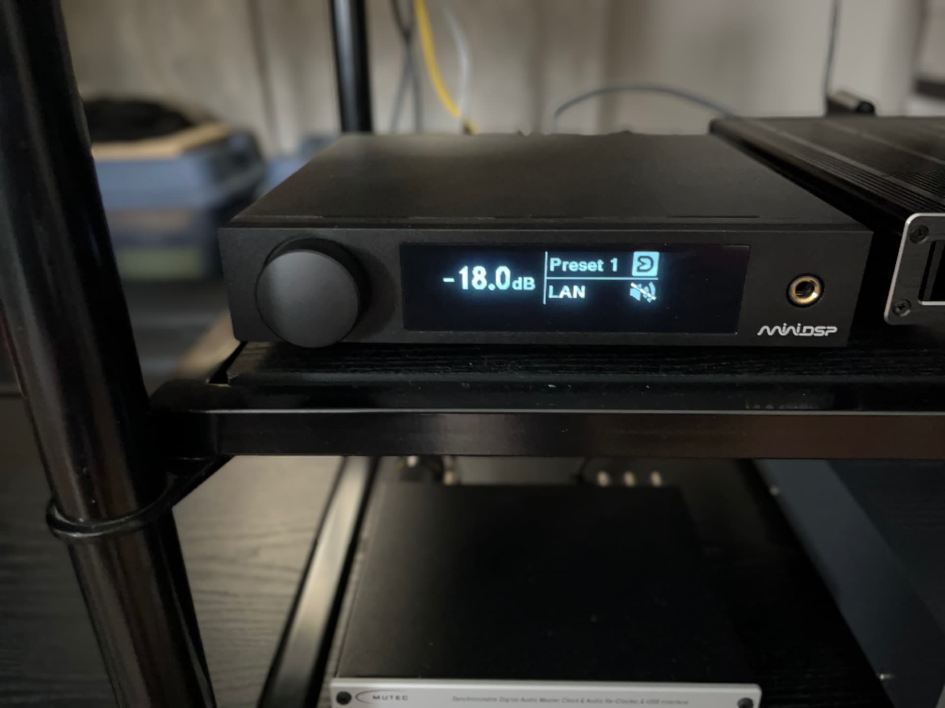

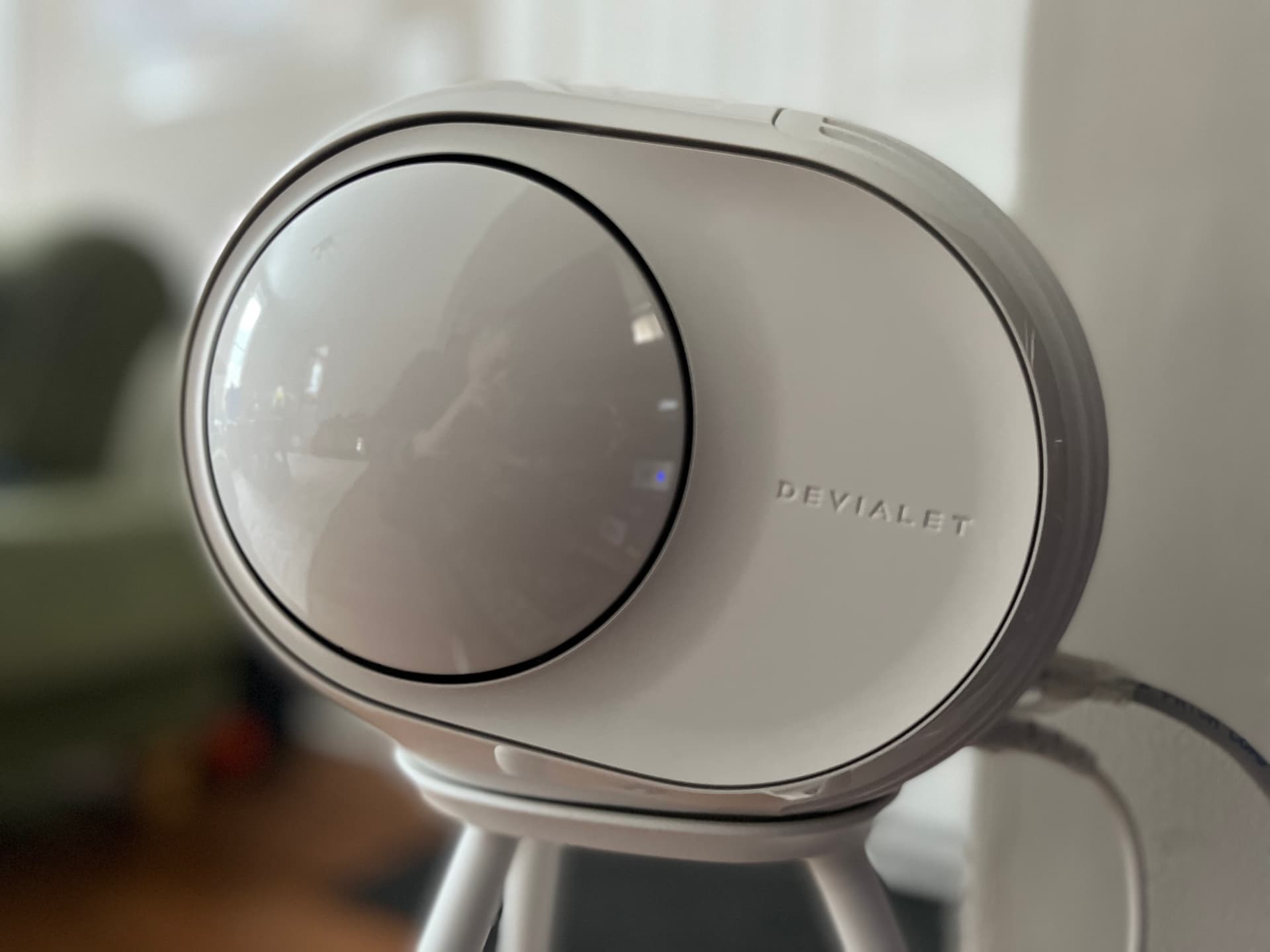

Update: Image refresh Feb 5th. Better photos of the gear.
Hi Folks… I’m enjoying seeing your audio setups. So many great rooms. I’ve finally gotten around to taking some closeup pics of components in my setup since moving into the new house last autumn.
This is pretty much my end game system for the new space. Some of the components are quite modest, but as a whole the setup sounds beautiful. The power conditioners were pieces I already had and I couldn’t justify spending $$$ on upgrading them. I put those funds towards the newer components. Technology has come a long way the past 10 years. Because of COVID and moving to a small town, this is the first system I assembled by ordering components online from Canada, France, Germany, Hong Kong, USA. I live in Canada. Has been an enjoyable trip.
If I can answer any questions feel free to ask. Cheers.
Power / Signal Path:
APC H15 → Mistral Audio W-3900 → Custom Roon Rock Server → Silent Angel Bonn N8 → miniDSP Studio → Mutec MC-3+ USB → Devialet Phantom II 98dB

from the picture, i’d say that the ones from the ps pcb near the power switch to the output stages are 14awg (you can read it), and thus that the iec socket to ps pcb/pwer switch are 16 or even 18. probably totally adequate, especially if the power rating is 50W or so, but yeah, maybe ‘smallish’. fwiw. looks great in general, though, nice job. seems efficient in the runs and good section separation. what do you call it? :smiley:

AC wiring is 1mm² (~18 AWG), good for up to 16A but fused for 5A.
Power supply to DC splitter are 14 AWG (~2mm²) doubled up, good for up to 25A each.
DC splitter to amp boards are 18 AWG (~1mm²) doubled up on plus and minus legs with ground quadrupled, good for up to 16A each.
The amp is rated for 2x580W@2Ω, 2x400W@4Ω, 2x200W@8Ω.
AC wiring is more than adequate while carrying 5A@240V@1200W power supply max specified power.
:electric_plug:
hahaha! excellent. didn’t even think about them doubled up. of course. nice. 200wpc/8Ω, sweet.
