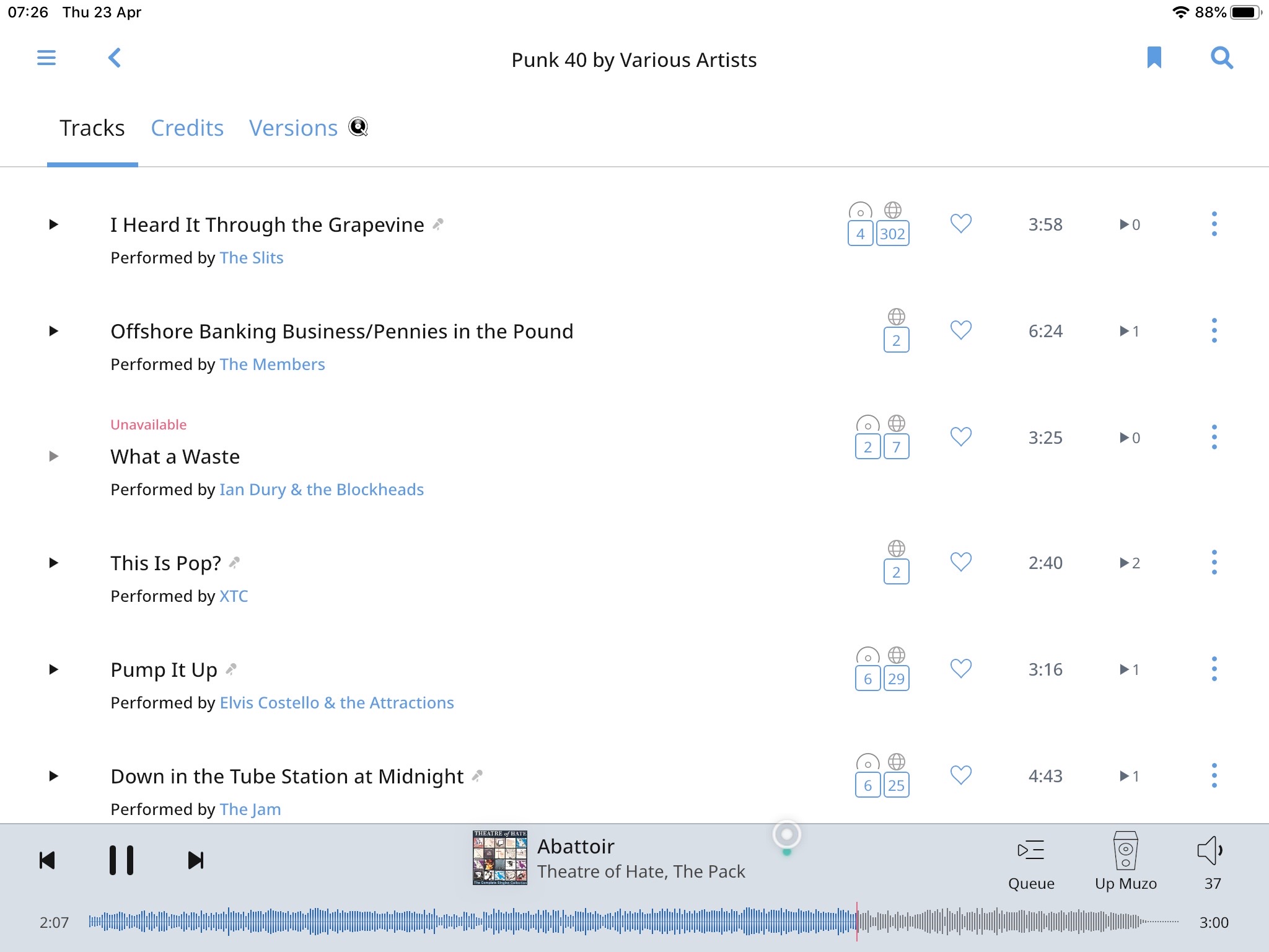

Firstly I build a queue of songs to listen to by selecting like or dislike from the shuffle. Alas, the system often skips many songs. See picture. This seems to happen when I build long queues. So I keep my queues below 50 minutes and that limits the problem to once every few days.

If you press expand on the skipped items, what do you see there? Are those local tracks that were skipped or tracks from TIDAL?

Looking at my latest skip events, there is a mixture of local (uPnP) tracks and Tidal. From a small sample, the first track skipped in each case was Tidal.

Big breakthrough. Queue skip just happened. I went and looked in detail at the first song skipped. It show Unavailable in Tidal!!. Who knew such a thing existed? Looking back this seems to be the pattern. So it would be nice if Unavailable tracks didn’t come up in Shuffle. Or at least that not the whole queue is skipped; just the Unavailable track. Feel daft that I didn’t spot this before.

The current way that Shuffle works is that Roon adds all the tracks you select to the queue.
If the track has been removed due to TIDAL themselves (due to copyright/licensing agreements/ect), this is not something that Roon can pick up on at the present time.
I would suggest you make a feature request regarding this use-case and provide your feedback in that section of our website. Thanks!
Roon shows it’s unavailable so maybe it can pick it up…or is that magic?
Just need to show the unavailable status in the shuffle window. Or just miss that one song out of the queue. Or not put it in the queue to start with.
