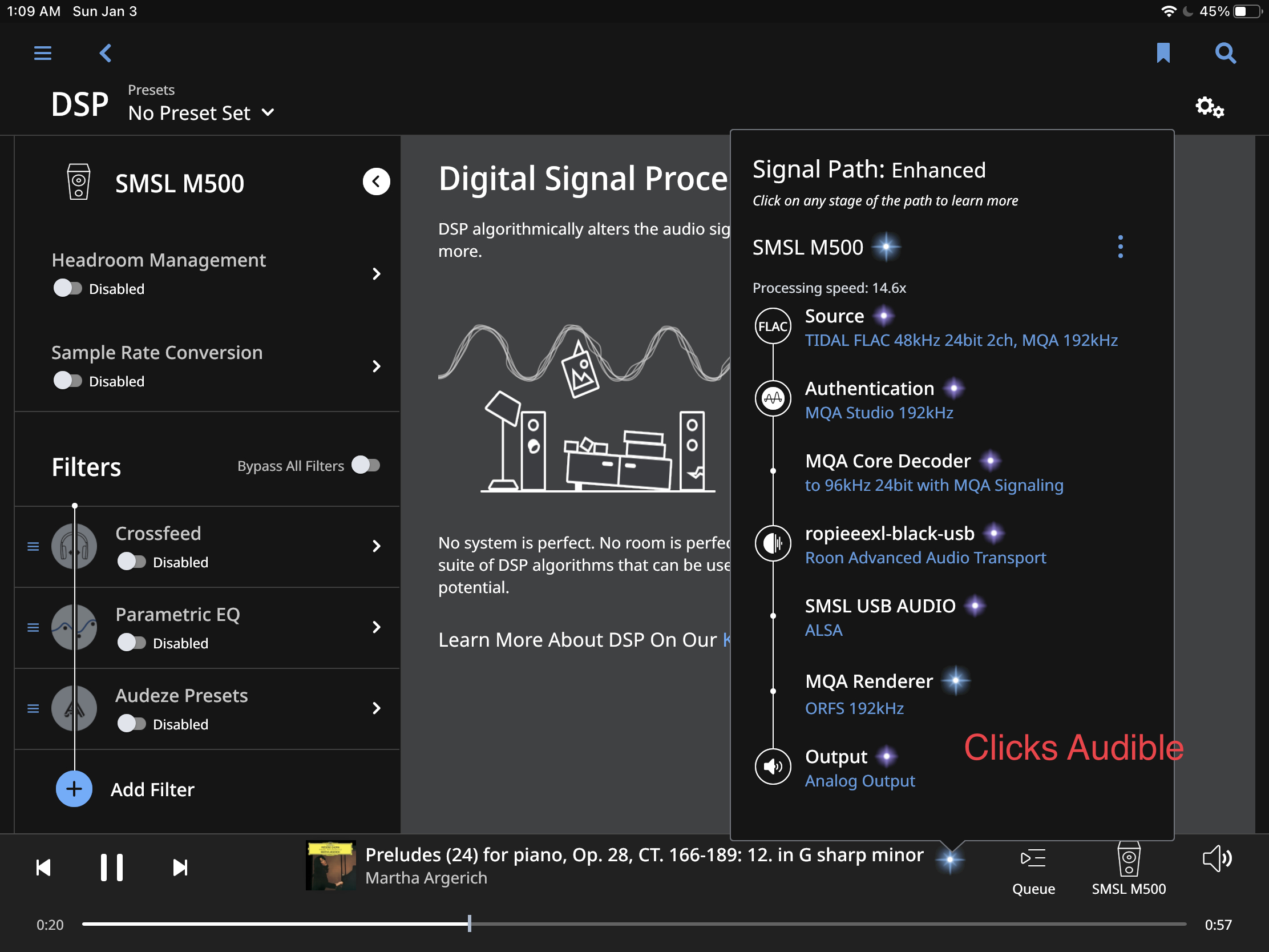

Thanks all. I did remove DSP (had been using binaural), and changed SMSL to renderer only. Unfortunately, unlike @Andre_Gosselin I still get it within a single MQA recording - so for opera or something else gapless it’s kind of unlistenable.
Do you mind if I ask what version of firmware you are running @Dominick_Puccio and @Andre_Gosselin? Mine is listed as software 1.7 and HW 1.3. The only firmware update I can find on SMSL’s site is for the M400.
For what it’s worth, when I look at the signal path during a track change, under “authentication” the blue line that says “MQA Studio 192kHz” blinks out and then back on, and the time that it is out seems to correspond exactly to the time that the pops/clicks/cutout happen.

Well, I’ve gotten somewhere. I turned off the core decoder under advanced, and set it to be a decoder and renderer, and now I’ve gotten it to the point where I hear the pop/click only when a new MQA format starts or ends but it us gapless/silent between tracks in the same format. That’s a lot better, and while not perfect I can live with this for a while.
Except… that meant i was skipping the final unfold. So that’s NOT going to work. Back to the drawing board.

Next, I can get the M500 to have that signal chain if I set it up as “decoder and renderer” as you have. And when I do, I get no clocks or pops. But the “dot” next to “MQA” on the m500 display is then blue instead of magenta. And for some reason I thought the “goal” was for it to be magenta, where it is just doing the final unfold. I can get it to be blue (as you have) no problem. But is that the right state to be in? If so, I’m home free. I find the documentation super confusing on this.
Below is the signal path I have, and what I thought was the “correct” one with Roon core doing the first unfold.

I thought I read that if the DAC hardware supports it, let it do both Decoding and Rendering. The SMSL M500 supports both. Moving the decoding to the DAC takes a processing load off the core. Which also is positive.
Also, my understanding is the blue light you are looking for is at the track level not necessarily at the DAC stage in the signal path. Look at my last image. You will see a blue dot right after track. “Precludes (24) for piano, Op 28, CT 166-189” also see the blue dot next to the endpoint Ropiee Family Room. My M500 also displays MQA which verifies it is processing an MQA file.
If I play these files on another non MQA endpoint I get a purple dot next to the track and endpoint name. Hence not the full MQA experience.
Note, if you employ DSP you will not see the blue dot. I suggest thinking of the blue dot as verification of MQA not necessarily of the best sound. For some people using DSP has benefits. For example, overcoming speaker or room issues. But if that is done you will never get the blue dot at the track level.

@Johnny_Ooooops set the M500 to Decode and Render and you should be all set.
Wow, that all feels very anticlimactic - many many thanks to all who helped. I had thought that I was “chasing the magenta light” (on the DAC, not in the signal path) but apparently that was where I went wrong!
