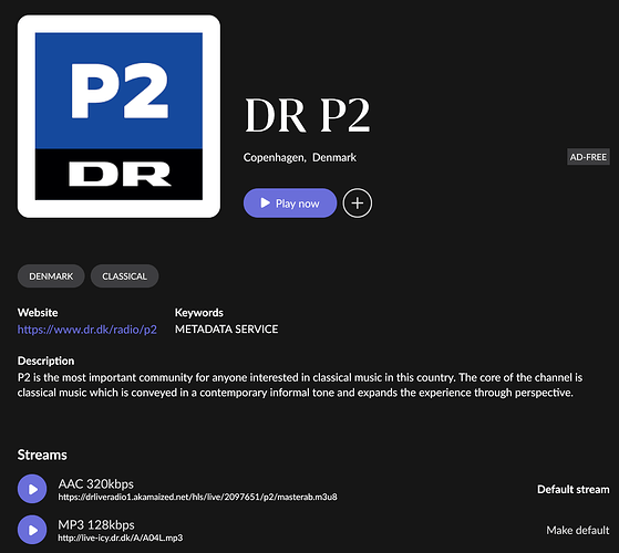

A test from Hamburg (Germany)
Torben
@Torben, how are things for you in Germany? Do you experience that the streaming stops now and then? The screen dump you show is how things look now, and as I understand it, even when you select AAC 320kbps you get MP3 128kbps (as a workaround to the Roon-specific 30 minute delay of the AAC-stream).
[EDIT: I got this wrong, the streams still play what they are supposed to, cf. BrianW’s answer above to my earlier mistaken post]
This is what I get when I select AAC 320kps:
Torben
PS: If DR2 stops now and then is hard for me to say. I don’t listen that much to the sender.
