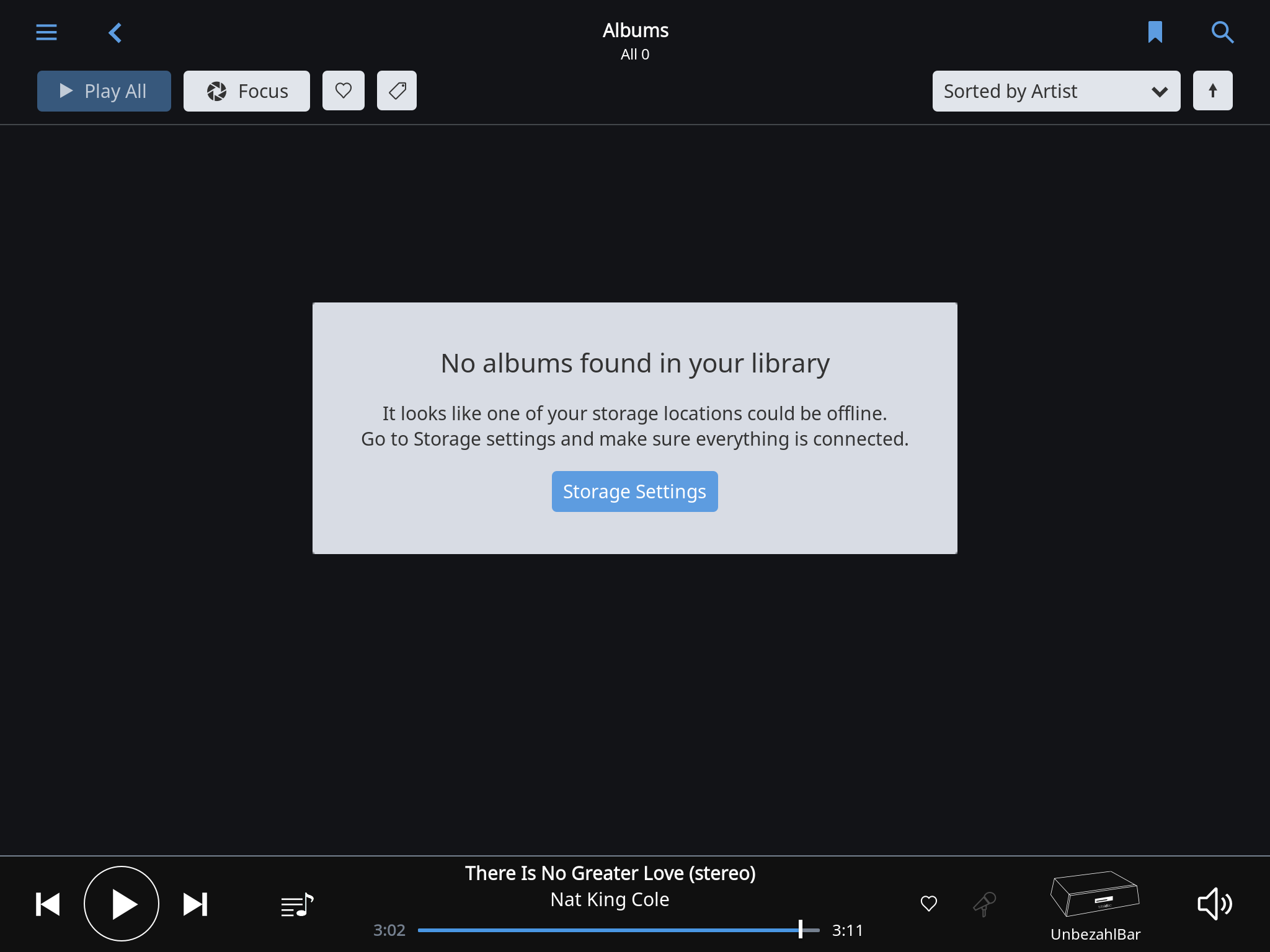

Roon on Sonic Transporter stocks with getting data from NAS “Operation in progress” but nothing happens, see screenshots below. Also miss button “force rescan”. Server on my PC works with outs hiccups. Restarted ST, Roon Server, Roon App, nothing helped.

The logs are saying the mount has failed. This could happen for a lot of reasons. Your URL for the NAS could be wrong or you may have entered an incorrect username and password for the mount.
Roon support should be able to help you with this.
You might try using the IP instead of the name like smb://192.168.xxx.xxx/.
Nothing wrong with NAS URL and/or username/password. Also IP address instead of NAS name doesn’t help. Everything is unchanged and correct, Roon Server on PC has the same mounts and it works.
Any other hint?
I know this can be frustrating but if the URL/user/passowrd is not perfect it won’t work. Maybe Roon support can help us. @kevin helped some other users here.
@kevin any ideas one what else to try?
Guys I don’t know why but the router restarted itself and its working again now. It looked to me as an ST issues as everything else on the net including Roon Server on my PC worked well.
Sorry for bothering you and thanks for your replies.
IT sometimes is very foggy…
