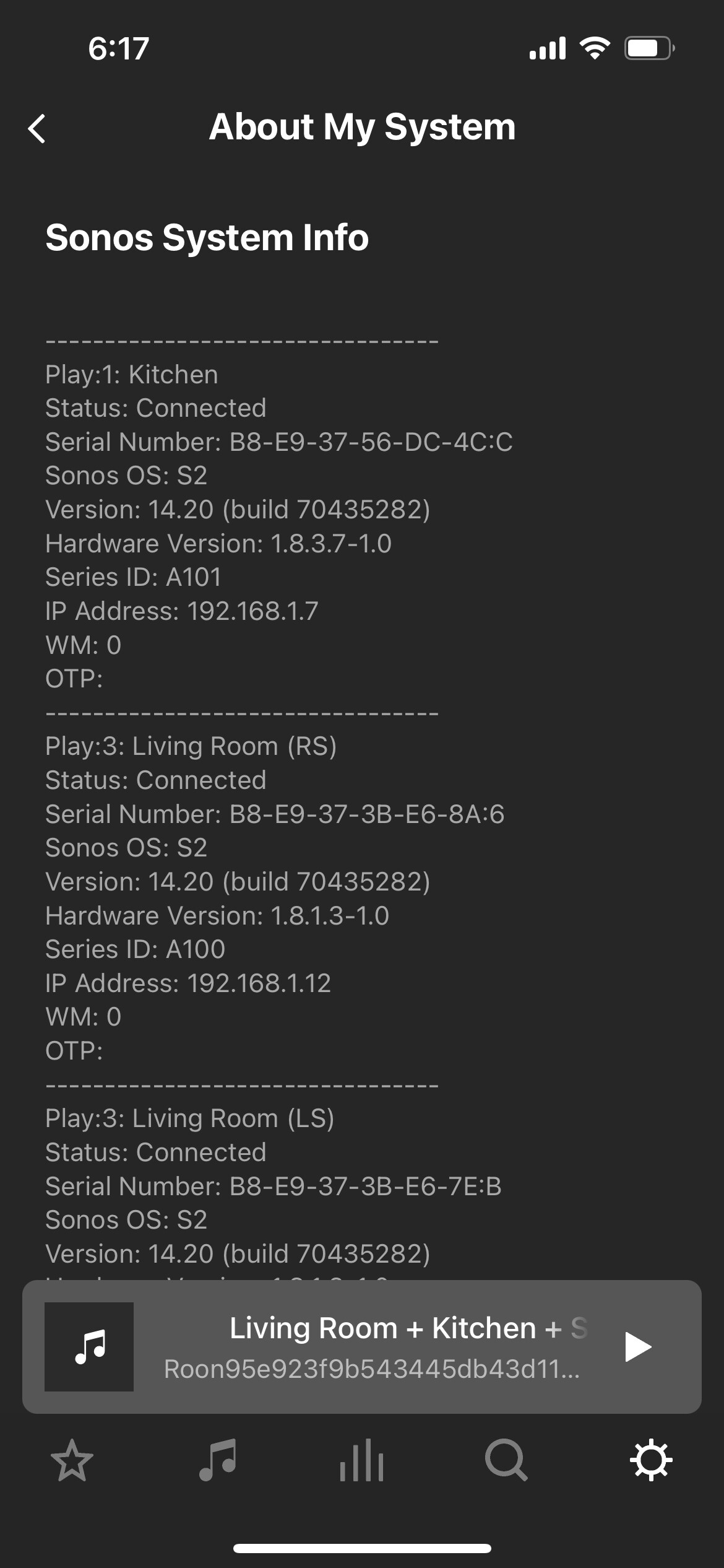

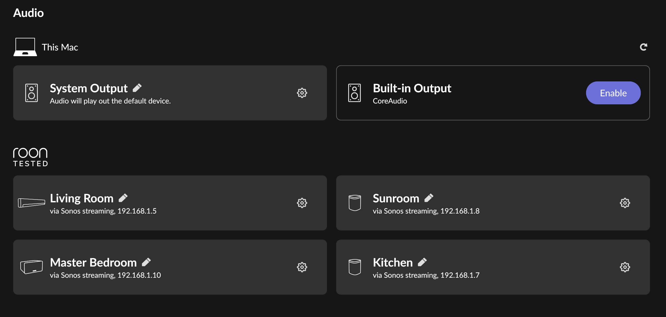

Would you mind providing a screenshot of what Settings>Audio looks like for you before you try unplugging anything. I’m curious to see how that looks. Here’s what mine looks like with all my devices using SonosNet. Yours will look different I believe since you’re also using Airplay.
Would you also mind taking a screenshot of what Sonos>About My Sonos System looks like for you? Here’s mine using the Mac app for as many of my devices as will appear on one screen. Since you only have two, that won’t be an issue for you.
You could also use your phone or iPad Sonos app if that’s easier. From my iPhone:
Also, what version of the Sonos apps are you on? The latest is 14.20, which came out sometime recently. Are you on the same version on all your devices.
P.S. There was also a device firmware update as well, so if you didn’t process those, that might be playing a role here. But first, take those screenshots as that will show what firmware your devices are currently on.
