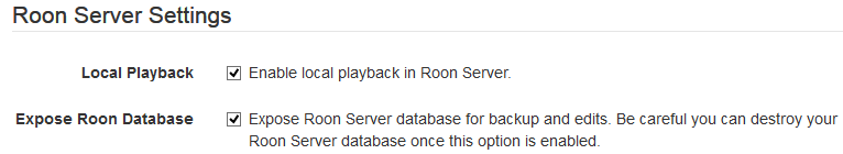

Can you be more specific on where I find these logs? My Core is an Antipodes server and I use Mac OS X devices (Airbook and iMac).
Hi @Joe_Kenney, if you go to Settings/Roon Server in your Antipodes GUI, you can click the option ‘Expose Roon Database’:
This will cause the Roon Database directory (folder) on the Antipodes to show in the shared network view of the Antipodes in Windows File Explorer or OSX Finder:
I believe ‘Logs’ is the directory/folder that Roon Support needs in zipped format.
