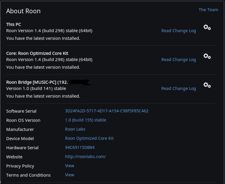

@Eric – just to be complete, added shot of software versions.
