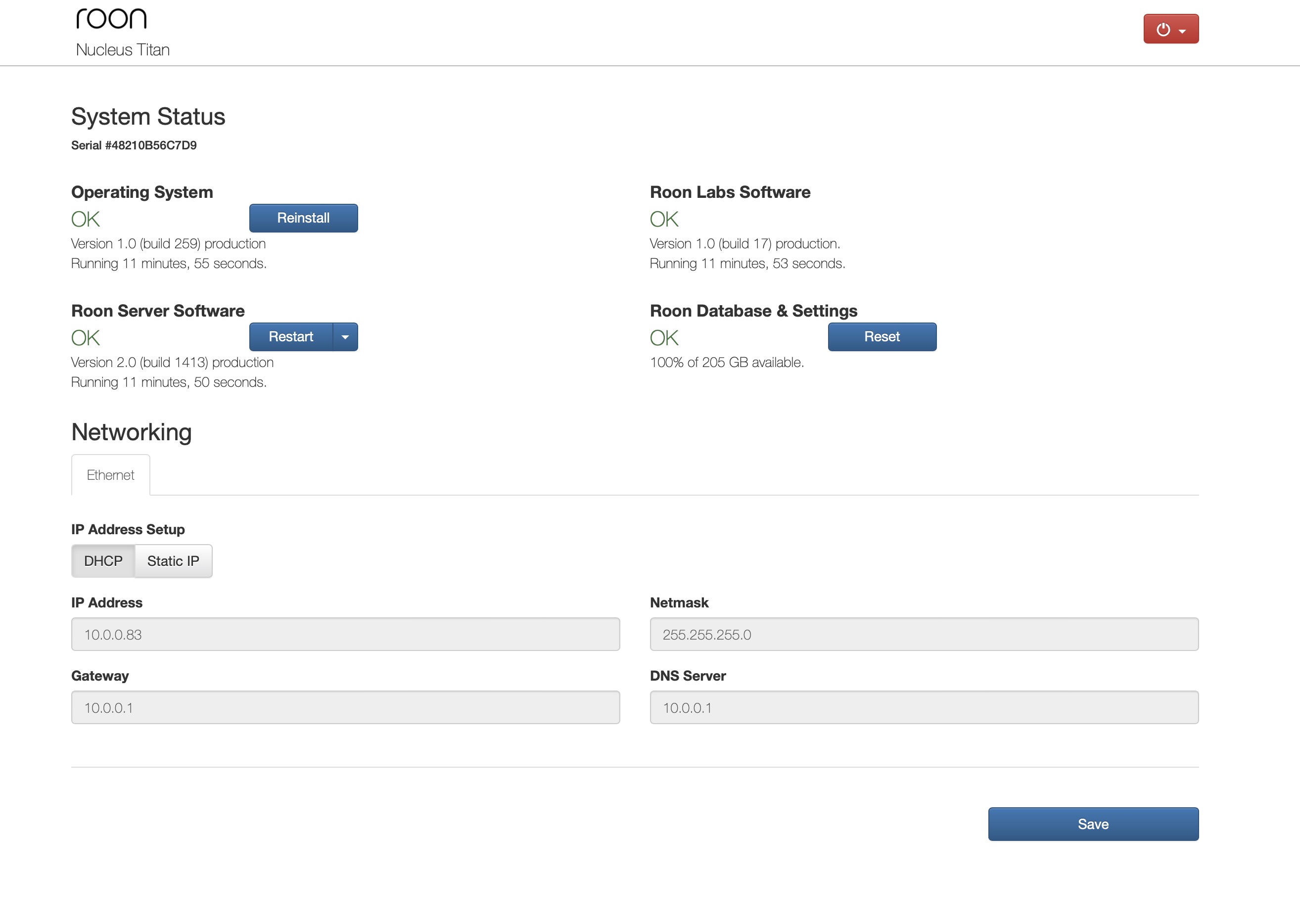

Your drive is not being seen.

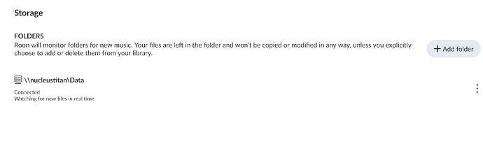

You have a weird storage setup where you are connecting to the Data share on the Titan via SMB from the Titan itself. It’s a useless loop, and you should remove that storage location in Roon. It’s not helping you and possibly causing unneeded troubles. I’m sure you got into this situation trying to find the built in storage.
The real issue you have right now is that your storage is not being found. When it is found, you should be able to go the web ui and see something like this:
Until that happens, you won’t find it and diagnosing it in Roon will not be helpful.

I don’t know where that Data directory came from, it’s not something I added.
I’ll take a closer look at the able now.
I’m sure it got added while you were trying to make it work… it’s ok, just remove that storage location and nothing bad will happen.

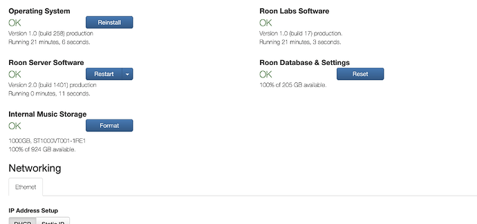

I here’s a test N+ I have on the network here with some storage. This is what the built in storage will look like if it exists (and is found properly):

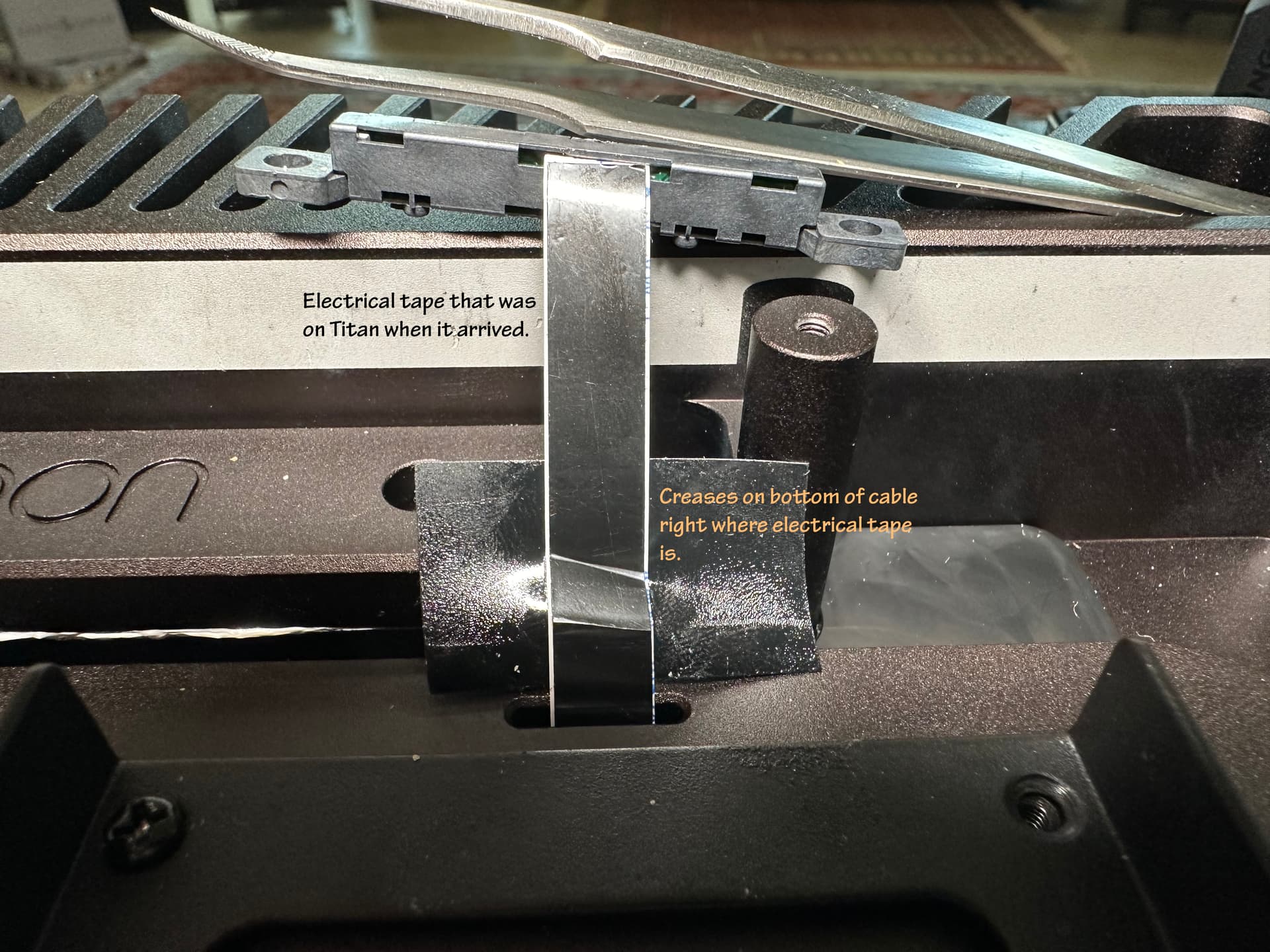

I looked at the the ribbon closely. The end that goes to the processor board looks ok.
The ribbon to the drive does not look good to me. The top of the of ribbon appears to have a perfectly straight cut in it… you can see the conductors through the cut.
The bottom of the ribbon to the drive has some creases in it. The electrical tape was on the ribbon when I got Titan. It is in the area of the creases.
My guess is that the ribbon is the problem. If there are some other things I can check let me know.

I took some photos of my pre-production unit here, which is similar to the production unit, but with some minor differences internally. My phone has a macro lens mode, so the photos are really clear.

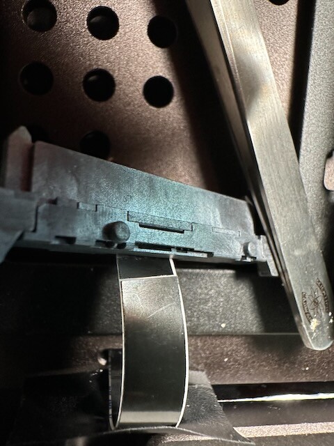

Creases and bare spots are normal, but cuts are bad! Can you take a closer photo of what you see as a cut?
Yes, be right back
On the image, near the straight line, I think those three small pips(zoom in close) are conductors showing through, I think. You can also see that the tape?? over where the connection is made to the connector looks bumpy.
After taking the picture I moved the drive connector to try to get some better light on it and the connector just fell off. I didn’t tug is or anything, it just fell off.
