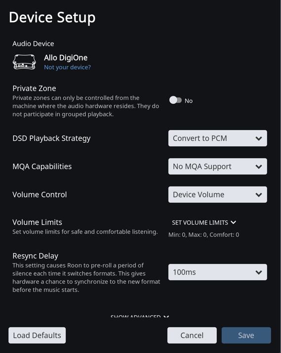

Lyndon, I have a similar setup (Digione and Yggy) and it too had dropouts. Starting with v1.5, these have become a thing of the past for me with Roon’s auto-configuring of EndPoints. My only added setting was to add 100ms delay for the Yggy to switch gears if playing different quality tracks. Here are my settings FYI:
and the advanced stuff:
Hang in there!
PS: One last ‘hail mary’ thought: log out of and in to TIDAL from Roon.

My drop outs seem to have started with v1.5…
I added 500ms of delay; but might try 100ms just to see if that makes a difference.
I’ve also put in some buffer in the “buffer size” advanced setting.
Also tried logging in and out of TIDAL from Roon.
Thanks again for the advice!!
