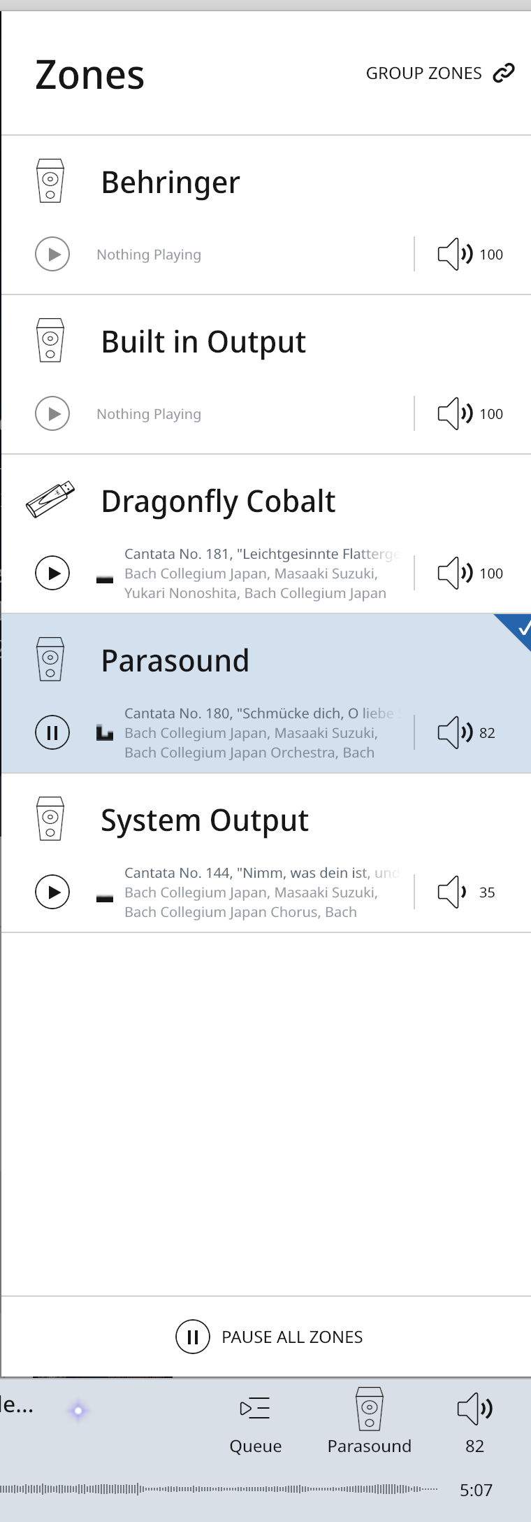

I guess I’m a little confused that switching a device (= switching a zone) as you showed me, can result in ‘Nothing playing’ in the list of devices.
Normally, you would only play one album or track to one zone or device. You would want to see “Nothing playing” to all zones except the one you are listening to. As a matter of fact, you want to make sure nothng is playing to any other zones or you are unnecessarily using resources. When I finish listening, I make a point to ensure nothing is playing to any zones when I shut down my Roon control app. I don’t want my Nucleus streaming from Tidal or Qobuz to some zone I can’t hear all day or night.
This is what I see:
Other zones are paused, which is good, isn’t it?
Maybe I can assume that it says, for instance, ‘Nothing Playing’ for/in Behringer because I haven’t so far switched there to output any track to it?
And that Roon remembers which music has been directed to which Devices?
(As you can see, still learning… :slight_smile: .)
Yes, Roon will keep playing to a zone until/unless you pause that zone. Roon will remember where you paused it unless you click on Queue and clear it. You will only see the bars jumping up and down if Roon is playing to that zone. So, you only want to see the bars jumping up and down for the zone you are listening to. The other zones will show where you previously paused them or will show “Nothing playing” if you never played that zone or cleared the queue for that zone.
