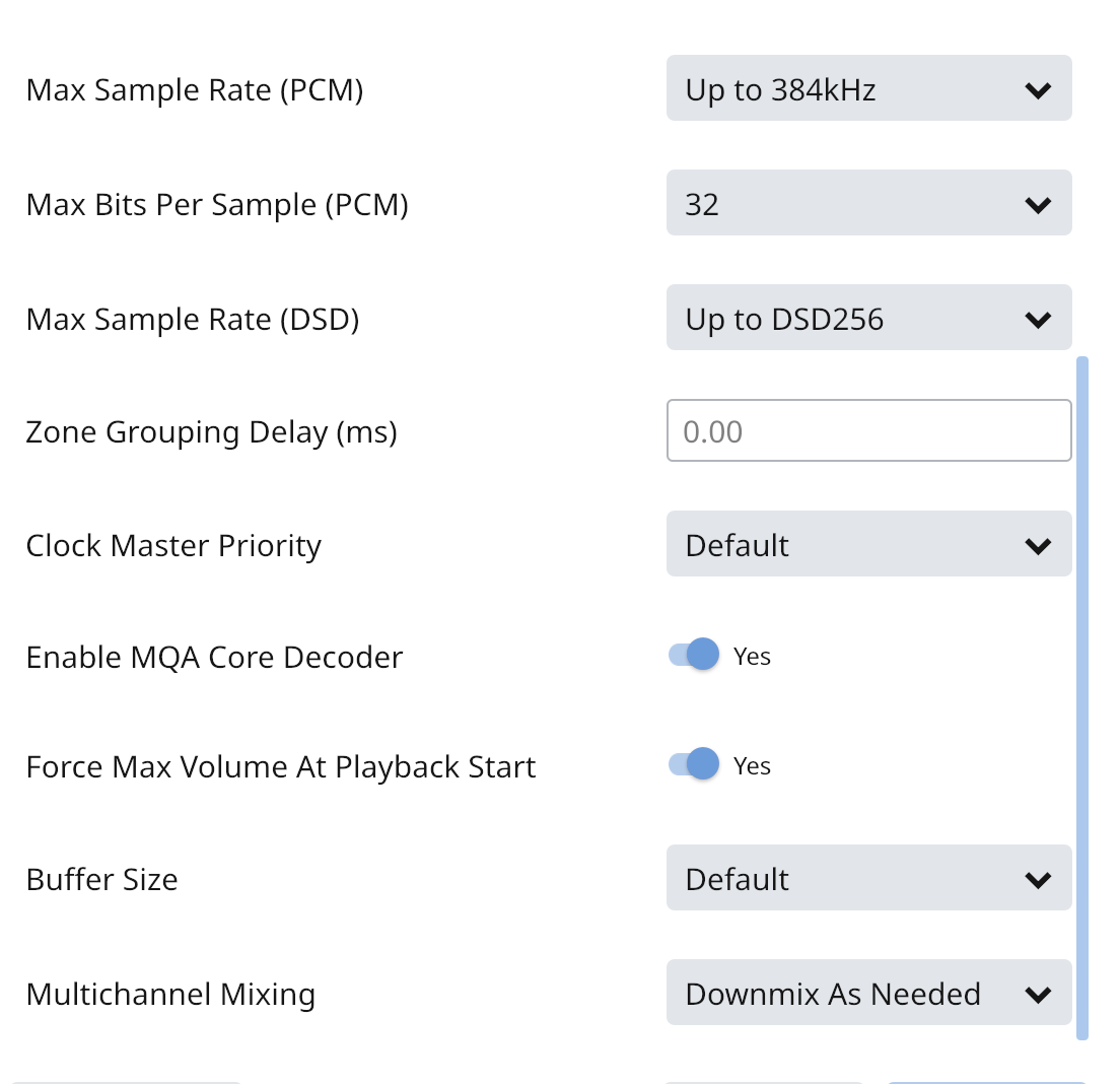

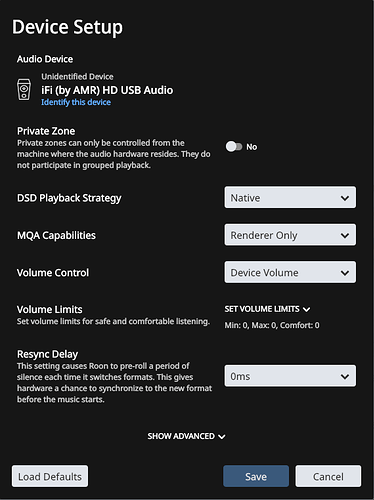

Are these settings you use than?

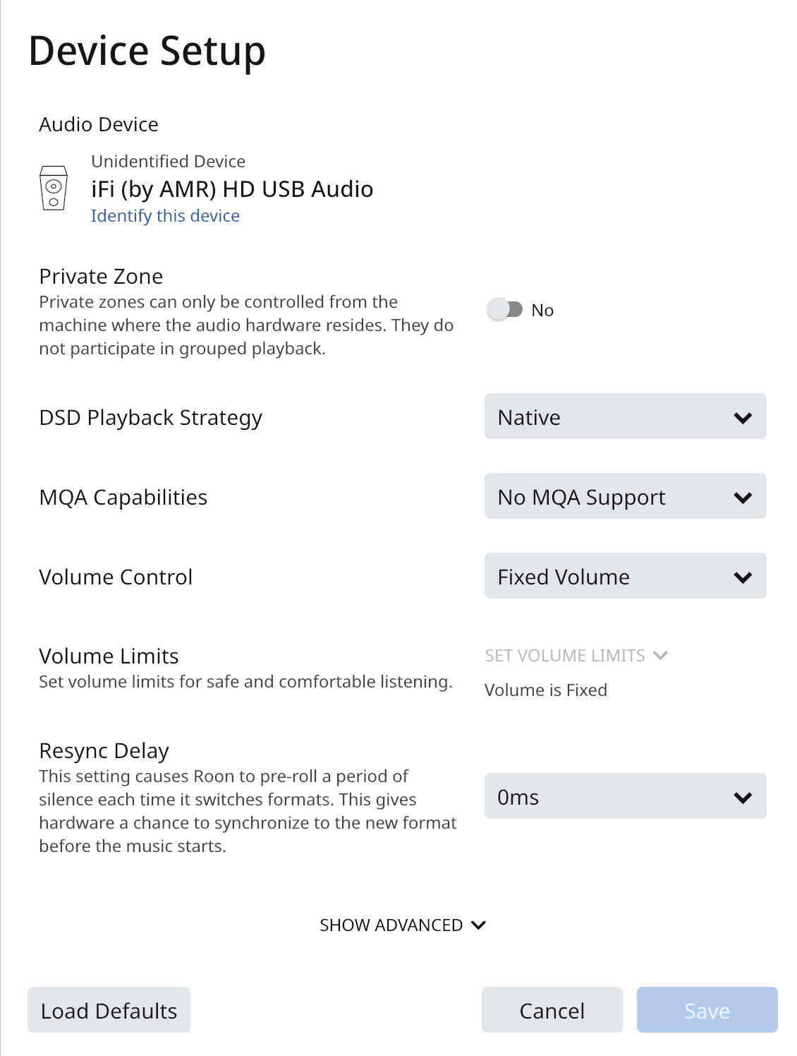

No. I gave MQA support in the top section set to none, not renderer only.
Okay tnx, stuttering is gone
Led on the Zen Dac remains green, not purple anymore, but is the MQA output still there?
Roland if it’s Green then there is no MQA, but it’s better to have good sounding music rather than stuttering music.

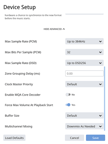

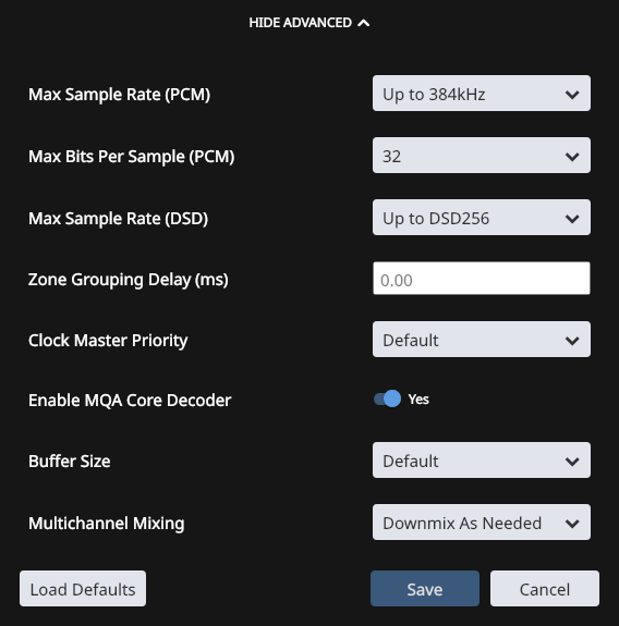

Enable the MQA core decoder. You’ll then get the coveted purple LED.
Roland I am sure I see more in my path (and the purple light). Maybe Roon is unfolding the first part but not getting the second as you have told Roon that it’s not MQA compliant.

For IFi DACs MQA capabilities should be set to Renderer as that is what the Ifi is. Ensure Roons MQA decoder is engaged as this is essential as Roon must perform the first decode stage.

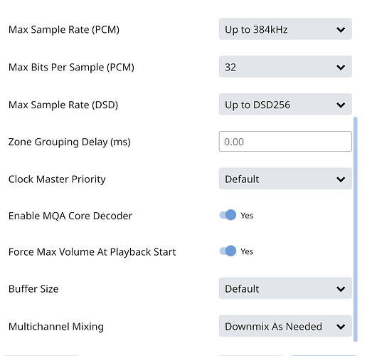

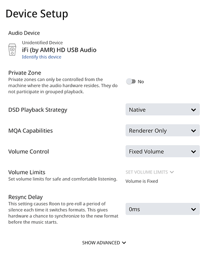

Hi Roland

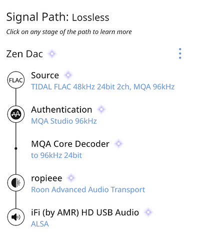

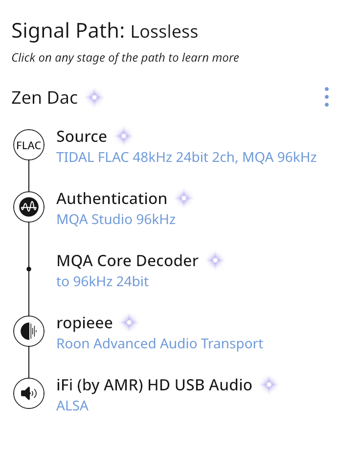

Here is my signal path for my iFi Zen DAC just picking the last MQA album I listened to.
Running into My Hifiman Sundara’s from 4.4mm Pentacon balanced connector, though I have the unbalanced without issue as well without any issue.

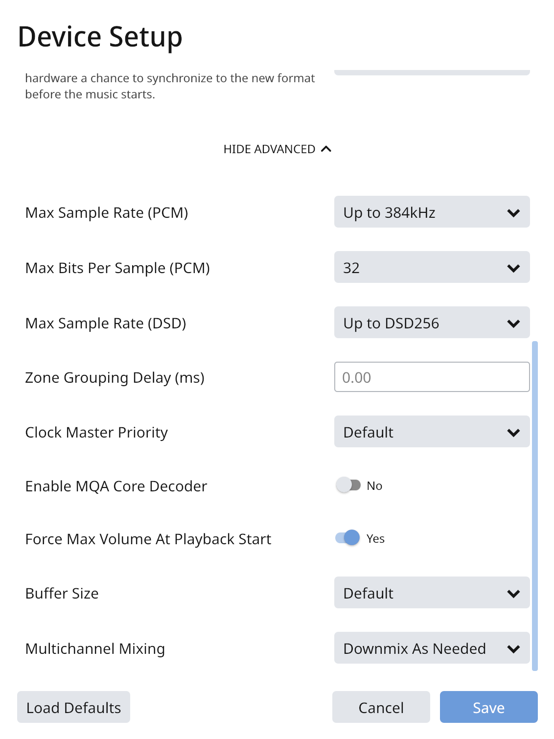

And here is my Device setup
If you want me to test any settings let me know and I will give it a go.
