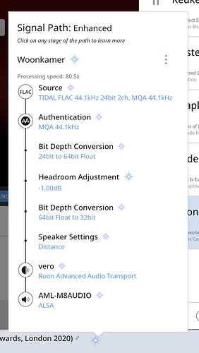

I have three images:
  1. Normal FLAC file, DSP enabled, I see no processing speed.
  2. MQA file, DSP enabled, enable MQA decoder. Stutters and I see processing speeds between 20-30x
  3. MQA file, DSP enabled, disable MQA decoder. No stutters and I see processing speeds between 85-95x
Hi @Tom_den_Heijer,
Thanks for images and extra setup information … the processing speeds all look ok … so something else is going on here.
