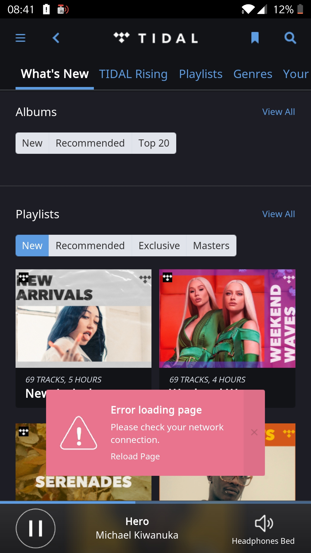

About two weeks ago my system stopped working. I launch Roon and just get a continuous ‘loading screen’ attached. High level trouble shooting:
I can connect to TIDAL (Well in settings I get confirmation of the connection) but cant see content
I try to see my audio/DAC device in ‘Audio Settings’ but can’t see anything?
