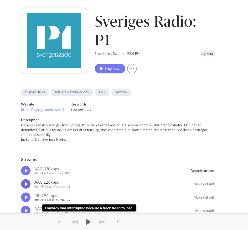

I’m having problems with the Sveriges radios - the new URLs should work, I’ve tested them offline and with Roon’s own tester - and they’re fine…
… but they don’t work in Roon.

As you have noticed, it is possible to link directly to one of the streaming servers edge1 or edge2. For troubleshooting purposes, it is good that you have confirmed that the sound is working, but this is not a good solution in the long run. If Roon links directly to a specific edge server, you will encounter problems every time we take that server out of service to update something. Other edge servers may be added in the future, and any of the servers we have today may be taken out of service, causing your edge link to stop working. However, the links we share on our website should work over time.
Fully agree with that - I always try and use the basic URLs that precede re-direction .
Swedish Radio Technical support also recommend to use http before https. @BrianW, can you please change back to live1 and make sure all links are http. Now there is a mix between https and http.
Hmm, that seems promising with a quick test. Interesting that they prefer that - it’s usually the other way round.
Anyway, let me continue testing…
Ok. P2 seems fine now (although advertised speeds don’t seem to correspond to reality at the moment)
There’s quite a few with the regional P4s, I’ll slowly work through them.

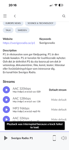

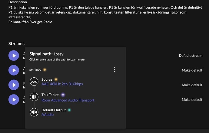

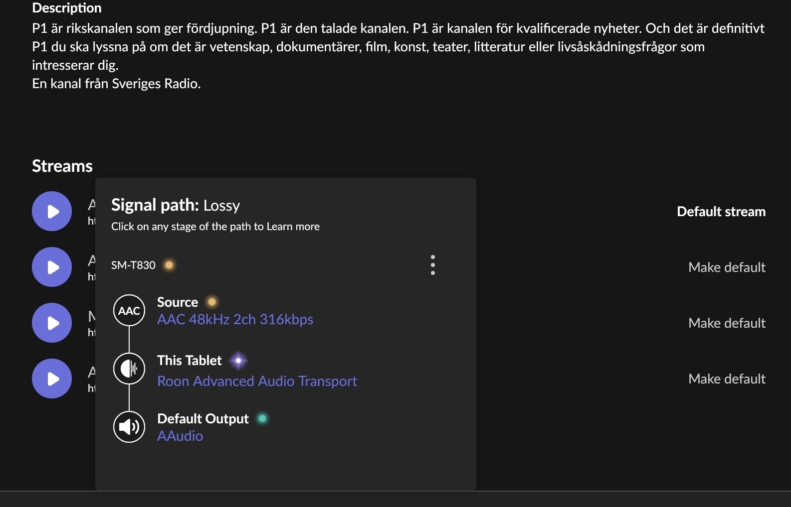

Now the MP3-stream works for me, but not the AAC-stream.
Ok for me ..
Did it work before?

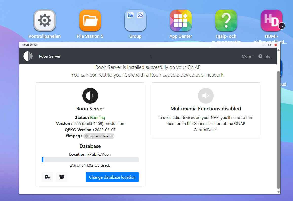

Are you using a NAS?
I do not think it has ever worked, but I have not used Roon to listen to Radio that very much so I cannot say for sure.
Yes, I use a NAS to Run Roon Server:
I tried all of the AAC streams for P1 and none of them worked. The MP3 stream worked fine. Here are some log files that migt be relevant:

10/08 09:05:24 Trace: [internetradio] Channel Player: Fetching URL [http://edge1.sr.se/p1-aac-320]
10/08 09:05:24 Debug: Try making ICY request to http://edge1.sr.se/p1-aac-320
10/08 09:05:24 Trace: [internetradio] Channel Player: Fetching URL [http://edge1.sr.se/p1-aac-128]
10/08 09:05:24 Debug: Try making ICY request to http://edge1.sr.se/p1-aac-128
10/08 09:05:24 Trace: [internetradio] Channel Player: Fetching URL [http://edge1.sr.se/p1-mp3-96]
10/08 09:05:24 Debug: Try making ICY request to http://edge1.sr.se/p1-mp3-96
10/08 09:05:24 Trace: [internetradio] Channel Player: Fetching URL [http://edge1.sr.se/p1-aac-32]
10/08 09:05:24 Trace: Attempting to play channel URL: icy://edge1.sr.se/p1-aac-320
10/08 09:05:24 Info: [SSL 2] [zoneplayer] Playing: channel://icy%3a%2f%2fedge1.sr.se%2fp1-aac-320
10/08 09:05:24 Debug: Try making ICY request to icy://edge1.sr.se/p1-aac-320
10/08 09:05:24 Trace: Got ICY Stream Title [P1 Morgon]

10/08 09:06:03 Info: [zone SSL 2] OnPlayFeedback StoppedEndOfMediaUnnatural
10/08 09:06:03 Debug: Try making ICY request to icy://edge1.sr.se/p1-aac-128
10/08 09:06:03 Info: [zone SSL 2] Canceling Pending Sleep
10/08 09:06:03 Trace: [SSL 2] [Inactive] [STOPPED @ 0:00] Sveriges Radio: P1
10/08 09:06:03 Debug: [easyhttp] [312] POST to https://api.roonlabs.net/internetradio/2/api/reporting/internetradioplayback/events?format=msgpack& returned after 157 ms, status code: 200, request body size: 170 B
10/08 09:06:03 Debug: [easyhttp] [311] POST to https://api.roonlabs.net/internetradio/2/api/reporting/internetradioplayback/events?format=msgpack& returned after 162 ms, status code: 200, request body size: 171 B
10/08 09:06:03 Debug: [easyhttp] [314] POST to https://api.roonlabs.net/internetradio/2/api/reporting/internetradioplayback/plays?format=msgpack& returned after 183 ms, status code: 400
10/08 09:06:03 Debug: [query] Sooloos.Broker.Radio.Channel:1 dirty items, rebuild threshold: 2000, rebuilding? False
10/08 09:06:03 Debug: [easyhttp] [313] POST to https://api.roonlabs.net/internetradio/2/api/reporting/internetradioplayback/plays?format=msgpack& returned after 190 ms, status code: 400
10/08 09:06:03 Trace: Got ICY Stream Title [P1 Morgon]
10/08 09:06:08 Debug: [easyhttp] [315] GET to https://api.roonlabs.net/internetradio/2/api/stations/dc0ef312-ea72-482c-9af2-52c0f12ed66d?format=msgpack& returned after 171 ms, status code: 200, request body size: 0 B
10/08 09:06:08 Trace: [zone SSL 2] Playing Channel
10/08 09:06:08 Info: [library] saved recent ProfileId=a9d27f4d-1913-41e2-a166-851c0f3e9737 Time=10/8/2025 7:06:08 AM DataType=channel Type=play MetadataId=1314 ContentId= LibraryId=1314 Text= Genre=
10/08 09:06:08 Trace: [zone SSL 2] Selecting Source state=Stopped
10/08 09:06:08 Trace: [internetradio] Channel Player: Fetching URL [http://edge1.sr.se/p1-mp3-96]
10/08 09:06:08 Debug: Try making ICY request to http://edge1.sr.se/p1-mp3-96
10/08 09:06:08 Trace: [SSL 2] [Inactive] [LOADING @ 0:00] Sveriges Radio: P1
10/08 09:06:08 Trace: [internetradio] Channel Player: Fetching URL [http://edge1.sr.se/p1-aac-320]
10/08 09:06:08 Debug: Try making ICY request to http://edge1.sr.se/p1-aac-320
10/08 09:06:08 Trace: [internetradio] Channel Player: Fetching URL [http://edge1.sr.se/p1-aac-128]
10/08 09:06:08 Debug: Try making ICY request to http://edge1.sr.se/p1-aac-128
10/08 09:06:08 Trace: [internetradio] Channel Player: Fetching URL [http://edge1.sr.se/p1-aac-32]
10/08 09:06:08 Trace: Attempting to play channel URL: icy://edge1.sr.se/p1-mp3-96
10/08 09:06:08 Info: [SSL 2] [zoneplayer] Playing: channel://icy%3a%2f%2fedge1.sr.se%2fp1-mp3-96
10/08 09:06:08 Debug: Try making ICY request to icy://edge1.sr.se/p1-mp3-96
10/08 09:06:08 Info: [stats] 5376mb Virtual, 839mb Physical, 338mb Managed, 501mb estimated Unmanaged, 386 Handles, 79 Threads
10/08 09:06:09 Trace: Got ICY Stream Title [P1 Morgon]
10/08 09:06:09 Debug: [easyhttp] [310] POST to https://api.roonlabs.net/slurp/2/tastesummary/push?token=3173d2e8-7af5-446f-a6b0-38d48807018c returned after 14603 ms, status code: 200, request body size: 10 KB
10/08 09:06:10 Info: [SSL 2] [zoneplayer]     Open Result (Playing):Result[Status=Success]
10/08 09:06:10 Info: [SSL 2] [zoneplayer] Starting playback
10/08 09:06:10 Trace: [SSL 2] [zoneplayer/raat] StartStream Sooloos.Broker.Transport.RaatZonePlayer+Endpoint: StreamFormat(channels=2, bitspersample=16, samplerate=48000, isdts=False) => StreamFormat(channels=2, bitspersample=16, samplerate=48000, isdts=False) streamid=1676279889
10/08 09:06:10 Trace: [SSL 2 USB Audio Device] [raatclient] SENT [6]{"request":"setup","format":{"sample_type":"pcm","sample_rate":48000,"bits_per_sample":16,"channels":2,"sample_subtype":"none"}}
10/08 09:06:10 Info: [zone SSL 2] OnPlayFeedback Playing
10/08 09:06:10 Trace: [SSL 2] [Inactive] [PLAYING @ 0:00] P1 Morgon
10/08 09:06:10 Trace: [SSL 2 USB Audio Device] [raatclient] GOT [6] {"message":{"signal_path":[{"quality":"lossless","type":"output","method":"wasapi_exclusive"}]},"status":"OutputMessage"}
10/08 09:06:10 Trace: [SSL 2 USB Audio Device] [raatclient] GOT [6] {"audio_port":0,"status":"Success","clock_port":59366,"audio_port_tcp":58035}
10/08 09:06:10 Trace: [SSL 2] [zoneplayer/raat] Endpoint SSL 2 USB Audio Device State Changed: Idle => Prepared
10/08 09:06:10 Debug: [easyhttp] [317] POST to https://api.roonlabs.net/internetradio/2/api/reporting/internetradioplayback/events?format=msgpack& returned after 161 ms, status code: 200, request body size: 172 B
10/08 09:06:10 Debug: [query] Sooloos.Broker.Radio.Channel:1 dirty items, rebuild threshold: 2000, rebuilding? False
10/08 09:06:10 Trace: [SSL 2] [zoneplayer/raat] synced to endpoint SSL 2 USB Audio Device clock: realtime=38006000 rtt=0us offset=-1792132994us delta=-1792132994us
10/08 09:06:10 Trace: [SSL 2 USB Audio Device] [raatclient] SENT [7]{"request":"stream","stream_id":1676279889,"first_seq":-1,"nak_port":-1,"buffer_size":10,"ready_threshold":0.2}
10/08 09:06:10 Trace: [SSL 2 USB Audio Device] [raatclient] GOT [7] {"status":"Buffering"}
10/08 09:06:10 Trace: [SSL 2] [zoneplayer/raat] Endpoint SSL 2 USB Audio Device State Changed: Prepared => Buffering
10/08 09:06:10 Trace: [SSL 2] [zoneplayer/raat] [zoneplayer/raat] selected SSL 2 USB Audio Device as clock master
10/08 09:06:11 Debug: [raat/tcpaudiosource] connecting to 192.168.3.131:58035
10/08 09:06:11 Debug: [raat/tcpaudiosource] connected
10/08 09:06:11 Trace: [SSL 2 USB Audio Device] [raatclient] GOT [7] {"status":"Ready"}
10/08 09:06:11 Trace: [SSL 2] [zoneplayer/raat] Endpoint SSL 2 USB Audio Device State Changed: Buffering => Ready
10/08 09:06:11 Trace: [SSL 2] [zoneplayer/raat] wait for ready in 1ms
10/08 09:06:11 Trace: [SSL 2] [zoneplayer/raat] Adjusting playback start offset from 50ms to 220ms
10/08 09:06:11 Trace: [SSL 2] [zoneplayer/raat] Doing 'ASAP' Start since we are just playing to one device
10/08 09:06:11 Trace: [SSL 2 USB Audio Device] [raatclient] SENT [8]{"request":"start","min_offset":220000000,"stream_sample":0}
10/08 09:06:11 Trace: [SSL 2] [zoneplayer/raat] Endpoint SSL 2 USB Audio Device State Changed: Ready => Playing
10/08 09:06:11 Trace: [SSL 2 USB Audio Device] [raatclient] GOT [7] {"status":"Playing"}
10/08 09:06:11 Trace: [SSL 2 USB Audio Device] [raatclient] GOT [8] {"time":320000000,"status":"Success"}
10/08 09:06:11 Info:
--[ SignalPath ]---------------------------------------------
SignalPath Quality = LowQuality
Elements:
    Source Format=Mp3 48000/16/2  Quality=LowQuality
    Raat Device=SSL 2 USB Audio Device
    Output OutputType=Local_ExclusiveMode_Wasapi Quality=Lossless SubType= Model=SSL 2 USB Audio Device
10/08 09:06:16 Trace: [SSL 2] [LowQuality, 16/48 MP3 => 16/48] [PLAYING @ 0:04] P1 Morgon
10/08 09:06:16 Trace: [zone SSL 2] Stop
10/08 09:06:16 Info: [zone SSL 2] OnPlayFeedback Stopped
10/08 09:06:16 Info: [zone SSL 2] Canceling Pending Sleep
10/08 09:06:16 Trace: [SSL 2] [LowQuality, 16/48 MP3 => 16/48] [STOPPED @ 0:00] P1 Morgon
10/08 09:06:16 Warn: [streammediafile] error reading stream: Unable to read data from the transport connection: Software caused connection abort.
10/08 09:06:16 Info: [audio/env] [zoneplayer -> stream] All streams were disposed
10/08 09:06:16 Info: [audio/env] [zoneplayer] All streams were disposed
10/08 09:06:16 Trace: [SSL 2] [zoneplayer/raat] Endpoint SSL 2 USB Audio Device State Changed: Playing => Prepared
10/08 09:06:16 Trace: [SSL 2 USB Audio Device] [raatclient] SENT [9]{"request":"end_stream"}
10/08 09:06:16 Info: [audio/env] [zoneplayer -> stream -> endpoint] All streams were disposed
10/08 09:06:16 Trace: [SSL 2 USB Audio Device] [raatclient] SENT [10]{"request":"teardown"}
10/08 09:06:16 Trace: [SSL 2] [zoneplayer/raat] Endpoint SSL 2 USB Audio Device State Changed: Prepared => Idle
10/08 09:06:16 Debug: [raat/tcpaudiosource] disconnecting
10/08 09:06:16 Trace: [SSL 2 USB Audio Device] [raatclient] GOT [7] {"status":"Ended"}
10/08 09:06:16 Trace: [SSL 2 USB Audio Device] [raatclient] GOT [9] {"status":"Success"}
10/08 09:06:17 Trace: [SSL 2 USB Audio Device] [raatclient] GOT [6] {"status":"Teardown"}
10/08 09:06:17 Debug: [easyhttp] [318] POST to https://api.roonlabs.net/internetradio/2/api/reporting/internetradioplayback/events?format=msgpack& returned after 160 ms, status code: 200, request body size: 171 B
10/08 09:06:17 Info: sleep 200ms after flush
10/08 09:06:17 Debug: [easyhttp] [319] POST to https://api.roonlabs.net/internetradio/2/api/reporting/internetradioplayback/plays?format=msgpack& returned after 158 ms, status code: 200, request body size: 174 B
10/08 09:06:17 Debug: [query] Sooloos.Broker.Radio.Channel:1 dirty items, rebuild threshold: 2000, rebuilding? False
10/08 09:06:18 Warn: [zoneplayer] Remote Load Failure While Opening Sound: icy://edge1.sr.se/p1-aac-128: Icy: timed out while starting stream
10/08 09:06:18 Warn: [streammediafile] error reading stream: Unable to read data from the transport connection: Software caused connection abort.
10/08 09:06:18 Info: [SSL 2] [zoneplayer]     Open Result (Playing):Result[Status=MediaTooSlow]
10/08 09:06:19 Debug: [easyhttp] [320] GET to https://api.roonlabs.net/internetradio/2/api/stations/dc0ef312-ea72-482c-9af2-52c0f12ed66d?format=msgpack& returned after 153 ms, status code: 200, request body size: 0 B
10/08 09:06:19 Trace: [zone SSL 2] Playing Channel
10/08 09:06:19 Trace: [zone SSL 2] Selecting Source state=Stopped
10/08 09:06:19 Info: [library] saved recent ProfileId=a9d27f4d-1913-41e2-a166-851c0f3e9737 Time=10/8/2025 7:06:19 AM DataType=channel Type=play MetadataId=1314 ContentId= LibraryId=1314 Text= Genre=
10/08 09:06:19 Trace: [internetradio] Channel Player: Fetching URL [http://edge1.sr.se/p1-aac-32]
10/08 09:06:19 Debug: Try making ICY request to http://edge1.sr.se/p1-aac-32
10/08 09:06:19 Trace: [SSL 2] [LowQuality, 16/48 MP3 => 16/48] [LOADING @ 0:00] Sveriges Radio: P1
10/08 09:06:19 Trace: [internetradio] Channel Player: Fetching URL [http://edge1.sr.se/p1-aac-320]
10/08 09:06:19 Debug: Try making ICY request to http://edge1.sr.se/p1-aac-320
10/08 09:06:19 Trace: [internetradio] Channel Player: Fetching URL [http://edge1.sr.se/p1-aac-128]
10/08 09:06:19 Debug: Try making ICY request to http://edge1.sr.se/p1-aac-128
10/08 09:06:19 Trace: [internetradio] Channel Player: Fetching URL [http://edge1.sr.se/p1-mp3-96]
10/08 09:06:19 Debug: Try making ICY request to http://edge1.sr.se/p1-mp3-96
10/08 09:06:19 Trace: Attempting to play channel URL: icy://edge1.sr.se/p1-aac-32
10/08 09:06:19 Info: [SSL 2] [zoneplayer] Playing: channel://icy%3a%2f%2fedge1.sr.se%2fp1-aac-32
10/08 09:06:19 Debug: Try making ICY request to icy://edge1.sr.se/p1-aac-32
10/08 09:06:20 Trace: Got ICY Stream Title [P1 Morgon]
10/08 09:06:23 Info: [stats] 5410mb Virtual, 842mb Physical, 348mb Managed, 494mb estimated Unmanaged, 383 Handles, 83 Threads
10/08 09:06:29 Trace: [SSL 2] [LowQuality, 16/48 MP3 => 16/48] [LOADING @ 0:00] Sveriges Radio: P1
10/08 09:06:31 Trace: [zone SSL 2] Stop
10/08 09:06:31 Info: [zone SSL 2] OnPlayFeedback Stopped
10/08 09:06:31 Info: [zone SSL 2] Canceling Pending Sleep
10/08 09:06:31 Trace: [SSL 2] [LowQuality, 16/48 MP3 => 16/48] [STOPPED @ 0:00] Sveriges Radio: P1
10/08 09:06:32 Debug: [easyhttp] [321] POST to https://api.roonlabs.net/internetradio/2/api/reporting/internetradioplayback/events?format=msgpack& returned after 160 ms, status code: 200, request body size: 170 B
10/08 09:06:32 Debug: [easyhttp] [322] POST to https://api.roonlabs.net/internetradio/2/api/reporting/internetradioplayback/plays?format=msgpack& returned after 159 ms, status code: 400
10/08 09:06:32 Debug: [query] Sooloos.Broker.Radio.Channel:1 dirty items, rebuild threshold: 2000, rebuilding? False
10/08 09:06:34 Debug: [easyhttp] [323] POST to https://api.roonlabs.net/device-map/1/register returned after 279 ms, status code: 200, request body size: 7 KB
10/08 09:06:34 Trace: [devicemap] device map updated
10/08 09:06:34 Warn: [zoneplayer] Remote Load Failure While Opening Sound: icy://edge1.sr.se/p1-aac-32: Icy: timed out while starting stream
10/08 09:06:34 Warn: [streammediafile] error reading stream: Unable to read data from the transport connection: Software caused connection abort.
10/08 09:06:34 Info: [SSL 2] [zoneplayer]     Open Result (Playing):Result[Status=MediaTooSlow]
10/08 09:06:38 Info: [stats] 5354mb Virtual, 842mb Physical, 319mb Managed, 523mb estimated Unmanaged, 380 Handles, 77 Threads
10/08 09:06:53 Info: [stats] 5338mb Virtual, 841mb Physical, 322mb Managed, 519mb estimated Unmanaged, 380 Handles, 72 Threads
You need to load aac codecs for your QNAP - they are no longer included with the system.
See this for how to add them.
Thanks @BrianW, with the new AAC codec it works fine. But it might be a good idea to switch back to the live1 URLs since that is what Sveriges Radio recomend.
